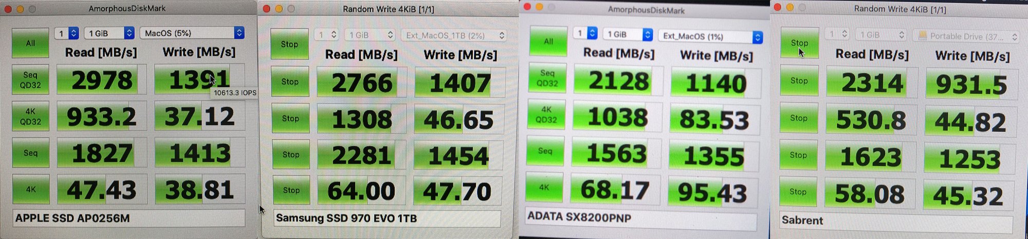

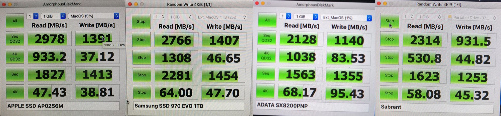

Unfortunately, the Adata drive didn't work out. The drive failed, kept overheating and crashing the system. Ended up getting the Samsung 970 Evo 1TB for £120 at Amazon... seemed a good deal.
System setup.
Ssd Drive - ADATA 2TB XPG SX8200 Pro PCIe Gen3x4 M.2 2280 - FAILED
Samsung 970 EVO 1 TB V-NAND M.2 - MZ-V7E1T0BW
Adapter - EZDIY-FAB PCI Express M.2 SSD NGFF PCIe Card to PCIe 3.0 x 4 Adapter
Enclosure - Sonnet Echo Express SEL - Thunderbolt 3 Edition
For reference, I've attached the disk speed tests using the Adata drive, a Sabrent Rocket 1tb, Samsung 970 Evo and the Apple internal 256gb drive. All drives (apart from apple of course) are in the Sonnet Echo Express SEL.
The Samsung 970 Evo is giving more or less the same boot up times as the internal Apple drive. The Adata drive was noticeably slower but I don't know if that was down to the fault/issues with that drive.
