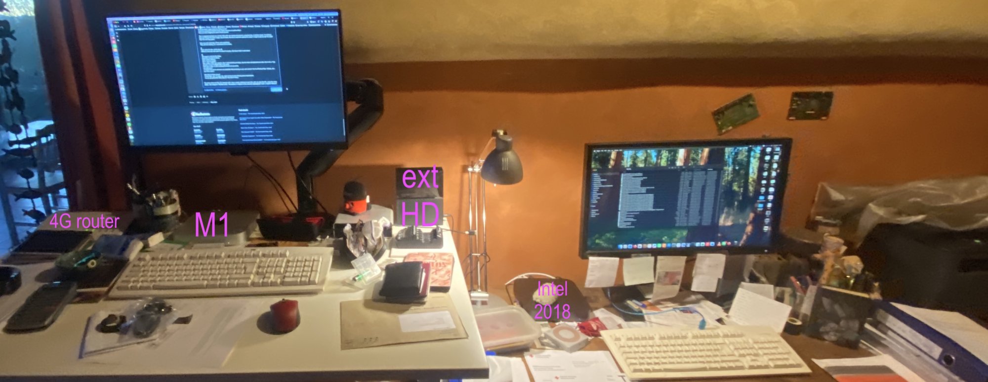

The same (two) ext HDs (for backups only, once a week) continue to work fine with my mac Mini M1, using the same cables, also using the TB/USB-C ports. The position in relation to the (shared) wifi/ethernet router is slightly different, which may or may not play a role (according to the above link on shielding issues).
The WD My Book 4TB is 4yr old (but only used once a week for backups), the WD Elements Desktop 4TB is 5yr old (same usage). I need these sizes as it holds backups of the two mac Mini's and a 2GB external HD data disk (photos and music), so SSDs a bit expensive for 'just' weekly backups, no?
The fact that things work fine with the same USB-C to micro USB-B cable VIA the USB2.0 keyboard to the USB-A ports of the Mac Mini, with our without Bluetooth on, implies there's an issue with the TB/USB-C ports (and not with, e.g., the ext HD power supplies - who are on the floor)
The fact that using these cables directly into the TB/USB-C ports with Bluetooth OFF, but not with Bluetooth ON, implies there's a Bluetooth interference with the RB/USB-C ports.
Why with the Intel 2018 MM and not with the M1 MM - maybe the position of the ext HD in relation to the MM and the 4G router? 🤷‍♂️
Why NOW, after 7 years for the MM 2018 and 4-5 years for the ext backup HDs? 🤷‍♂️🤷‍♂️
