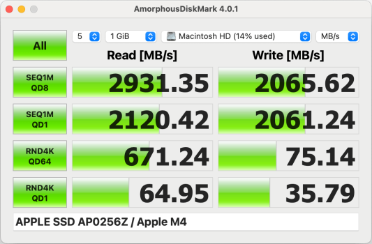

Are there lighter and perhaps smaller, reliable external SSD that is faster than the internal SSD of the M4 Mini? An alternative is if I am going to upgrade the machine in 2-3 years, perhaps just get a Thunderbolt 5 enclosure now even I cannot enjoy the high speed with the Mini M4?
