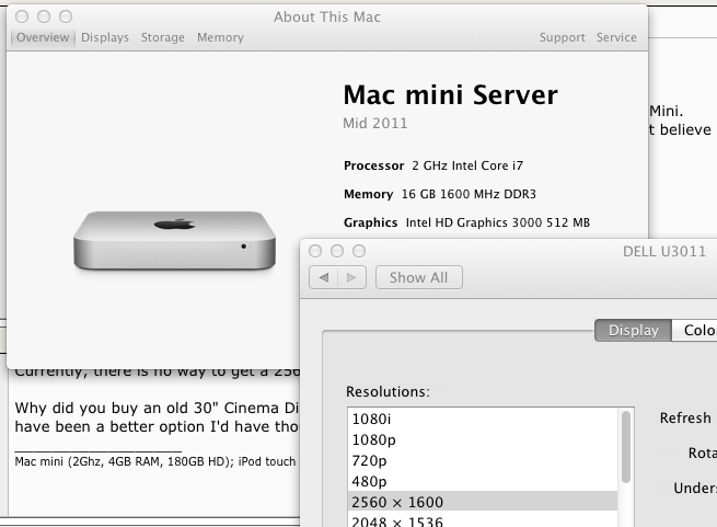

See attached, using Mini DisplayPort to DisplayPort.
Indeed. As the other posters have noted, the TB port on the mini is capable of displaying up to 2560x1600, which is the 30" ACD's resolution. The HDMI port on the mini can display up to 1920x1200, which is great for a 24" 16:10 monitor.
