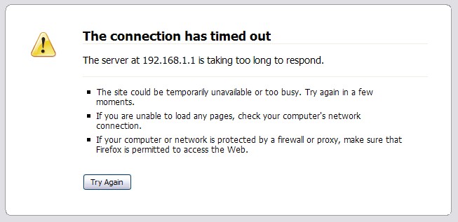

And a big thanks to you, too. As it turned out, there were some matters which needed attending to, and the same which prevented me from having a workout with my little Mac Mini's Airport thingy. I did, however, try what you suggested - but could not even get past first base. Each of the numerous times that I tried, I kept getting the following message:
http://att.macrumors.com/attachment.php?attachmentid=66540&stc=1&d=1169276246
I have to go out of town, later today, and won't get a chance to get back to it until (maybe) Sunday evening. But I appreciate your efforts.

OK...here's what's happening now: everytime that I type in my router's address (192.168.1.1) I get a "Bad Request" message.
late last night I happened across a site where someone posted a very similar concern. One of the responders advised that party to make sure that the router's address wasn't being used as his computer's ID (or something to that effect).
Now, when I was given that 192.168.1.1 address (here, at this forum) I wondered why that number looked somewhat familiar. Then it came to me. A little while back I had been experiencing a host of problems with our Adelphia (now Time Warner) broadband cable service, and a technician (via telephone) walked me through some settings to correct that one particular problem. The above numerical address was what he had asked me to input.
So, do you think that this might be the meat of my problems?
This is basically a universial IP address. It's used in trouble shooting alot.
I dont think it is causieng your problem
Thanks Cassie. In a way, I wish that it had been the causative factor - because now I am back to square one with this mess 🙂 .
