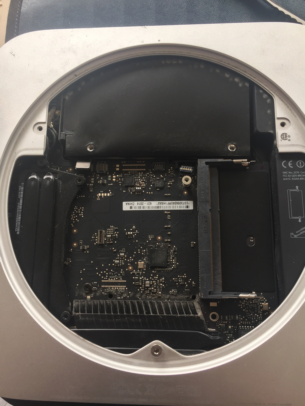

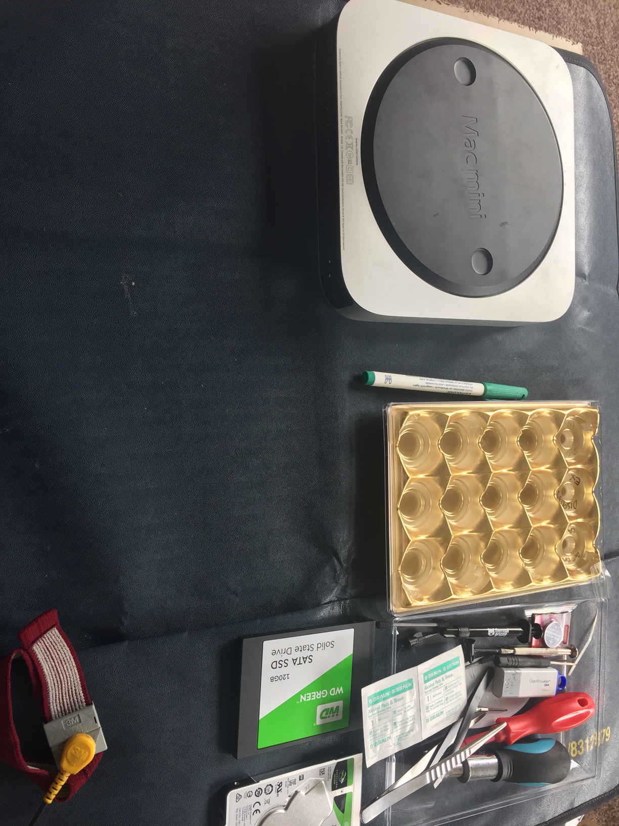

So I’ve went from the above to a full strip and refurb. 1TB Seagate barracuda 7200rpm HDD 7mm 2.5” HDD and 120GB WD green SSD for making a fusion drive, new PRAM battery, ifixit Mac mini dual drive kit, and some new thermal paste ordered.

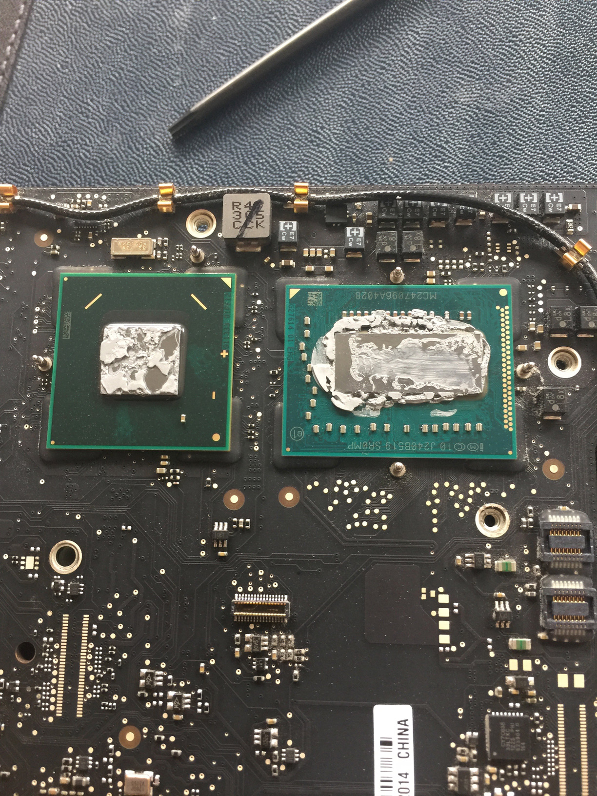

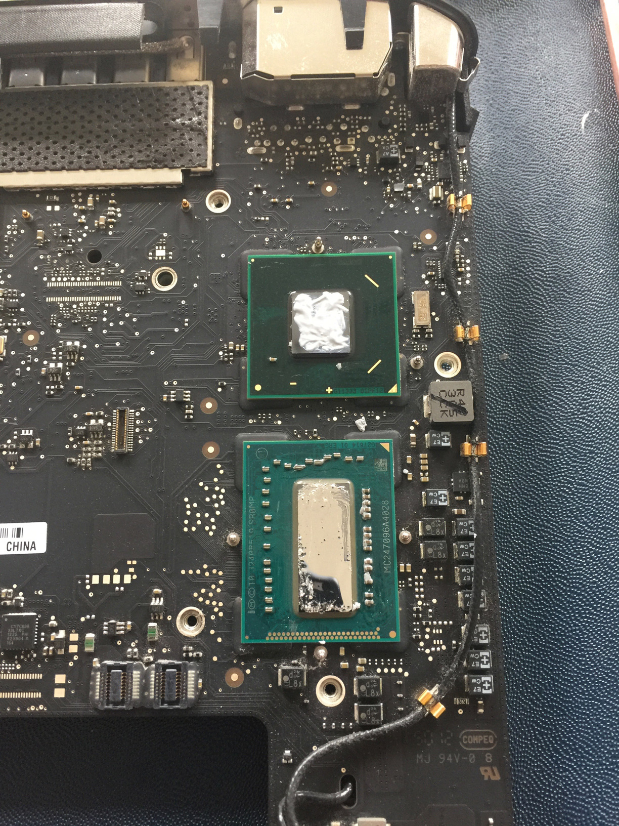

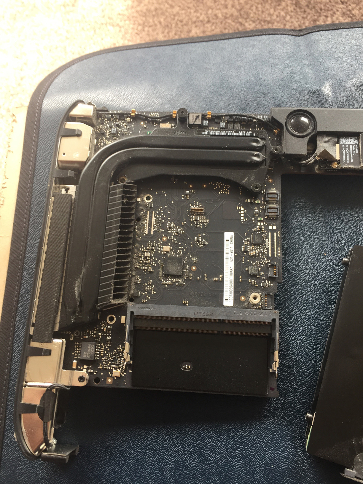

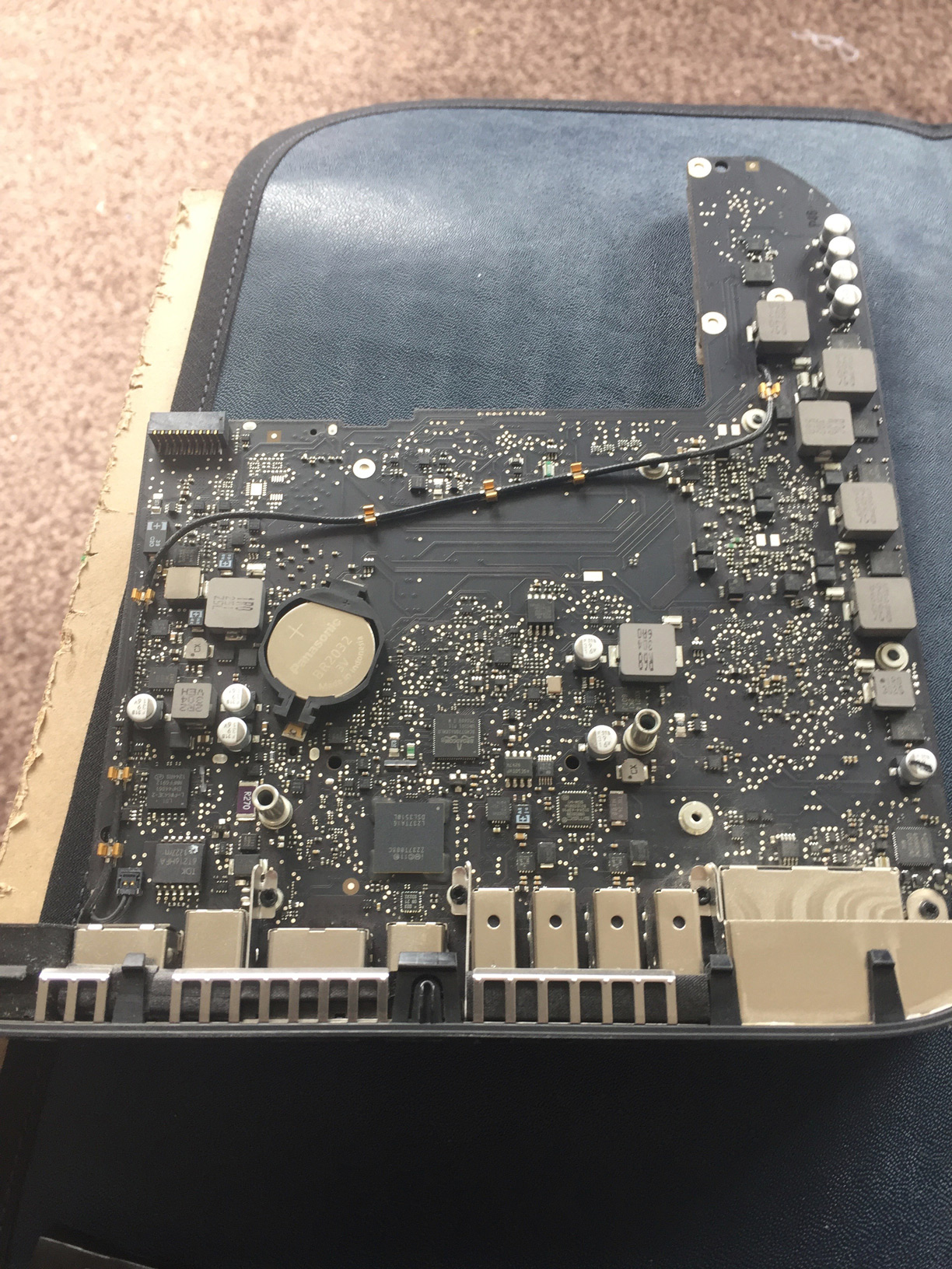

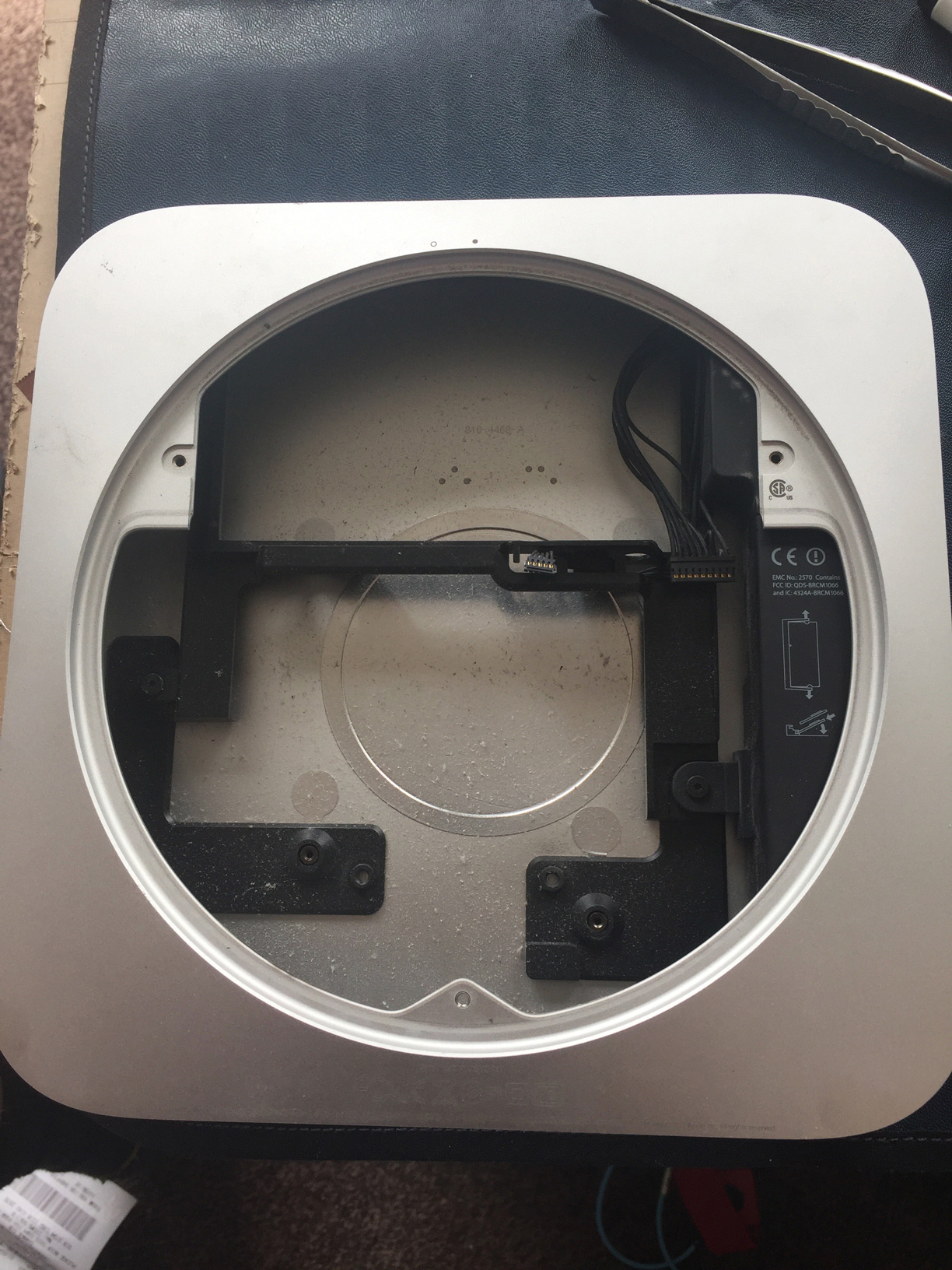

Well... the upgrades are done. hardware wise, not too difficult a job. I replaced the PRAM battery, fitted a WD Green 120GB SSD and a seagate barracuda 7200rpm HDD using a dual drive kit from ifixit, gave it a good clean with an air duster, removed the rock like stock thermal paste. i only used the liquid metal on the i7, as it had a copper contact plate on the heat sync, the platform controller had an aluminium contact plate so i used Kryonaut paste for that.

[doublepost=1529472724][/doublepost]i put sone clear nail varnish over the resisters on the CPU to protect against overspill.

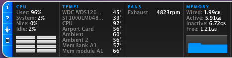

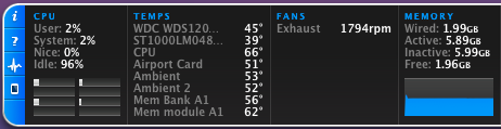

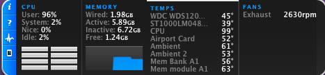

the liquid metal is definitely doing its job, it’s now hitting full boost speed and staying there at a lower temperature and lower fan speed. Fusion drive gives a noticeable bump to performance as well. Full boost maintained at 95c (fan at 90% cpu usage 100%) idle 63c (fan inaudible usage 4-8%) well within spec for that chip. Previously at 100% chip was at 105c where it would start throttling with fan at 100% i think overall power consumption has dropped but i can't remember what it was before All in all a good improvement
full load with handbrake after about 5 mins

full load with handbrake for first 5 mins until heat saturation of heat sync
about 1 min after i stopped handbrake encode
