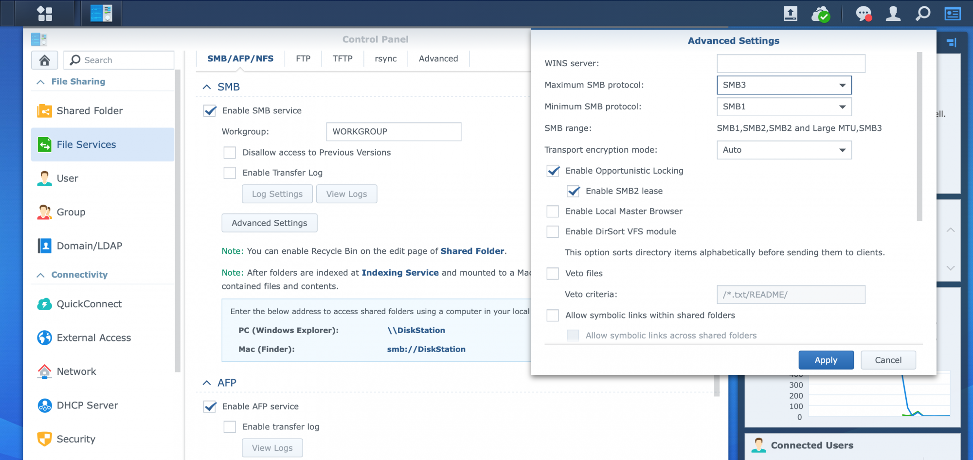

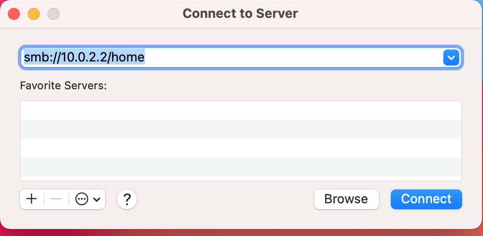

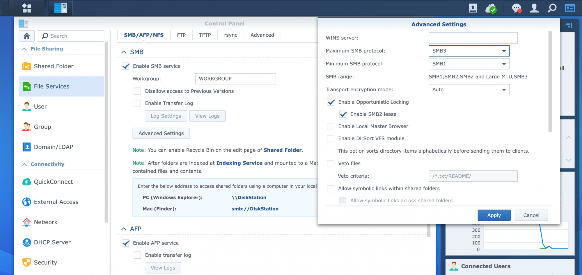

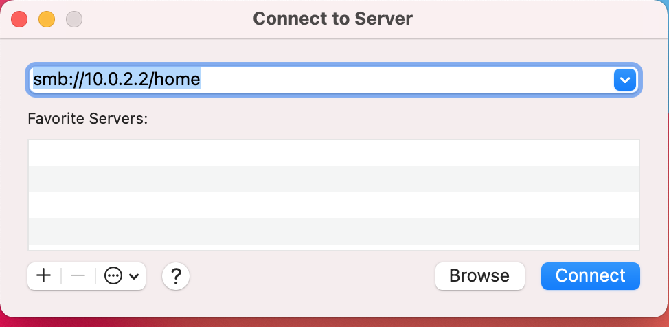

Ensure you have these settings in your NAS and you use smb:// when connecting the NAS.

That worked. When connected the other way, any file that I'd open, say a PDF via Preview, then edit it, then try to save it Preview would have the spinning beach ball, then after a while a message pops up saying that it can't save it and to discard it.
Then I tried your SMB method. Now it shows up as "192.168.1.74" in the list of attached or connected drives. But I can now open PDFs in Preview, edit them and then save them.
