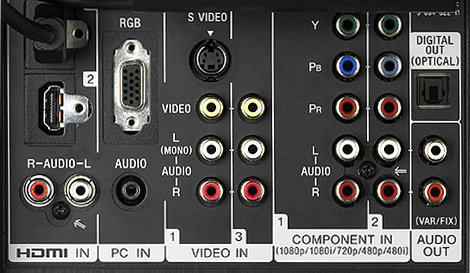

The back of the TV should have sections labelled with their respective inputs. Like HDMI1, HDMI2, RGB, Component etc. Each section has a box so you know which plugs correspond to that input.
For example, this Bravia (found via google image) has these sections labelled. Below the 'HDMI in' there is the red/white audio input, thats where you should be plugging in your audio in.

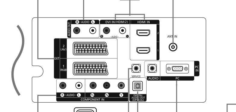

These are my ports. I've been connecting to hdmi 1 and 2, and tried putting the audio jack into "Audio" and "service" neither works.
Any ideas?
Thanks

Based on this diagram, i think you need to use HDMI #2 and sound through the RCA jacks marked "DVI IN (HDMI2)". The Audio jack goes with the PC IN.
