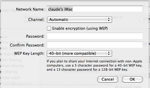

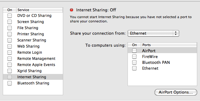

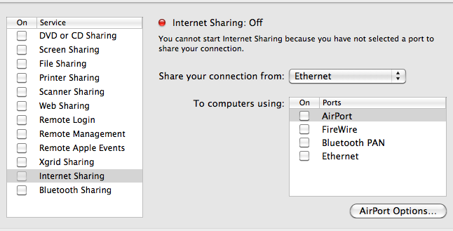

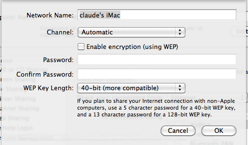

It looks like you can have ethernet and wifi turned on at the same time.
Here's how to do it. But like Dave said you're going to not have that hardware based firewall. It might be better just to get a airport extreme base station.

As long as the mini is receiving it's internet from somewhere other than the airport (I don't think you can receive from the airport and share to the airport at the same time), just click on the airport menu bar icon and hit "create network".
After you've created whatever sort of network you want (name, channel, security), go to system preferences and then sharing. Turn on internet sharing (choosing where the internet is coming into the mac and what port the mac should share to).
