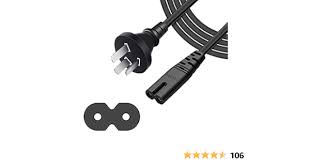

I do not have grounding, I am from the EU, Austria.
Yes you do… 🙄 Note: All Australian power points must be earthed to comply with the Australian Standards.

Another thing you can try immediately is to reverse your power cord in the outlet. That is, remove it, turn 180 degrees, and reinsert, if possible.
Or reverse it where it connects to the back of the mini, so yes, that's possible, even if someone's mini had a polarized plug. Edit: Oh wait, is there a different cord connector type on the back of mini in the OP's region?
Pretty sure the Minis are universal except for the included power cord.
