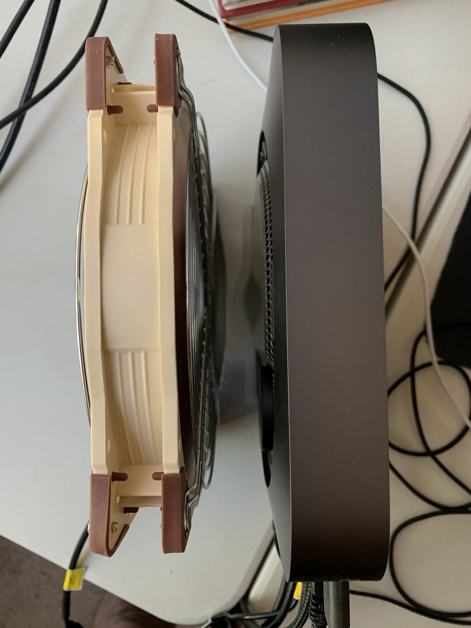

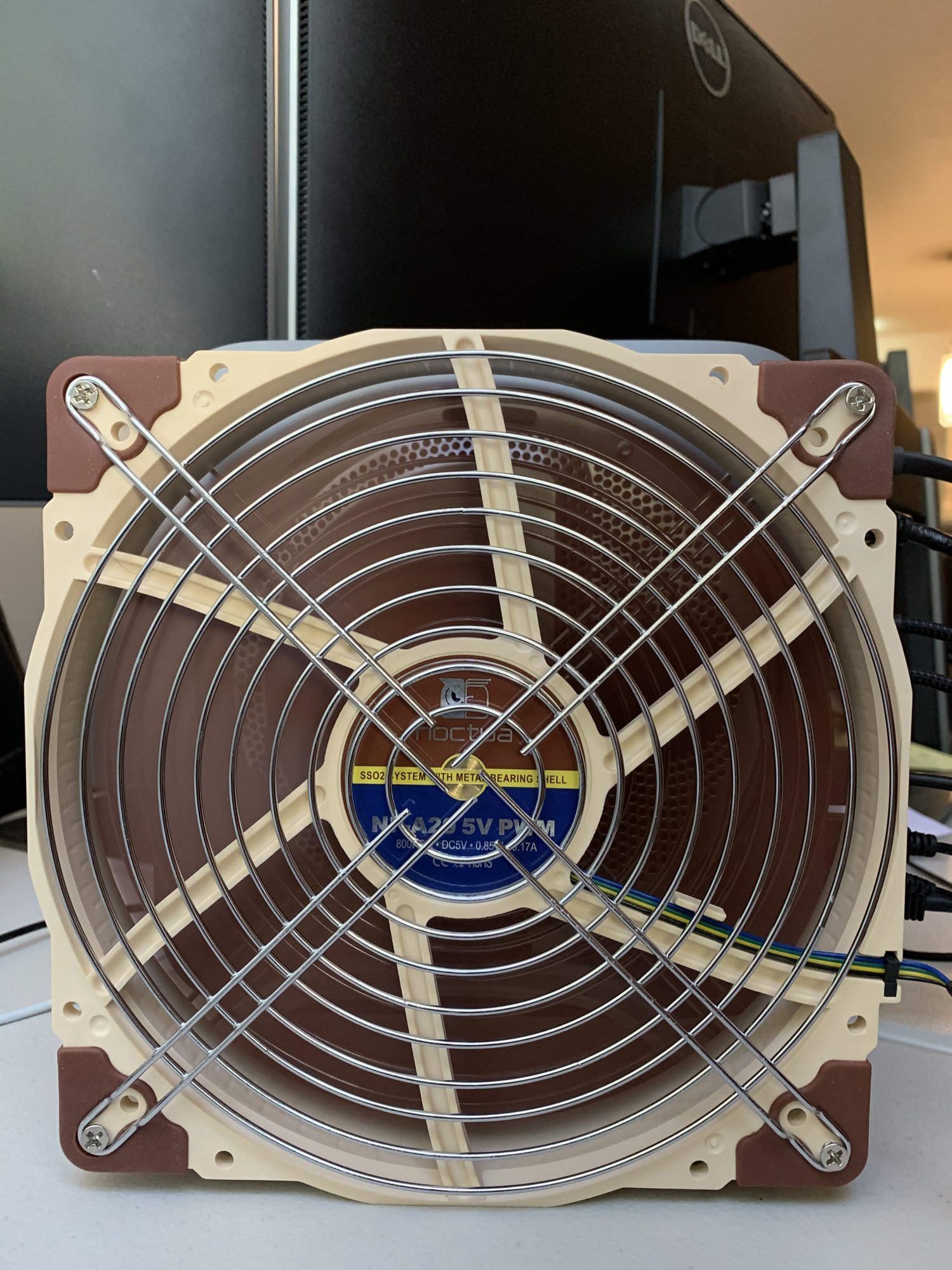

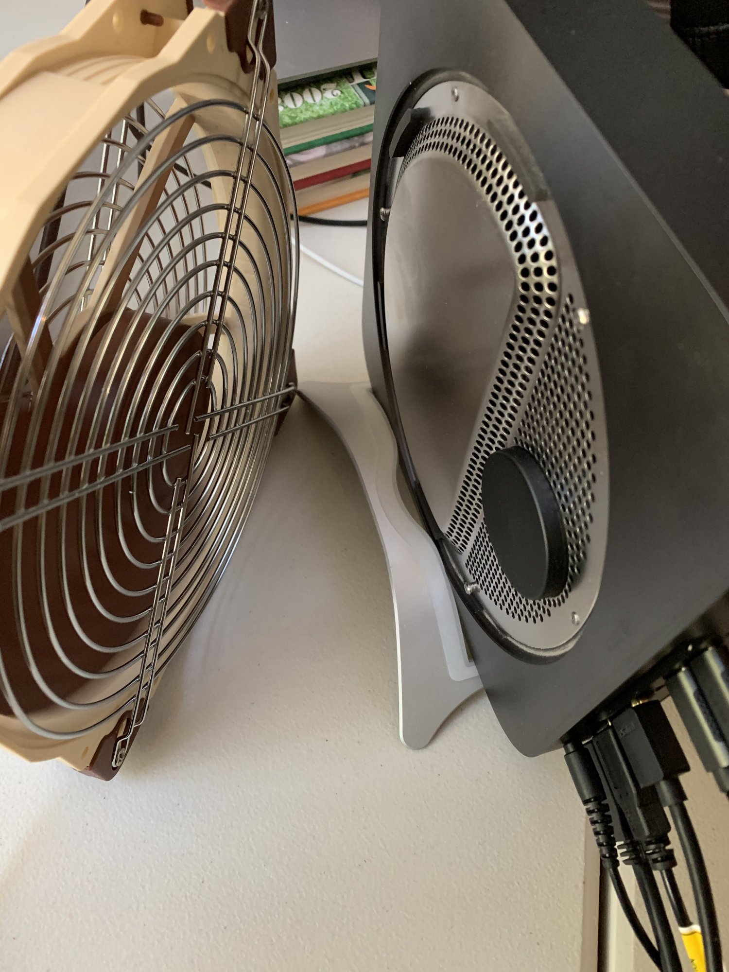

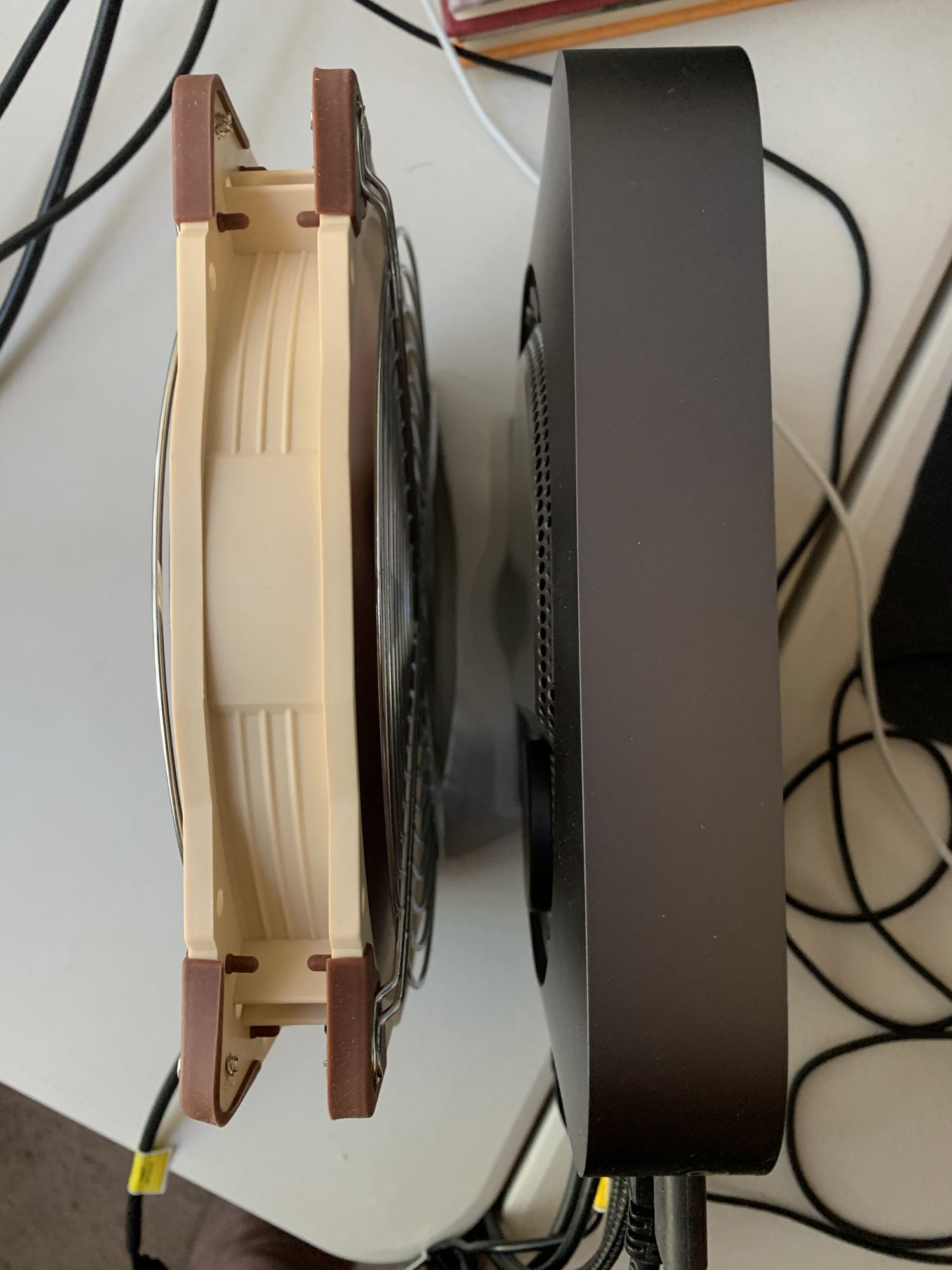

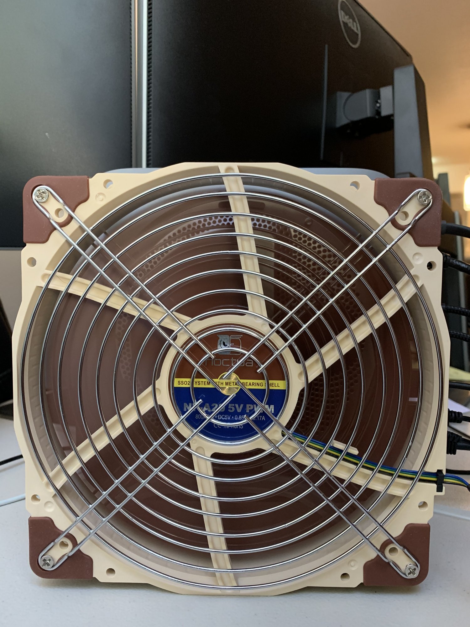

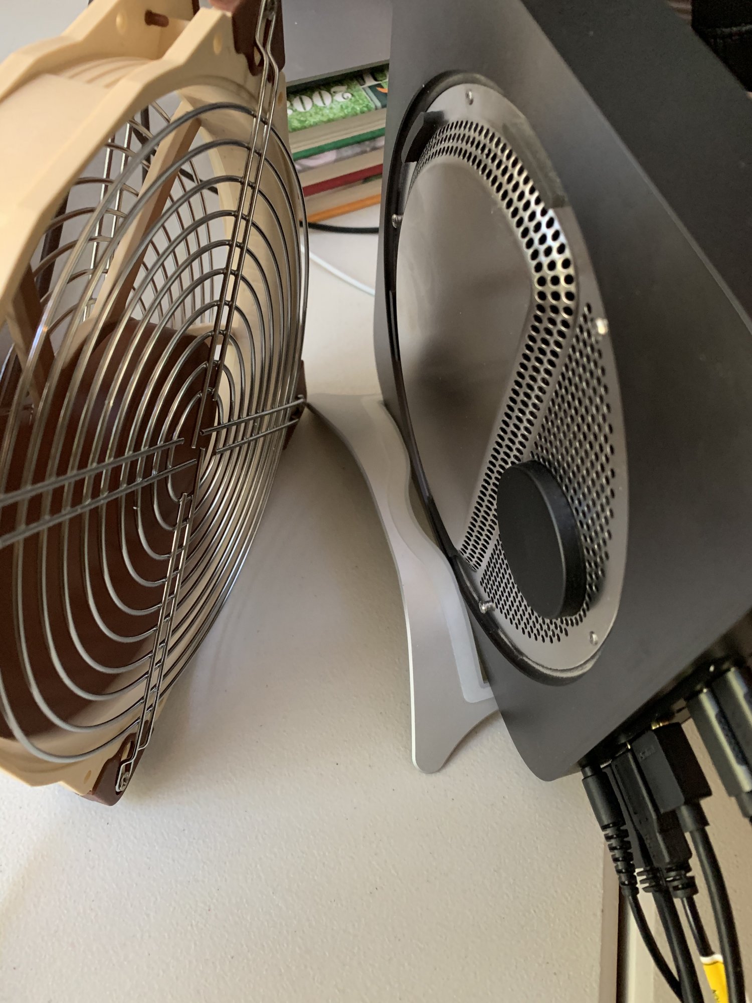

The sharp design of the Speed Mac mini cooling base with the solid aluminum heat sink & fan seems to the best all around solution. I want to try it out! As a temporary solution I followed another post and removed the black cover and have a $30 Noctua 400mm fan blowing on the Mac mini which is functional.
