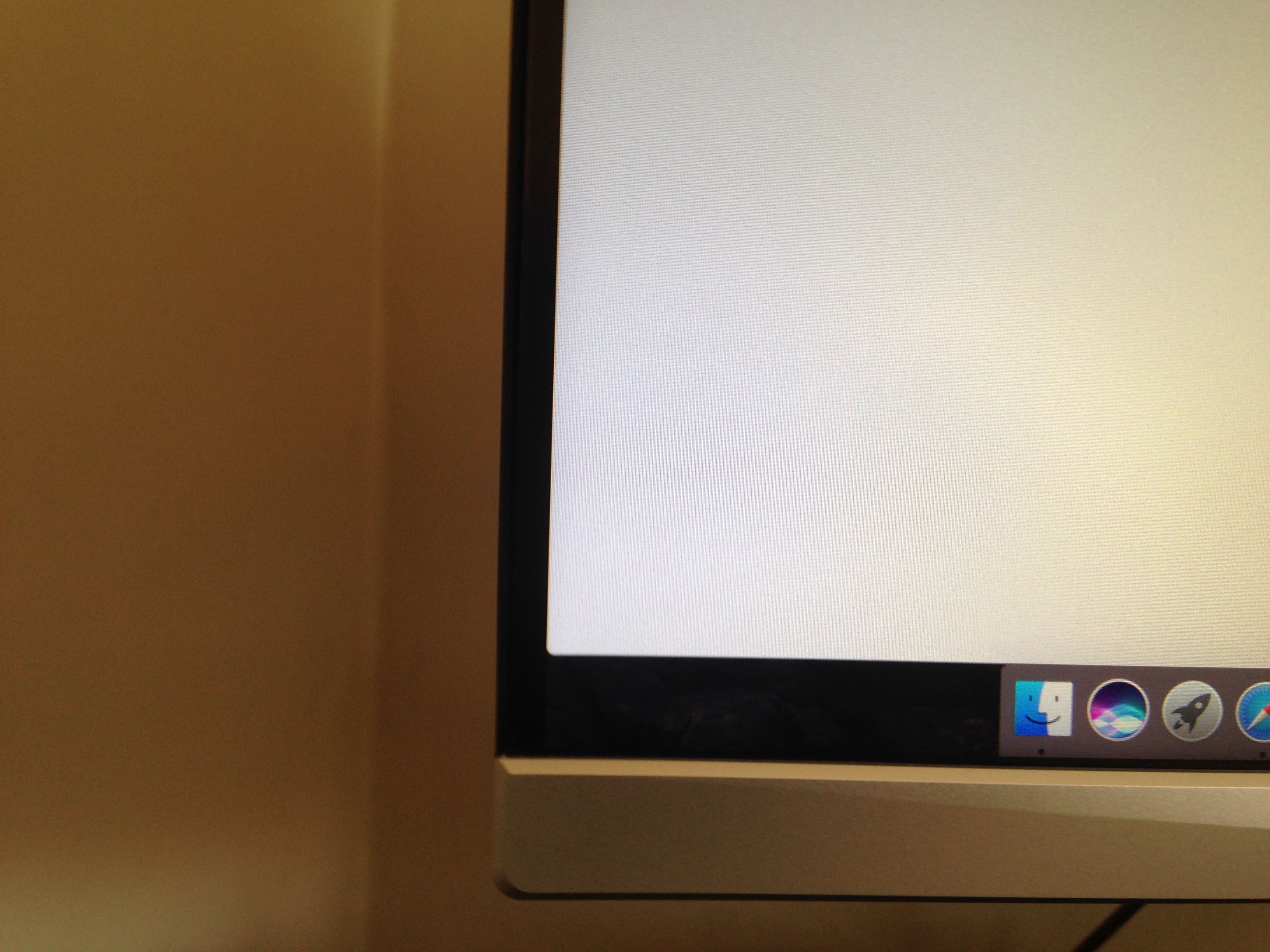

turned on my mac mini today noticed a half in ch black border on the right hand side and at the top can't figure out how to make the desktop fit the screen any idea's please ?.
[doublepost=1490632776][/doublepost]monitor is acer g277hu
the dock sits at the bottom of the screen no border yet the two sides and top theres is a 5mm black border anyone know how i can stretch this out to the edge of the monitor please ?. or is this normal and I've only just noticed ?.

If I compare to on-line pix of your monitor, the sides appear pretty close to the edge of the active display area. The bottom does not... Your dock sits within the black area at the bottom of the screen (why does your dock show off the screen? - or is that part of the background image, so dock is normally within that black part of the image? (?) )
Can you move the cursor to the bottom edge of the screen (into the black area next to the dock?)

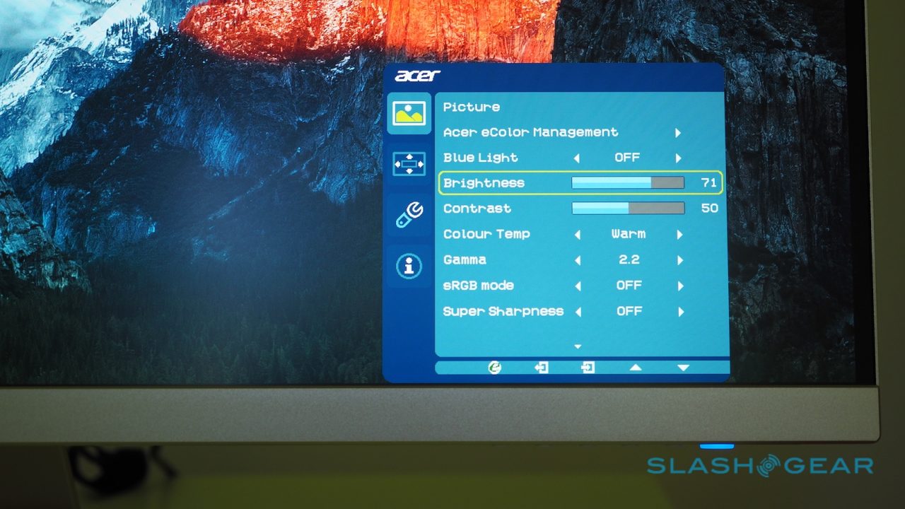

EDIT: I've stumbled across a SlashGear review of the h277hu (which seems similar to the g277hu), and they also show the black border on their machine. 🙁 I think it may be built-in to the monitor. Here's a picture with the border:
https://www.slashgear.com/acer-h277hu-usb-c-monitor-review-your-macbooks-best-friend-27441953/
Yes, marketing for that display uses the term "zero-frame".
So, the hard bezel - that frame or enclosure that wraps around edge of most other displays - does not exist.
However, the active area of the display does not extend to the hardware edge.
Nothing wrong with the display, but it simply is not an edge-to-edge display, despite Acer's marketing, which makes it seem more than it might appear in real life...

i can move the cursor into the area next to the dock both sides right unto the 5mm back area on left and right hands of the screen
Good...
Your background that you choose to use is a little odd, but that's a personal choice, I suppose - like using a picture of a your cat... 😀
So, your display appears to be working properly: you don't get full use of the possible space, because the display is not designed to do that. It's nothing that you can fix, other than replacing that display with one that is truly "edge-to-edge"
