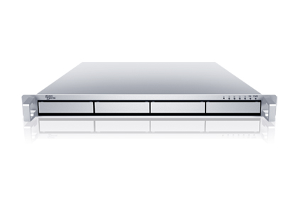

JLandis - There are plenty of 4-bay enclosures, but they are almost all NAS, USB2, or eSATA from what I've seen. Neither of which is ideal. That's why I would suggest two dual-bay FW800 enclosures.
This is the only one I could find... but it's a rack-mount enclosure... which is guaranteed to be noisy.
http://www.sansdigital.com/elitestor/es104ub.html
As I said above, getting a NAS when you have a Mini is overkill... you are duplicating functionality unnecessarily.
