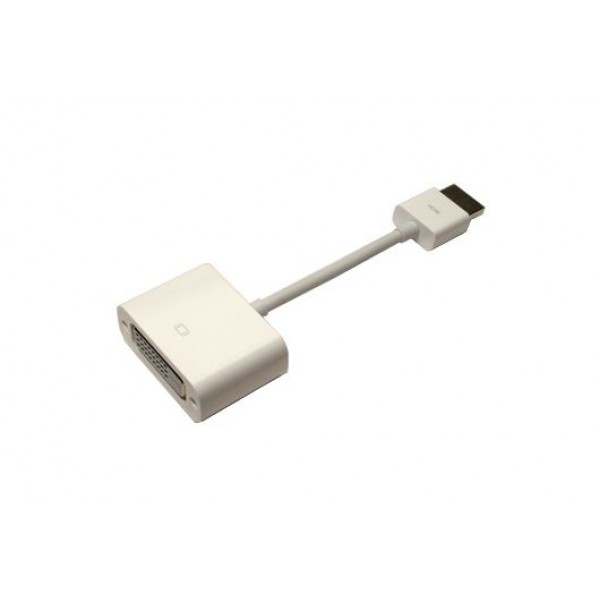

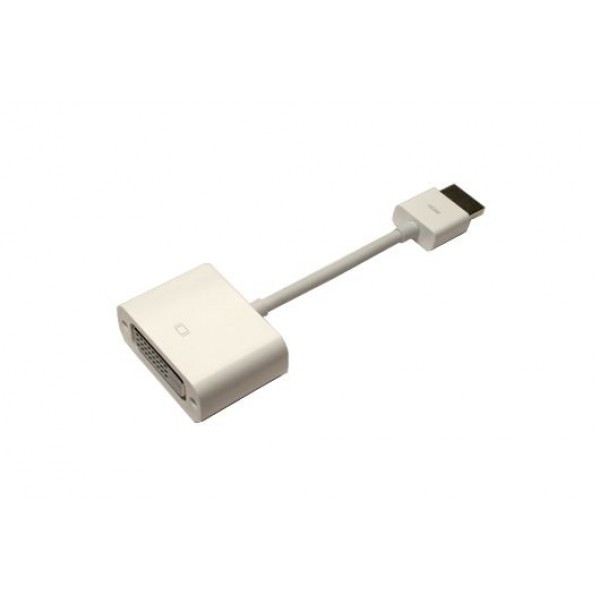

The Mac should have come with an HDMI-DVI adapter, looks like the attached. You'll need a DVI to DVI cable.
