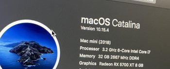

Hello i have a 2018 i7 mac mini with 32 gb ram. I purchased an EGPU Razer chroma x along with amd sapphire 5700XT NITRO. I just connected it to the mac mini it shows its connected on the the top right. But under system info its showing the internal HD graphics right now i have the display connected to the mac mini not the egpu would this make the difference i dont think so? Anyone have any info on this??
My setup: Mini with a short TB3 cable to the eGPU and Display Port cable to the monitor. This is where I would start.
It can be a little hit or miss with the Mini and eGPU full compatibility.
I'm also using an HDMI cable from the Mini to a second monitor (TV) for a boot screen. Gotta love Apple >10.15.4
All working well now.
Ok i was able to figure it out i need to connect all displays that i want to use run the card with to the EGPU card it works amazing.

What games have you guys tried on your EGPU??? i may try witcher 2 today and see how it runs. I went with the 5700 XT its one of the newest and one of the best AMD gpu catalina supports.
Hey I’m running it on Catalina 10.15.4 same as you what egpu and gpu are you using?
RX 5700 XT via a Razer Core X, Mac mini 2018, i7@3.2GHz, 32GB; so same as you?
I have 3 external monitors, all over eGPU (2x DP, 1x HDMI). You now have no issues at all? Do you see the Apple logo at startup?

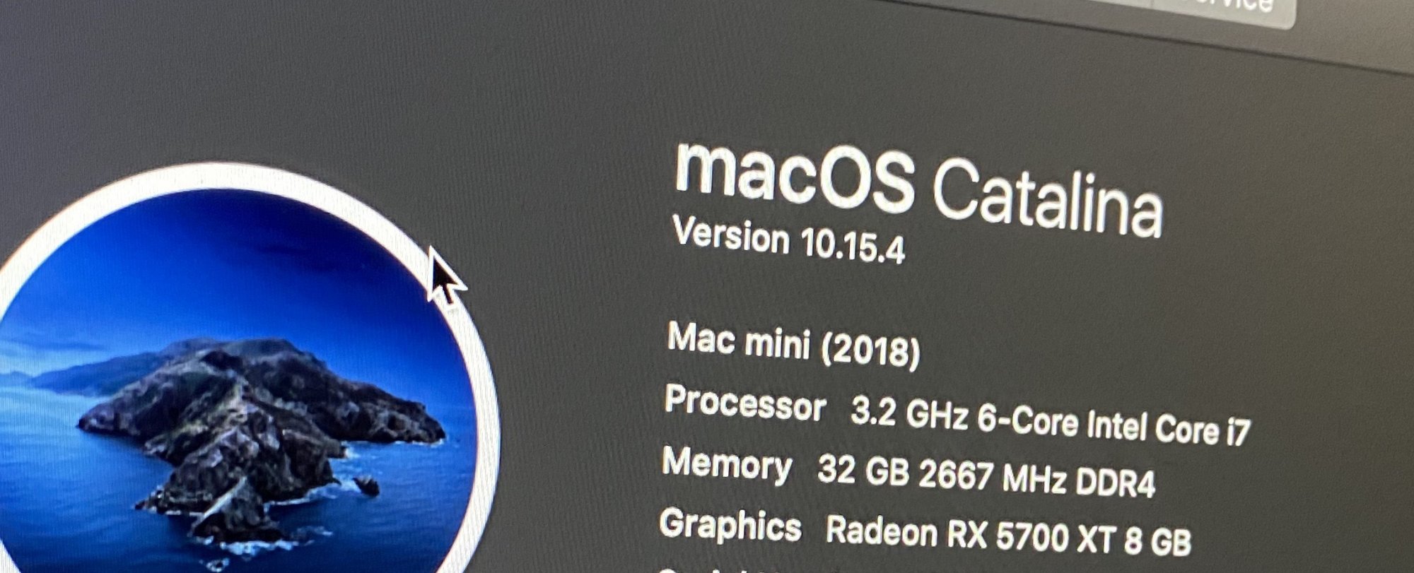

I don’t hear anything but again I only tried dota 2 on max settings I want to try Witcher 2 to text.
