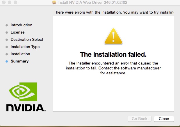

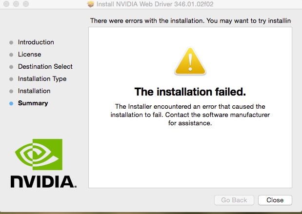

updated modified driver?
anyone have one?
I keep getting an installation failed problem...goes until it validates packages, and then craps on itself
There is a little known secret if you are using a card that exists in OS X already.
If you connect the eGPU and it sees Nvidia card it will let you install.
Re:
Right, my problem was the driver would not even install...when Nvidia posted the new 02f driver on 22 April, the driver installed but still came up on restart as incompatible, worked with NVIDIA live support, and they concluded yup the driver is still not good...so waiting 😡
