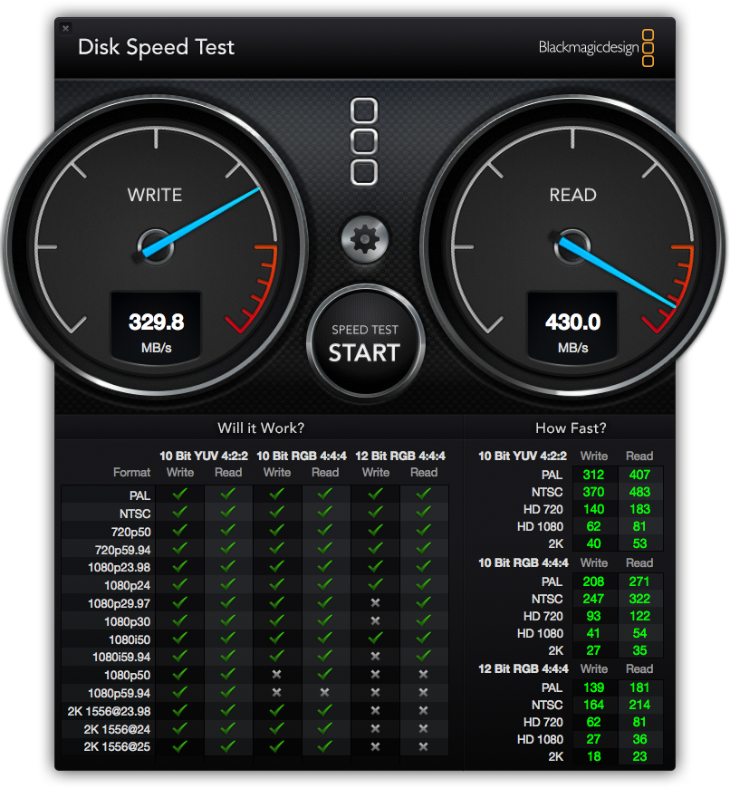

So I decided to go with the Crucial MX100 256GB SSD with the inateck USB 3.0 enclosure. Very happy with the results!
