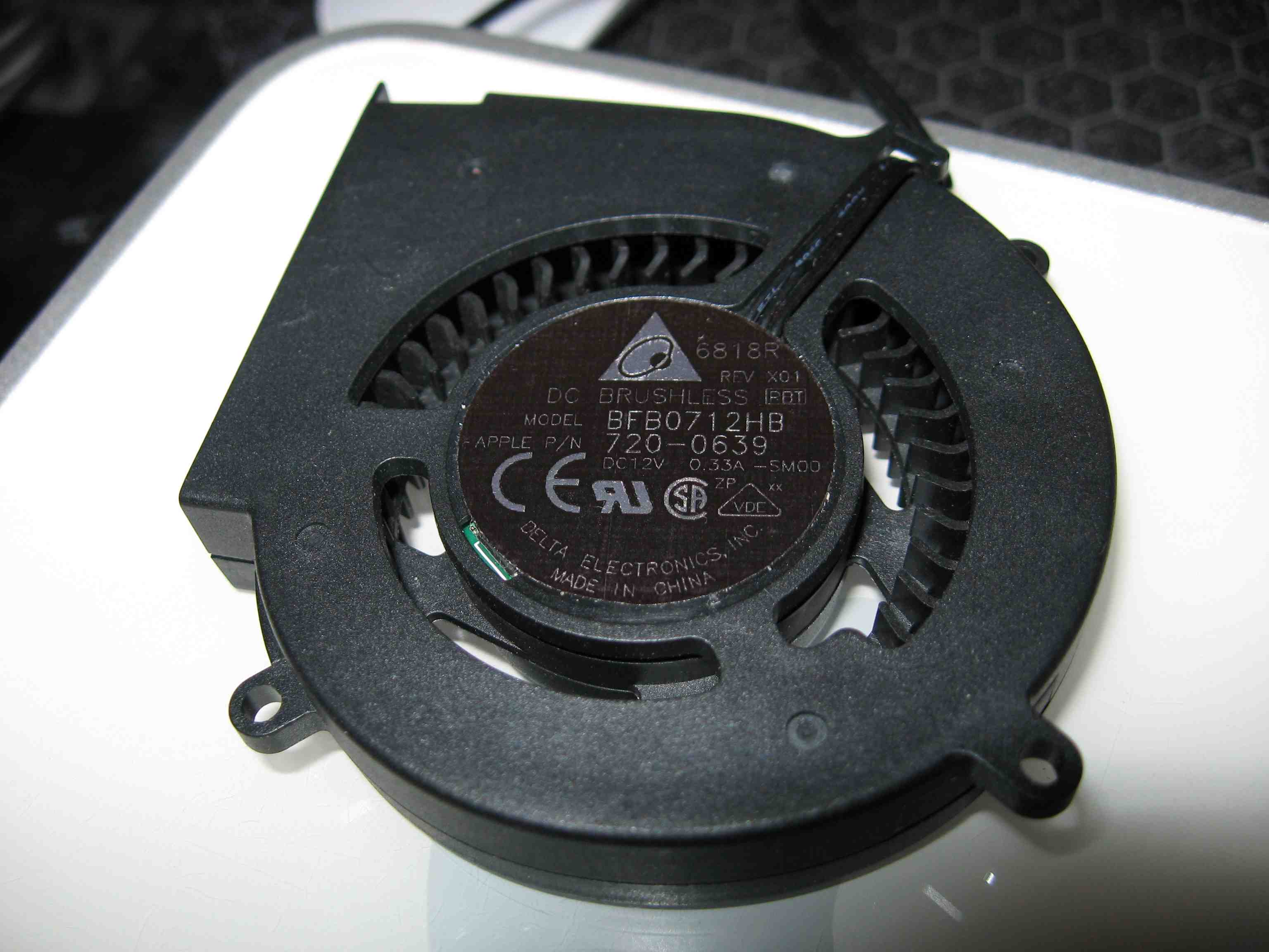

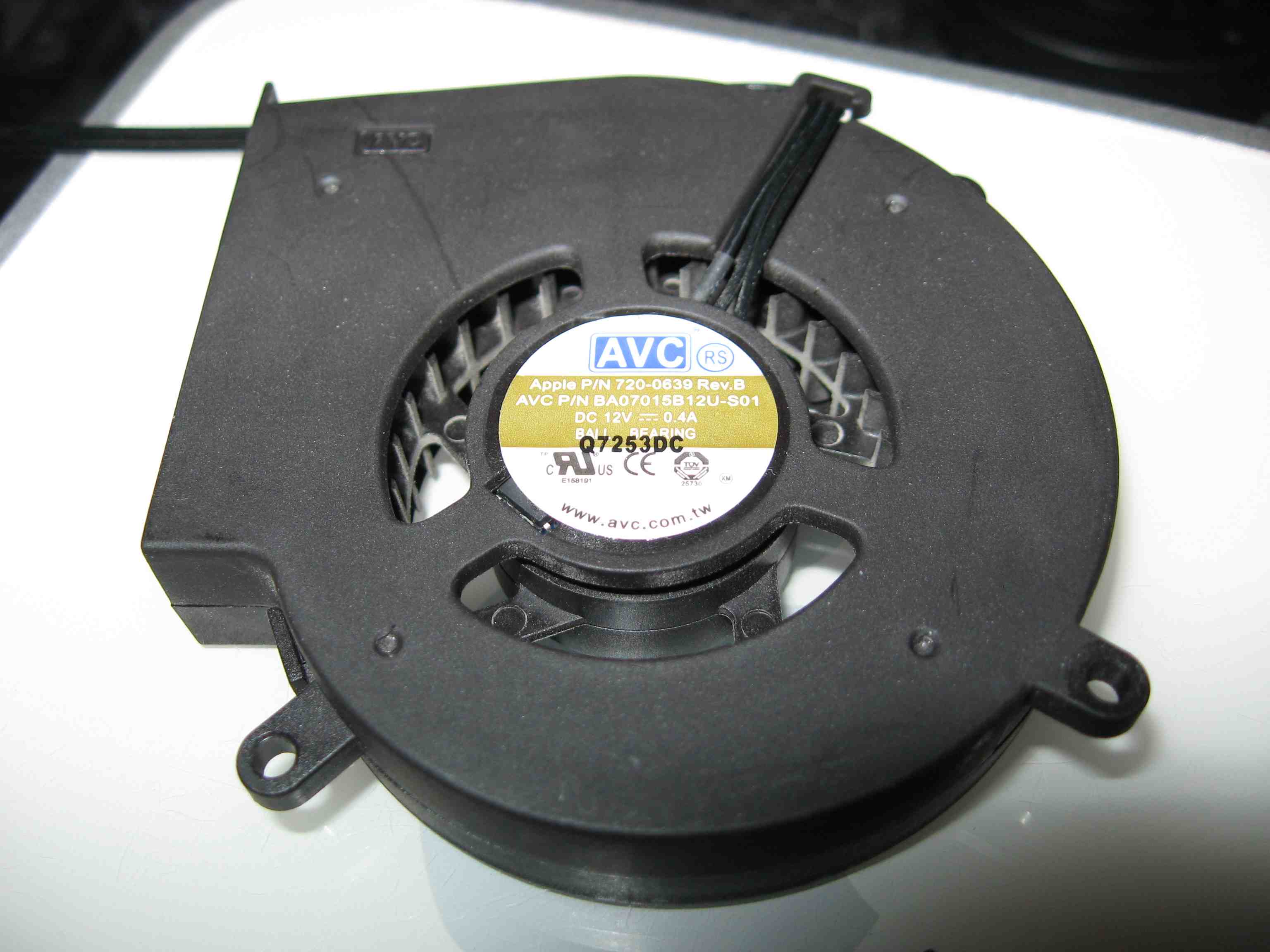

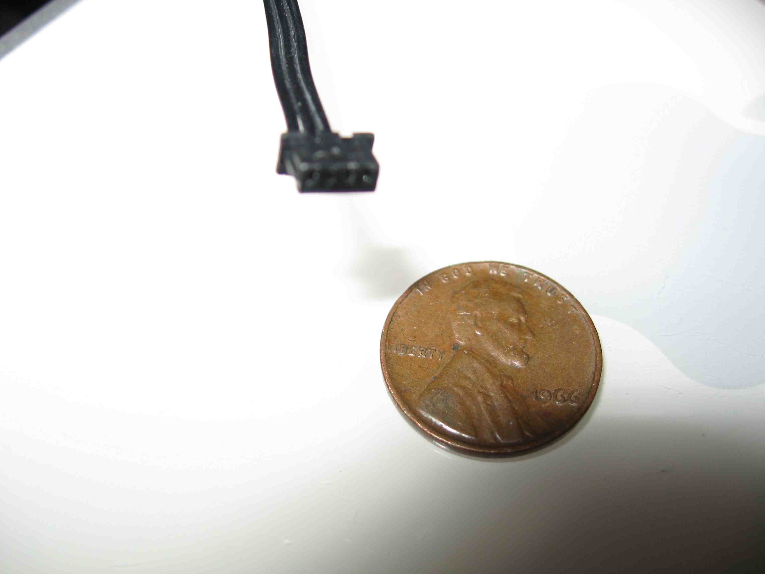

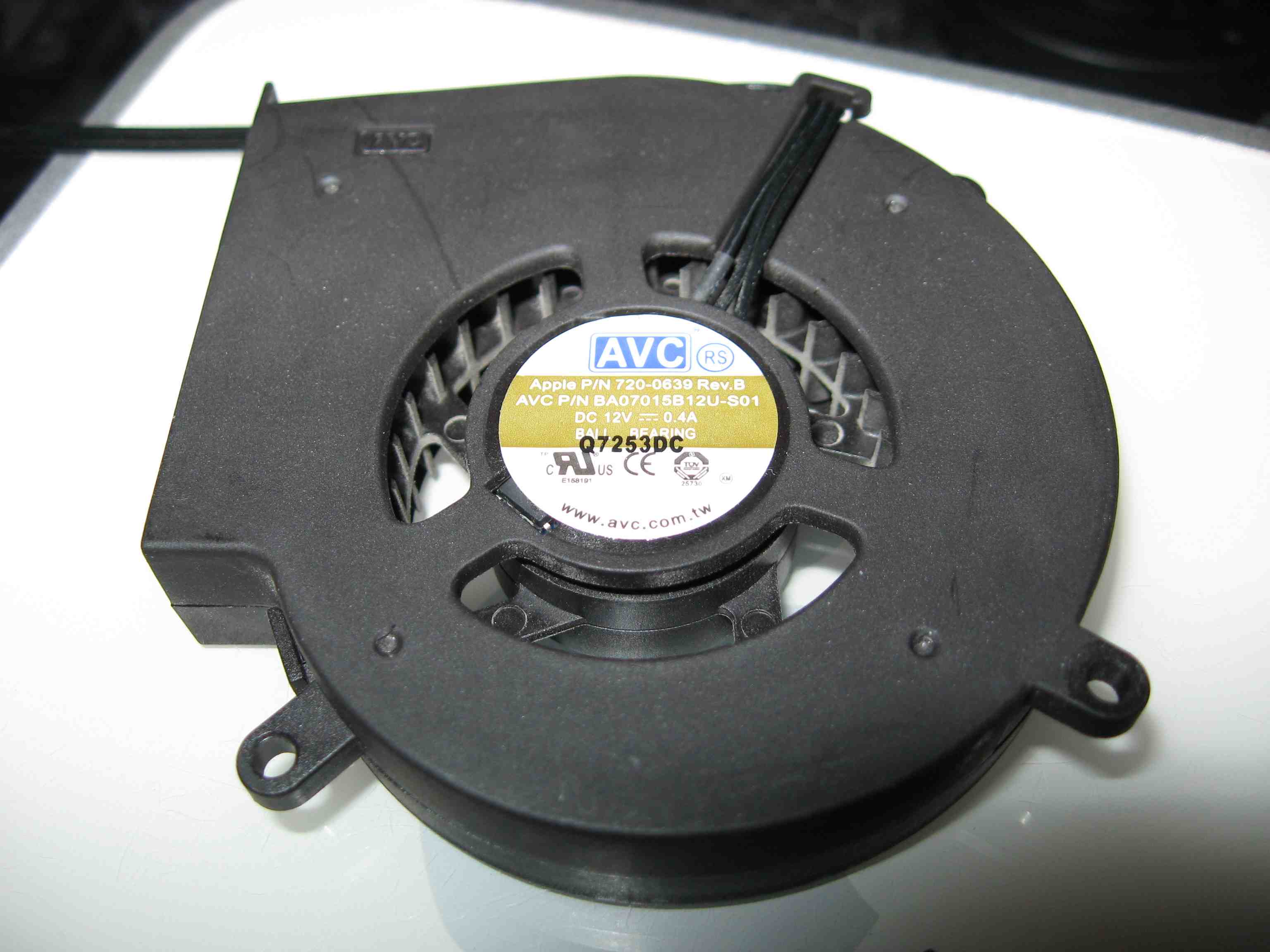

When installing the SSD, I noticed the manufacturer of the fan. It's an AVC (Asia Vital Components) custom fan/blower for the Mini. It uses a custom 4-wire connector with 3 spaces used.
Just for curiosity, I searched eBay for "Mac Mini Fan" and came up with several results.

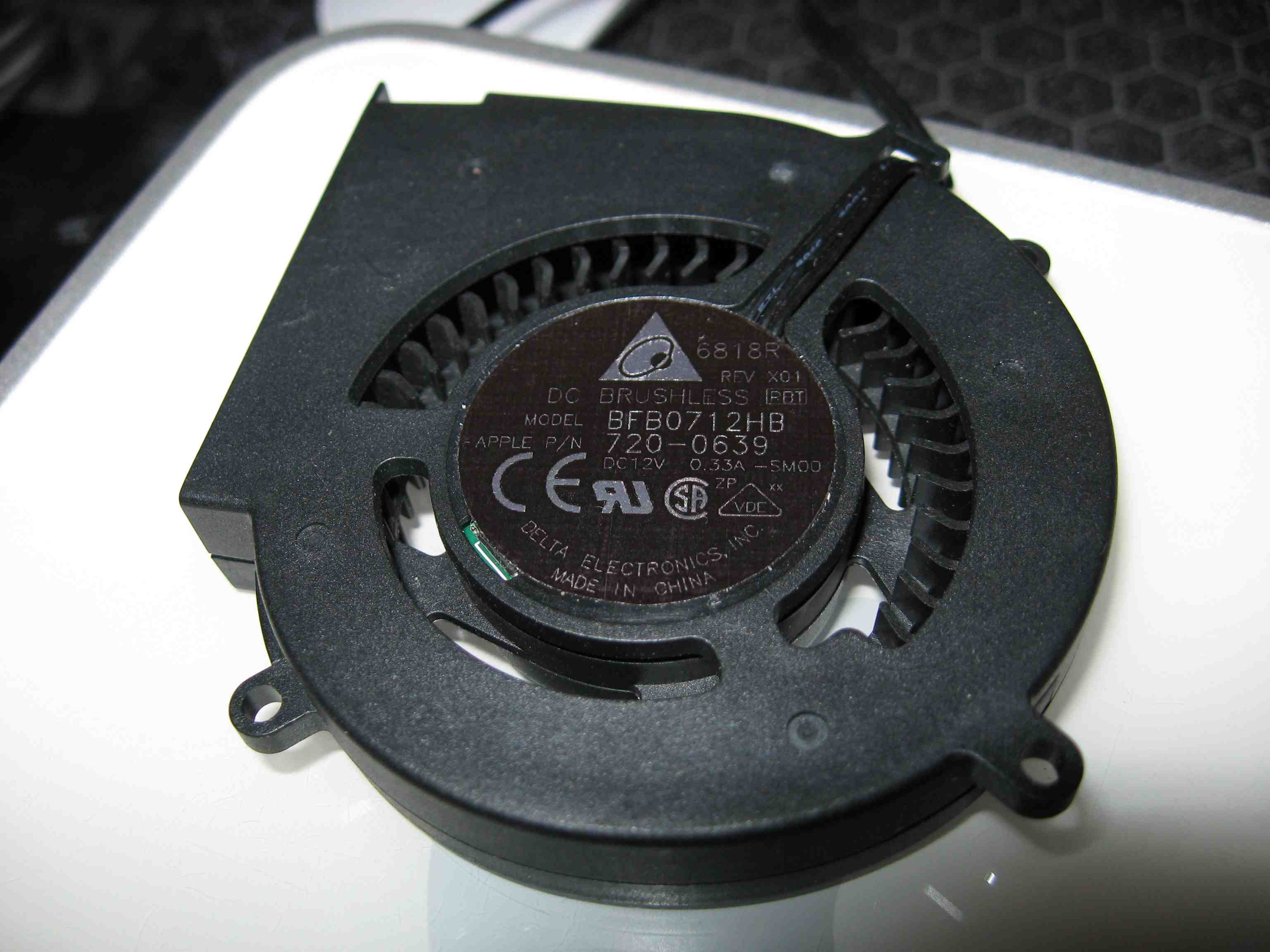

Surprise! Plenty are available for the 1.83/2.0 mid-2007 Mini. Also, they're from a different Vendor, Delta.
So I ordered one up and installed it. The fan noise is very similar in volume but slightly more annoying in character. From my point of view the original AVC fan is less annoying but only by a very small amount.
The construction of these two blowers is considerably different. The fact that the noise signature is very similar seems to indicate a very exact specification from Apple.
Disassembling a Mini is not for the faint of heart, weak of eye or unsteady of hand. The parts and bolts are tiny and delicate. The all-important Airflow is carefully contrived to cool all parts adequately using both the inlet and outlet of the blower. It's very important to make sure that all the foam seals are in the correct locations, particularly the one attached to the bottom of the hard drive.

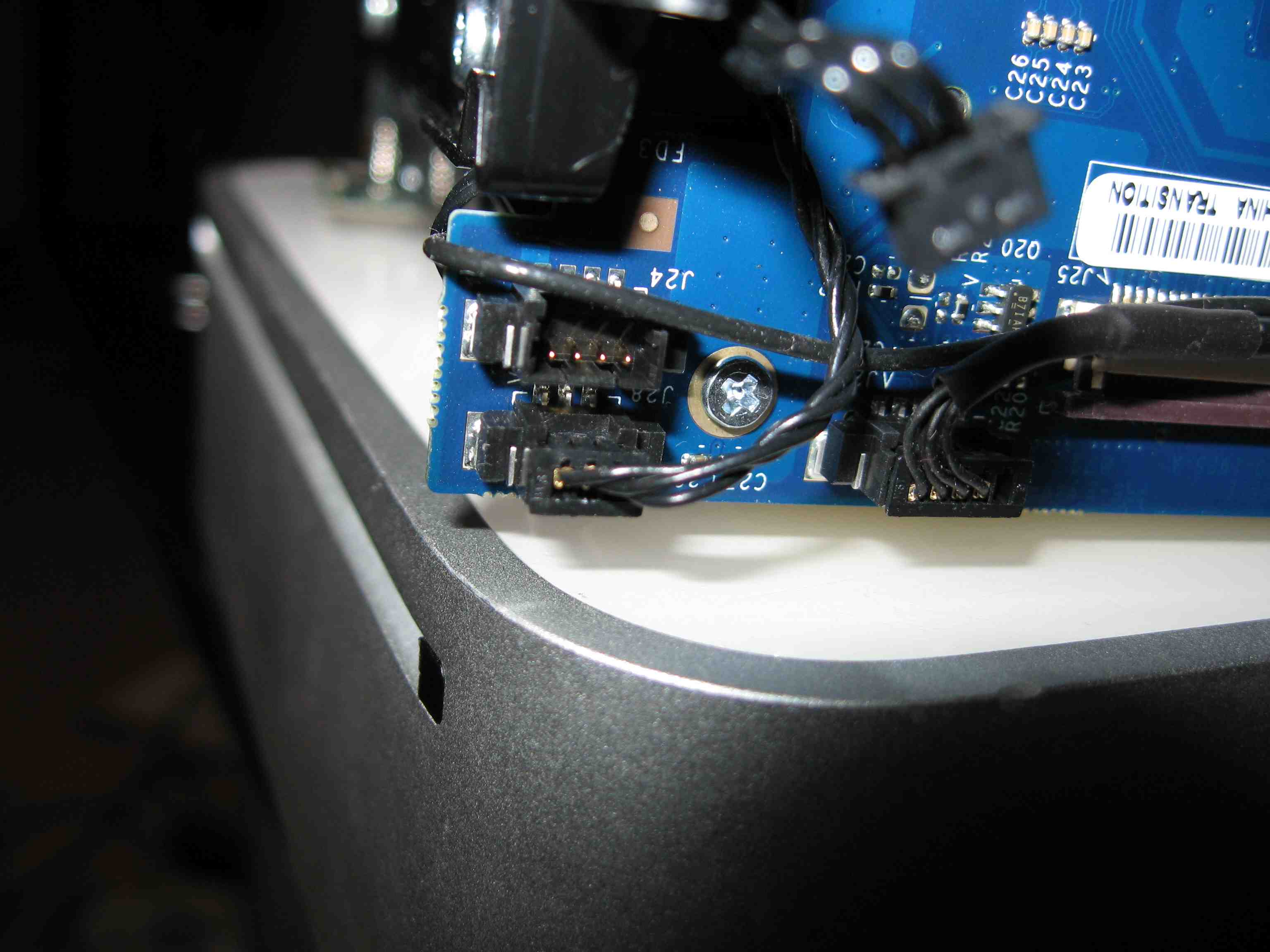

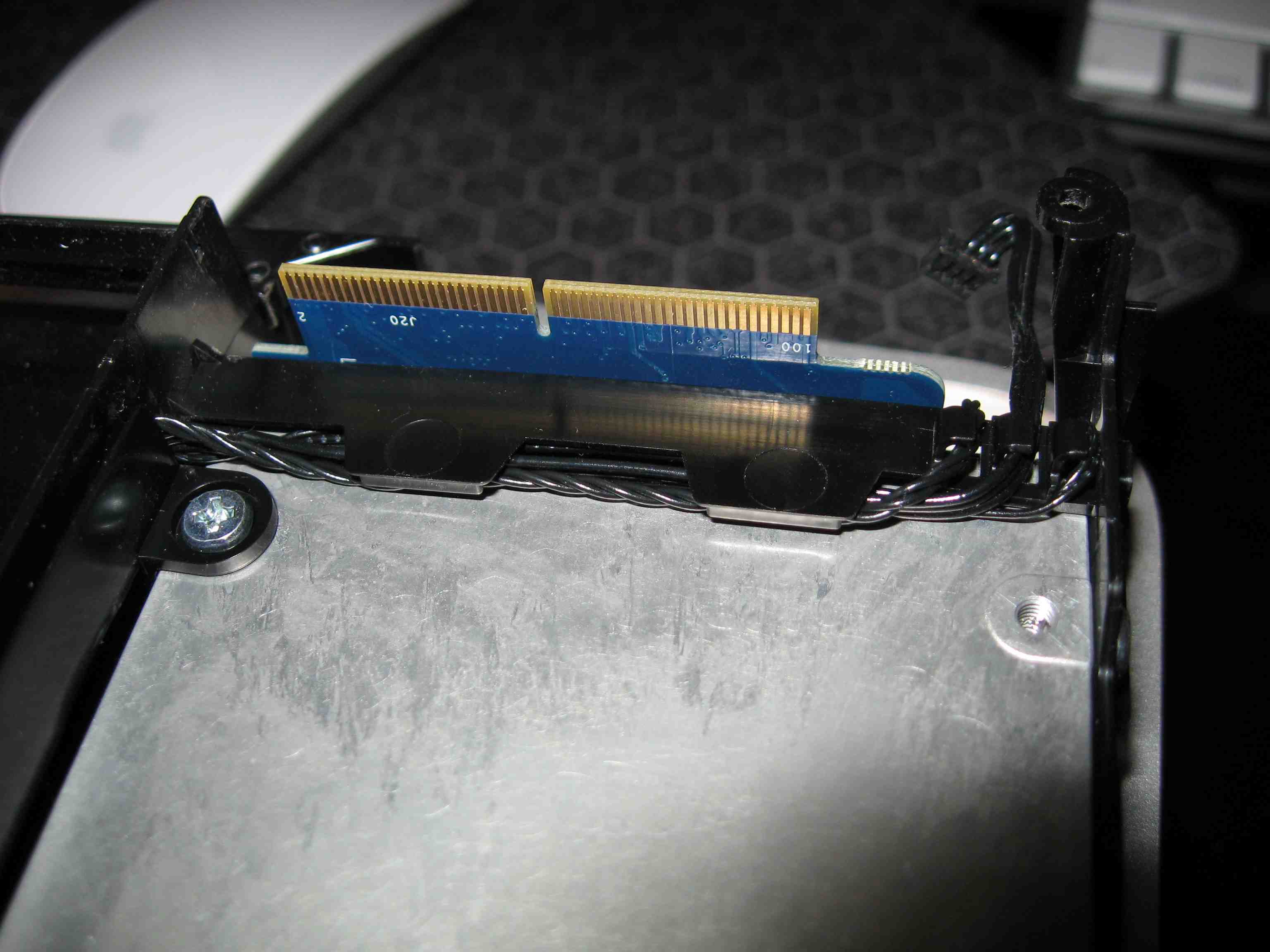

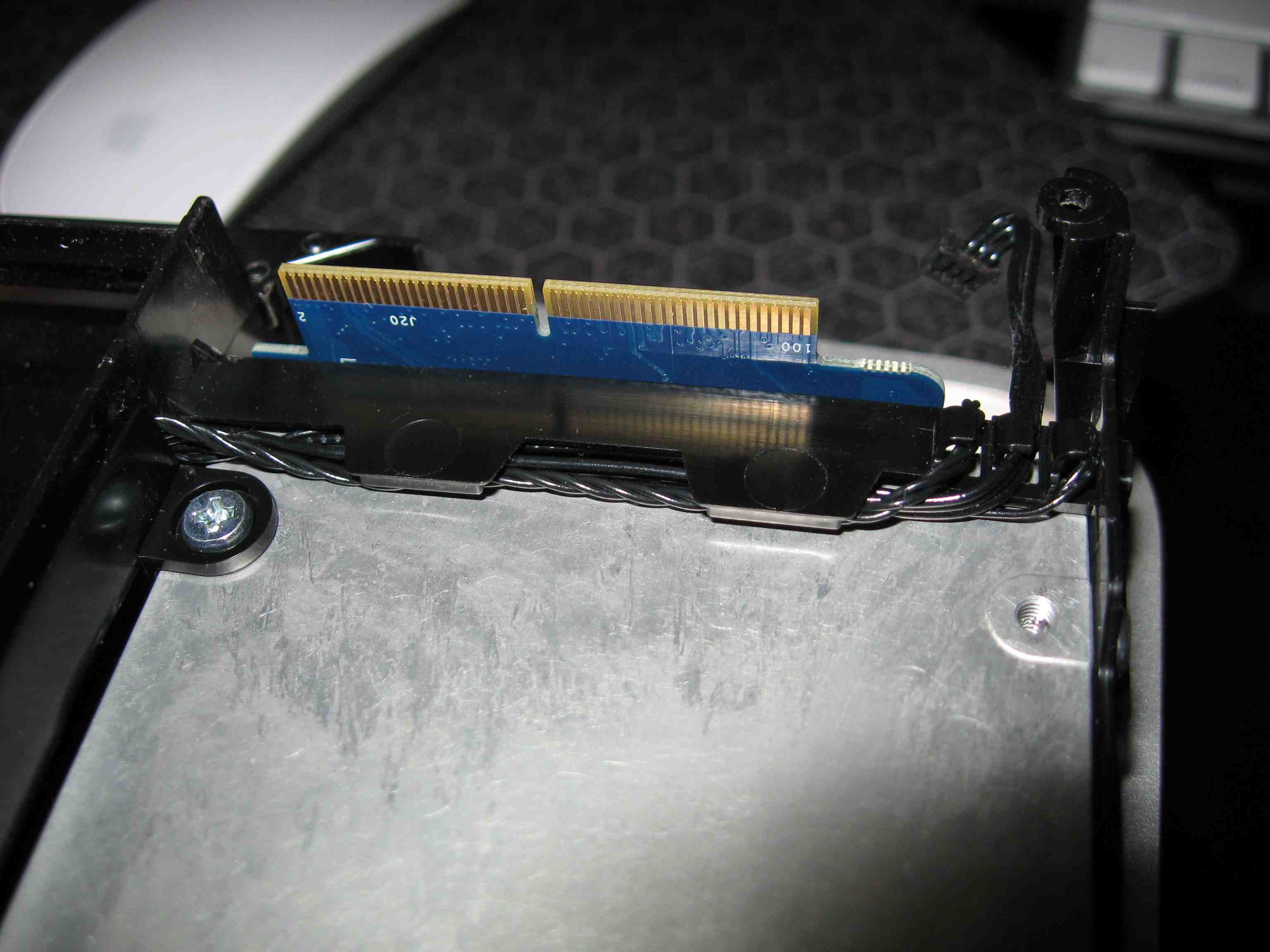

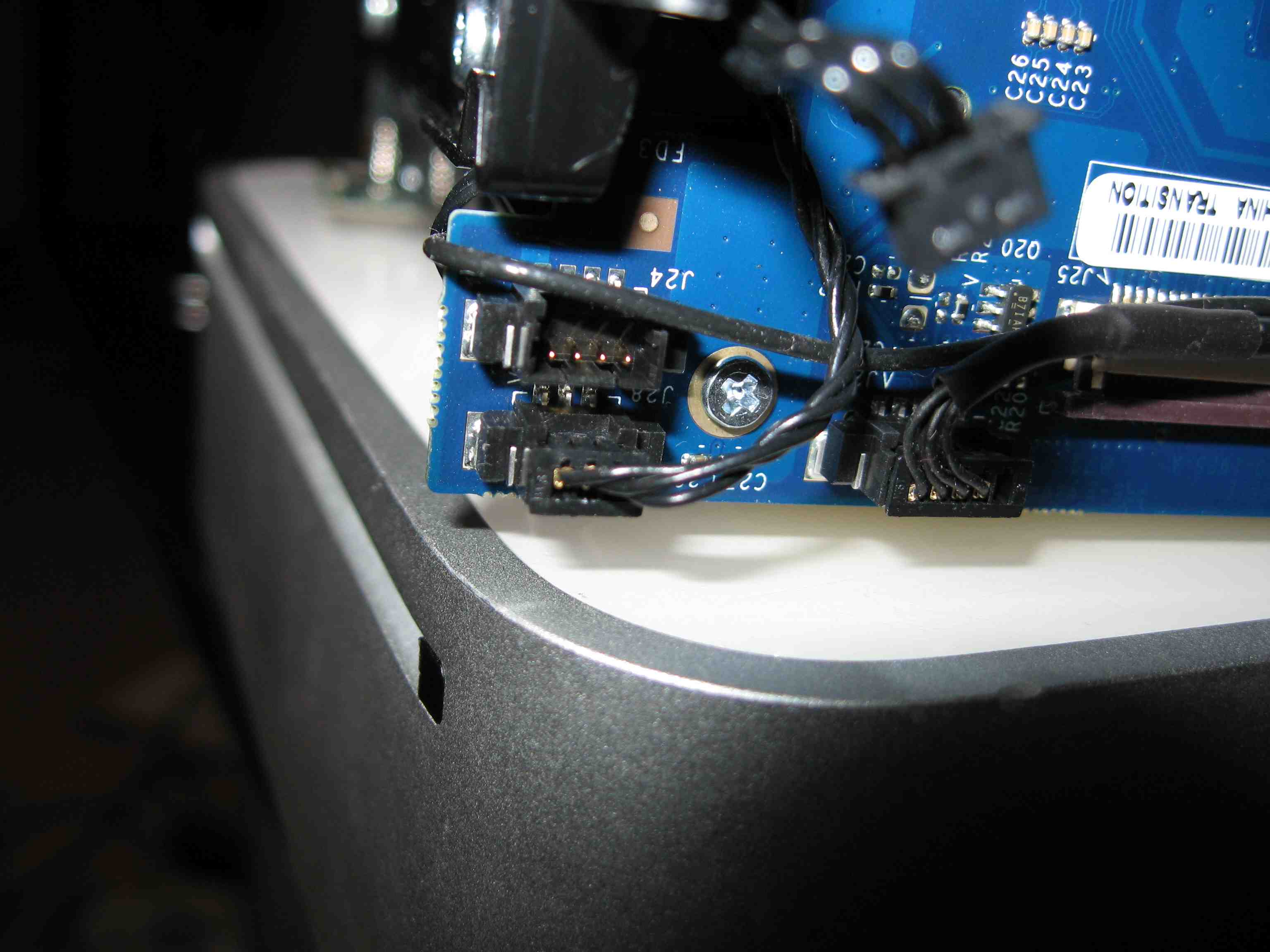

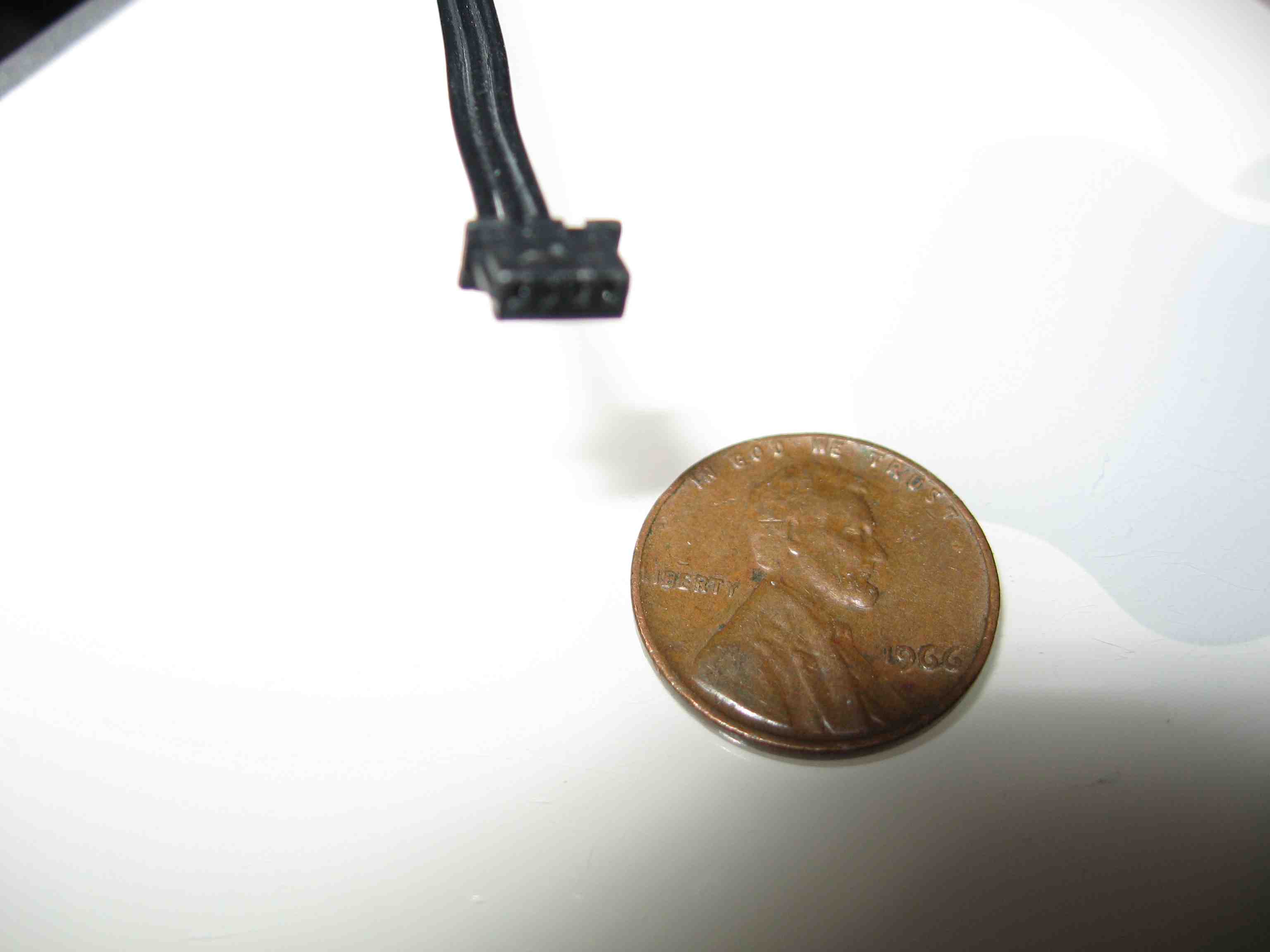

Here's some pictures of the original and replacement fan, its connector, the wire routing and the board it plugs into.
While a 3-wire fan, it's a good bet that it's not a standard "+,-,Tach" wiring approach nor should one assume which wire does what. Fitting a Zalman FanMate as suggested elsewhere is impractical as there's no place for it. There's hardly any room for the existing wiring let alone modified, spliced wiring - you'd have to make tiny soldered, heatshrinked connections and mount the FanMate outside.. yuck!
It's another good bet that the firmware doesn't like seeing the fan run at a different speed than commanded.
Nor should it. The Mini needs its cooling air. We as fussy users need to respect this and just leave the fan speed alone.
But you might want to try an AVC-supplied Apple fan. It seems slightly better.

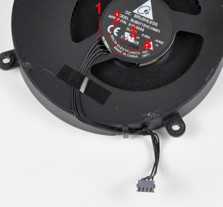

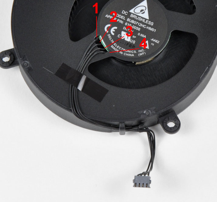

I've recently purchased a 2010 Mac Mini from eBay. The mac has a defect insofar that the fan runs at full tilt. Upon further investigation it turns out that the fan cabling has been re-soldered to the board (ie. no plug anymore) and probably in the wrong order as the OS constantly reports fan RPM as 0. A reset of SMC etc had no effect. I'd rather know what the previous owner has done... 🙁
If anyone's got a 2010 Mac mini fan (preferably MC270D/A, Model A1347) lying about I'd really appreciate it if he/she could you share the pin assignment of the fan connector. If possible, both on the board and the cable coming from the fan (Eg, the first fan-cable should go to the second contact beginning with the side where the RAM is located, etc.)
I've enclosed an image with a fan and numbering of cables if this helps to clarify any responses.
Once I got this solved I'll be happy to confirm and pay it forward by relaying the response to the 2 other poor sods in the same situation on the iFixit forums.
