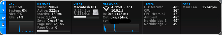

I have a 2.0GHz core 2 duo Mac Mini 1,1 and here are my readings:
I had to upgrade to 10.6.4 to run the magic trackpad installation software, and there doesn't seem to be any more updates to install. The fans sound like they're running at full speed, like they do when you start up. The iStat is telling me the fans running at approx. 5500 rpm.
The current various temps are: HD-35, CPU-42, CPU heatsink-33, Ambient-57, Northbridge 1-38, Northbridge 2-39.
I have no idea if these are normal? What do you think?
With 30% cpu usage my fan runs at 2900. Temps are 50-70°. So your fan is running extra fast but at least things are nice and cool.
