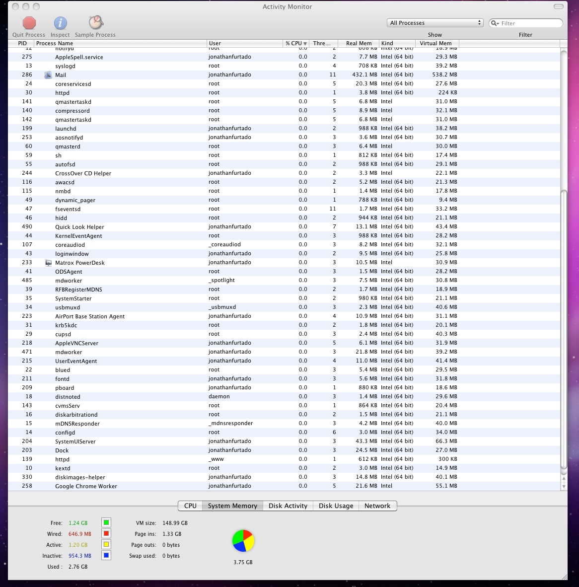

  1. Launch Activity Monitor
  2. Change "My Processes" at the top to "All Processes"
  3. Click on the CPU column heading once or twice, so the arrow points downward (highest values on top).
  4. Click on the System Memory tab at the bottom.
  5. Take a screen shot of the whole Activity Monitor window, then scroll down to see the rest of the list, take another screen shot
  6. Post your screenshots.

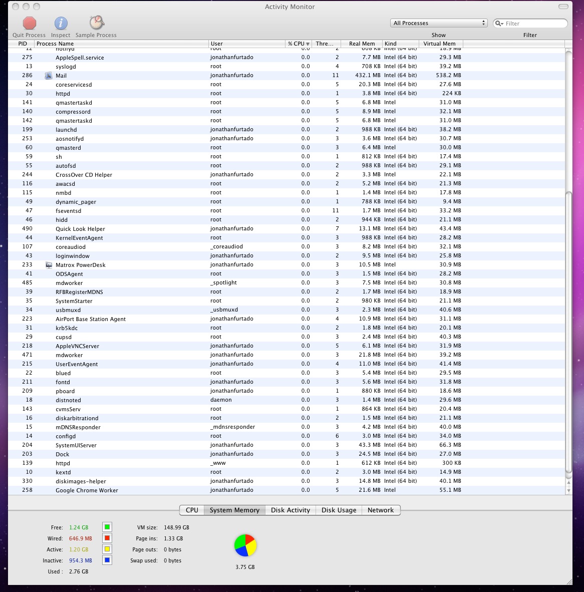

Here you go.

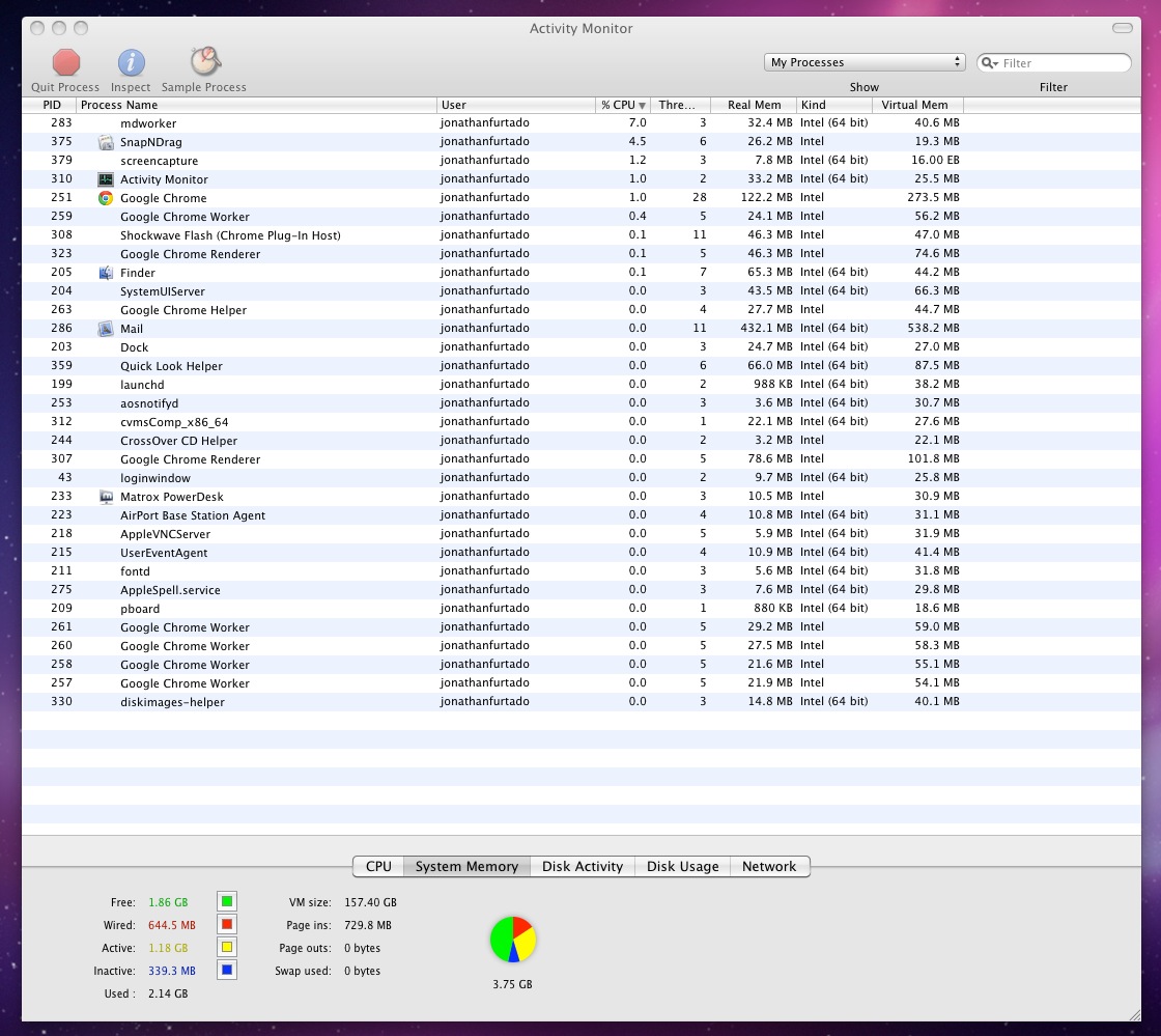

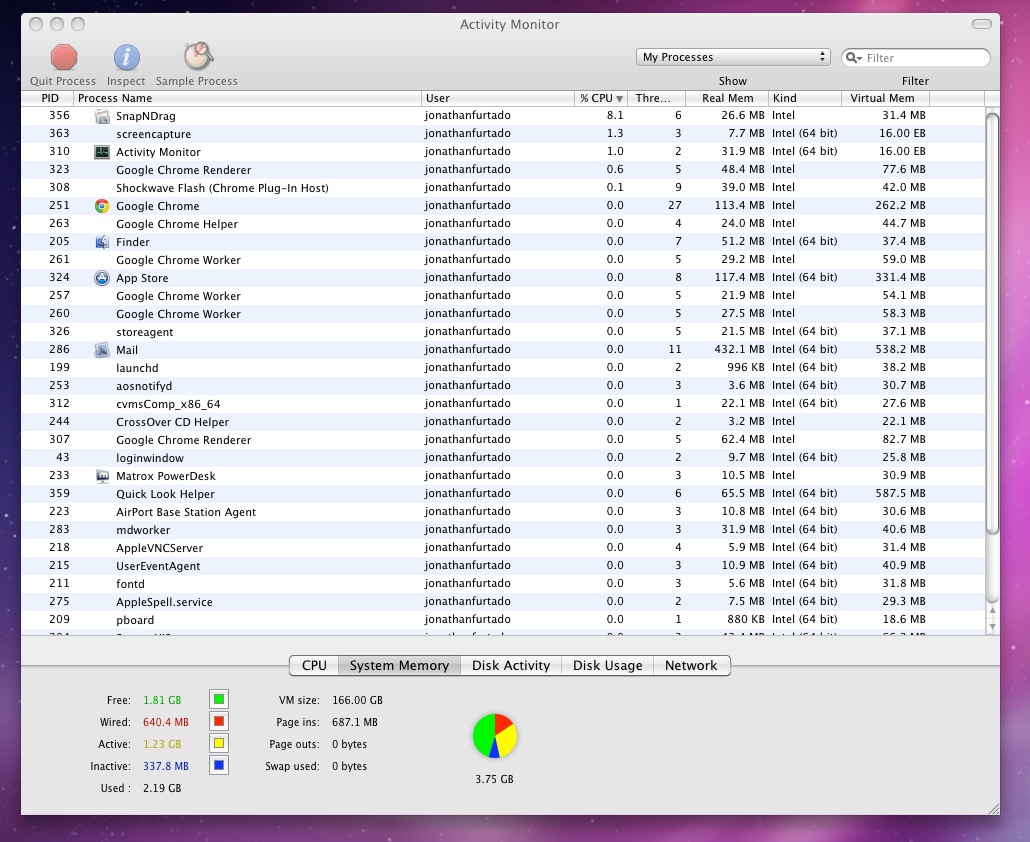

Is this correct?

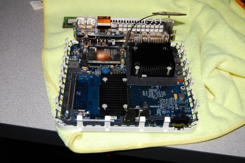

This is my 2007 Core 2 Duo 1.83gHz Mac mini. I opened mine to add RAM and install a larger HD. I didn't mess with the CPU heat sink. From the picture you can see it's held down with 4 spring loaded locking push pins. You probably need to release them from the bottom of the circuit board to remove it. It should be easy to do.
