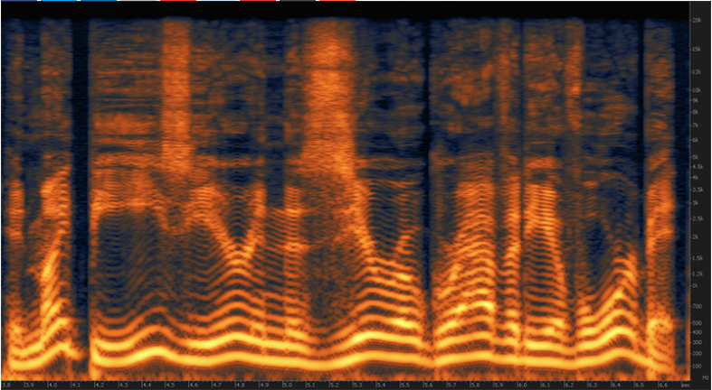

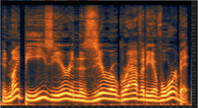

As someone who owns, and is actually using, both a 27" 5K Retina iMac (late 2014, i7, 500GB/32GB) and a 2018 mini, I don't have a dog in this race.
First, I did not say that the iMac is a "better" computer, or anything close to that. I said that the mini is not a better value as a straight matter of cost, and in some configurations could wind up costing significantly more money. This is just a fact; as in, apply grade school arithmetic and add up the numbers. I have no idea why you quoted me, and then completely failed to address what I actually said.
I record regularly to the iMac and have never had an issue with it making noise that is picked up when recording. Not only do I not hear computer noise when playing back with Focal Solo6 speakers or Byerdynamic DT 1990 Pro headphones, I don't see any evidence of computer noise on iZotope RX spectrograms*. I sure see evidence of noise (hard to avoid in NY), but not from the computer.
This week I will be testing for, and am more concerned about, the mini's potential for fan noise. If there is an issue, as a good number of people are saying, it won't exactly be a surprise given the size of the machine and its enclosure. That said, my thinking is that if there is an issue, it is manageable.
I have been using the iMac for music and sound design for four years. The 32GB of RAM works fine, the 500GB SSD works fine, and the idea that it is suddenly inferior is disconnected from real life. It is in fact a more capable machine than many, many people are using.
The main difference is the mini's Thunderbolt 3/USB-C ports are obviously faster than those on my 2014 iMac, but they are not faster than ports on the current iMac.
Having regard their budget, people should purchase whatever suits their needs and preferences, but these "what's better" discussions are a complete waste of time, especially when one of the participants doesn't even own the machine that he's plumping for, has never directly compared the machines that he's talking about, and is relying on what he calls "reports".
* For those who aren't familiar with iZotope RX spectrograms, they look like this. They show sound, including sound that is inaudible to humans, by frequency and intensity over time:
