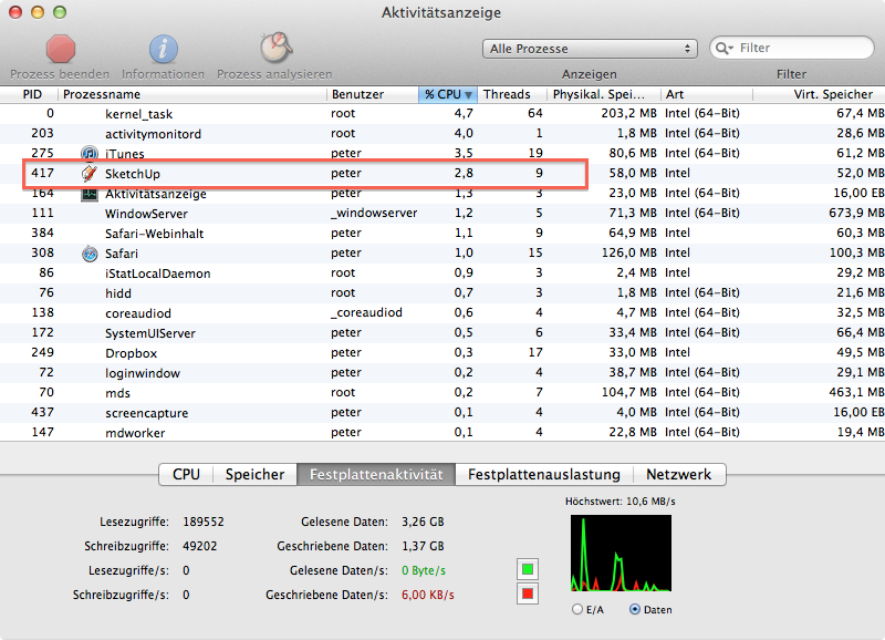

Sketchup is 32 bit and uses one core so really my decision is made already i'll take the i7 with the amd the turbo boost will reach 3.4 something i hope so it should fly.I also heard lion is a little ram hungry so i'll most probably upgrade the ram to 8 or 16GB (owc)
Sketchup is a multithreaded application (see attachment) so it might benefit from a multicore CPU.
interesting
Thanks again Peter that's very insightfull. I always understood sketchup used one core so clock speed was ultimately the most important thing. Is it not the case that all those threads are using the same core ? What does the cpu history show when you are using sketchup mine only shows one core active ?
I've just loaded the Saint-Peters scene, moved the cathedral around and both cores where used.
