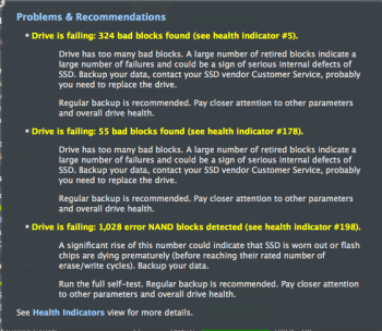

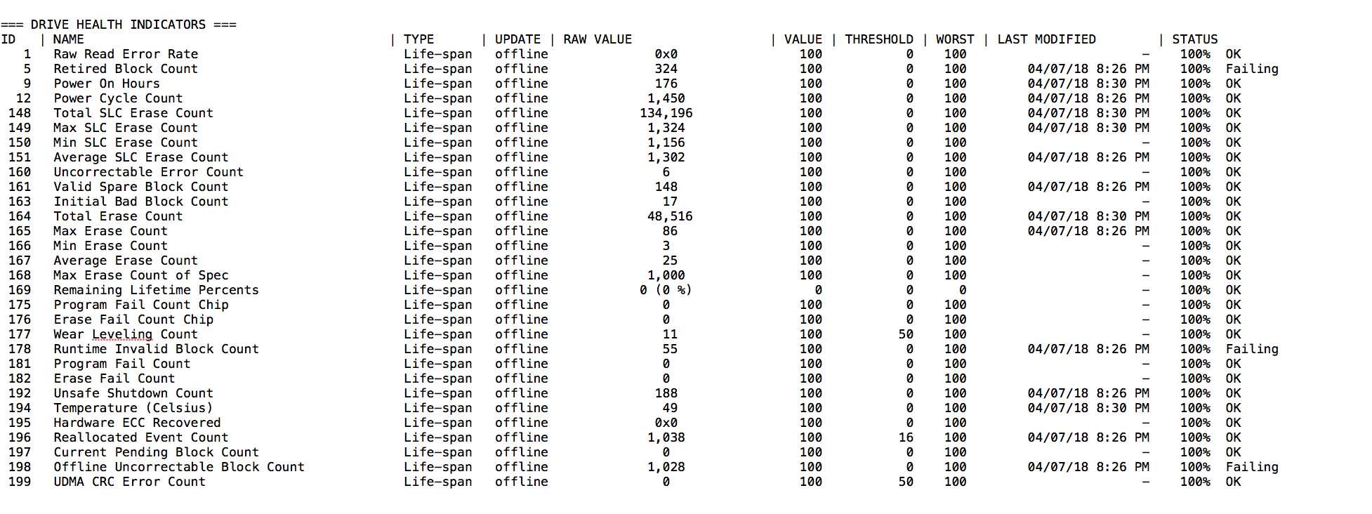

My Mac mini 2011 model, has been freezing off lately. I am using ADATA SSD on my Mac mini. The freezing happens everyday, mostly when playing videos or compiling code. The apple disk utility command diskutil info disk0 | grep SMART. I get the SMART status verified response. Using an app called DriveDX I came to know that my Hard Drive is failing. I am uploading the screenshot of the result. I think that the drive needs to be replaced, your advice is appreciated. Thanks in advance.

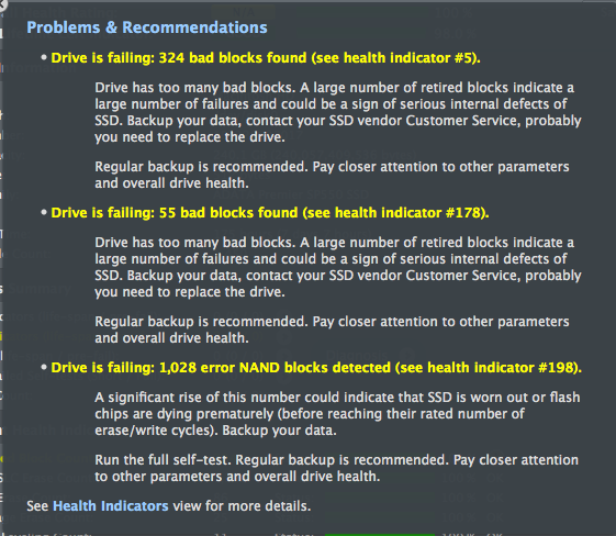

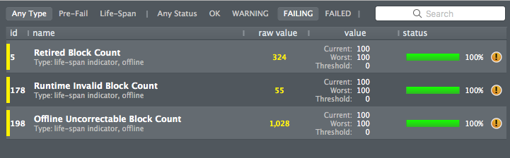

I would surely give that a try, the freezing happens every 10 minutes. I could be surfing the web or just playing music via iTunes. When booting in verbose mode I did see errors related to block count. Hence I ran the DriveDX app which indicated that the SSD's Advanced SMART status is failing. I did attach screenshot of the report in the original message. Btw how reliable are the ADATA SSDs. I have attached the error report I got through DriveDX app

Take the interpretation that these programs give with a grain of salt. What I'm seeing is that on April 7 (probably), something happened that caused the SSD to retire some data blocks. SSD's will typically reserve some space (typically in gigabytes) for the eventuality that some data blocks will fail and that's what happened to your SSD, probably on April 7. I say probably because it takes more bytes to store a large calendar so it's typical that the timestamp values for the individual attributes will recycle at some point. But April 7 sounds plausible. The amount of bytes that went bad would depend on the block size of the SSD, but I would guess it's in the tens of megabytes (under 50). So if April 7 is the last time a block got retired and you have 324 blocks total retired, unless the manufacturer has over-provisioned a very small amount, I don't see how this can be characterized as a failing SSD. I very well could be wrong - you really have to ask the vendor for a proper interpretation and an overall characterization of your SSD's health. But if this is an econo-SSD from a company that caters to the econo segment of the market, you might not get support to get a proper interpretation.

One thing I noticed earlier but forgot to write in my previous post. Your screenshot shows a "Unsafe shutdown count" of 188. Any explanation for that? If not, is your SSD encrypted?

Wow, a lot of people are missing the obvious. The disk has quite a few bad sectors and uncorrectable errors. It is in the process of failing. Start saving for a new drive, and start backing up now.
