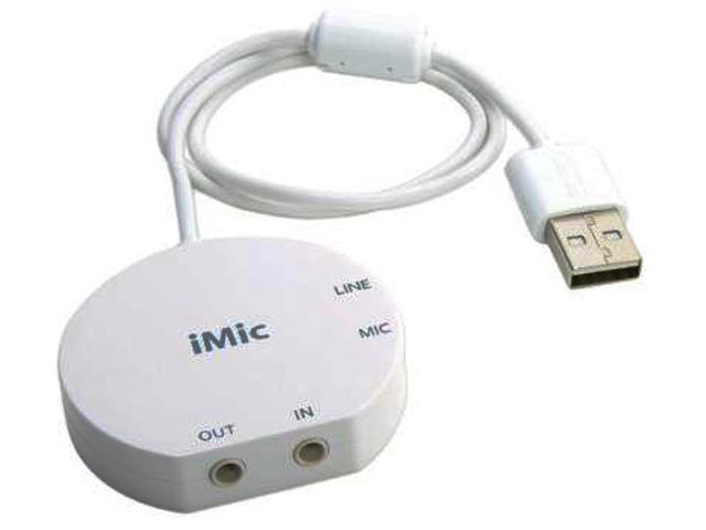

Back in the day, the go-to for a USB to audio output was the Griffin iMic. It has a separate line out and a microphone input and was PPC OS X compatible.

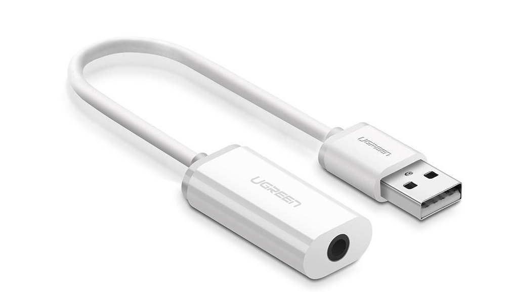

But realistically, every cheap USB audio adapter should work as they all use the same basic chipset. My understanding is that the Apple USB drivers in OS9 were not complete enough to use USB audio adapters as these benefit from Core Audio. There were some proprietary audio adapters like the M-Audio Transit that had their own OS9 drivers if you can find one cheap enough.

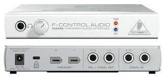

One other alternative is via Firewire. The LaCie Poulton Firewire speakers will give you audio out if that is all you want and there are a few cheap audio interfaces like the Behringer FC202. Again, I am not sure whether OS9 works well enough with these.

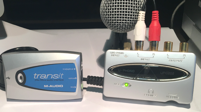

If you’re running a G4 Mac mini with the OS 9 hack - there are many noted problems with the line-level-out signals (headphones, patch cords, etc.). Might want to check / clean the female port… your male insert plug AND the cable itself / to whatever you’ve ported the sound out to. Invariably have often discovered bad (partially or intermittently) grounded shielding in certain “cables” around here.
AND especially if you’re getting similar noise via OS X… check / clean all your connection points and that cabling. I use the M-Audio Transit with my OS-9 hacked G4 Minis and no problems. However, the alternative USB devices mentioned by both Dronecatcher & BS Magnet above do look interesting. (Especially that £2.99 one.)
I’ve yet to try the Behringer UFO202 (also pictured below) with the G4 Mac mini.
