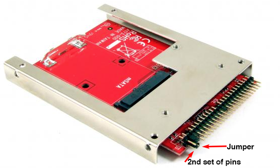

“…one of those eBay IDE adapters”
The G4 Mini requires a setting of Master, Slave or Cable Select. Don’t remember which* at present… and some of those adapters don’t offer any jumper settings. Almost missed that setting when I installed my first sled-mounted mSata in a G4 Mini to run OS 9.
Will be into a G4 Mini later this week and can then answer that *question.

I'll give the jumper settings a try. Umm... on any of the hard drives, I am not seeing a schematic. Instead of 6 or 8 pins like most drives, there are only 4 pins on any of these drives. Anyone have a cheat sheet? My google searching is not really coming up with anything.
First: found out that on PB G4 / Mac Mini hard drives, no jumper = master.
