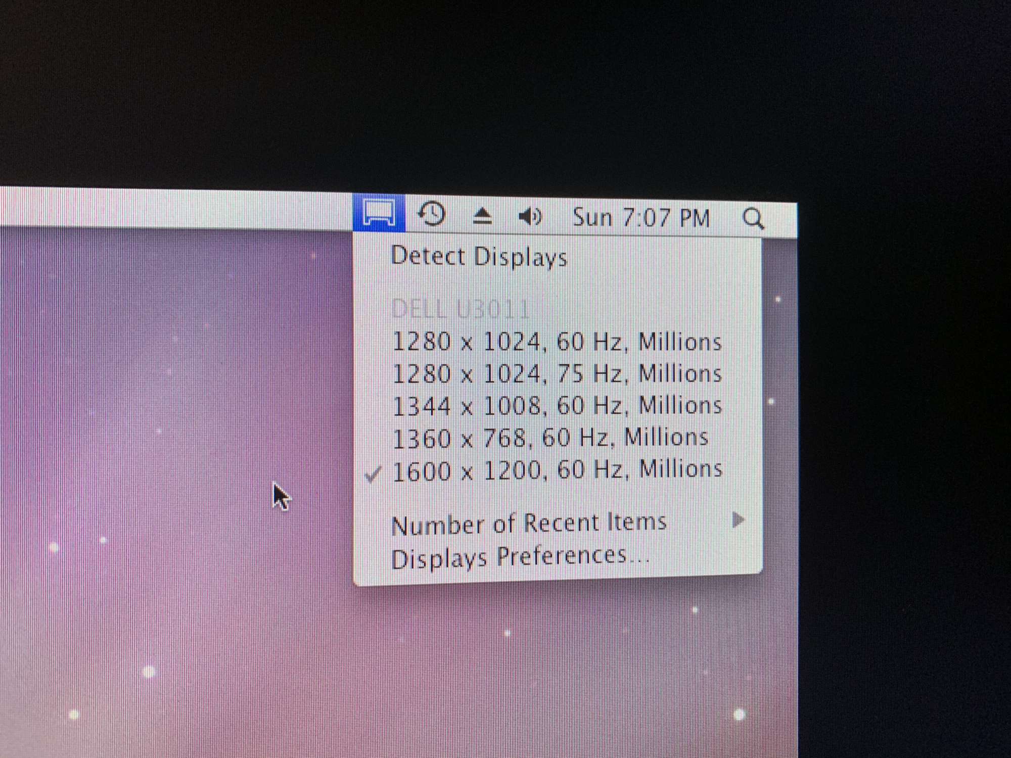

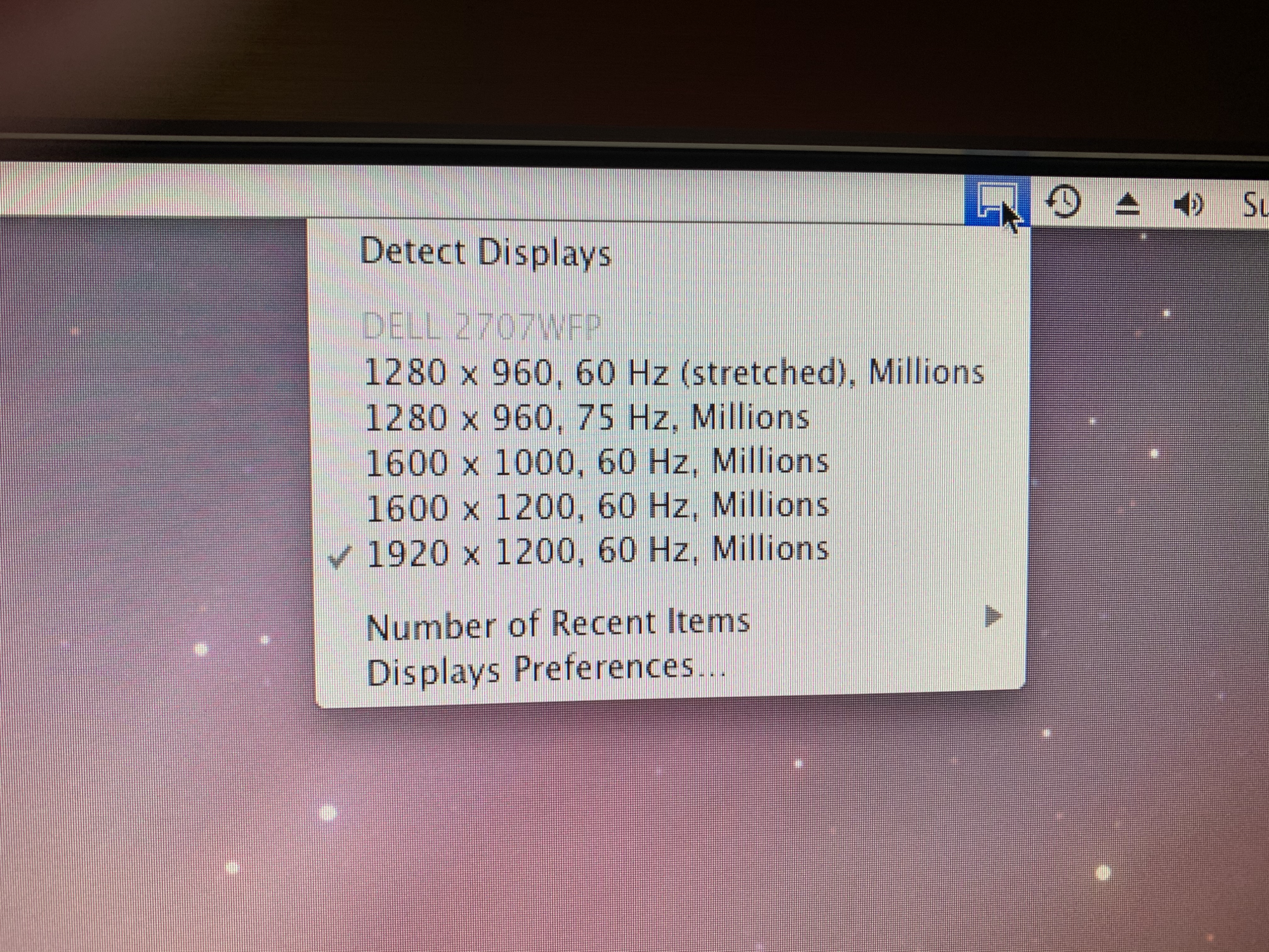

On a 2707WFP, the Mac will display the monitor's full HD resolution through a single-link DVI cable. On my U3011, it will max out at 1600x1200, so a 4:3 aspect ratio, regardless if I use a single-link or a dual-link connection.

All MacMinis only have single-link DVI, so using a dual-link cable will do you no good.
As such it will fail to display anything beyond 1920x1200 unless you drop the refresh rate, which might not be supported by the monitor.
Another question would be if you are running a 1.25/1.33/1.42GHz Mini or the silent-upgrade at 1.5GHz which is the only one with 64MB VRAM (all others 32MB) which is said to fair somewhat better at higher resolutions.
Thanks for your comment. My mini is the very first, 1.25GHz model, so 32MB Radeon it is.
My question is not about the mini itself, rather than the reason why a more modern monitor (2011) does not enable the 16:10 resolution, but an older monitor (2007) does. The U3011 will only go as far as 1600x1200, the 2707 will display 1920x1200. I used the single-link cable on both monitors, but with the above result, then tried the dual-link on the U3011 to double-check: 1600 is the most it will display.

It might be a monitor limitation - does the U3011 do 1920×1200 via single-link on another system?
In a way you're in luck because most (older) 30" LCDs lack a built-in scaler and will only do 1280×800 via single-link.

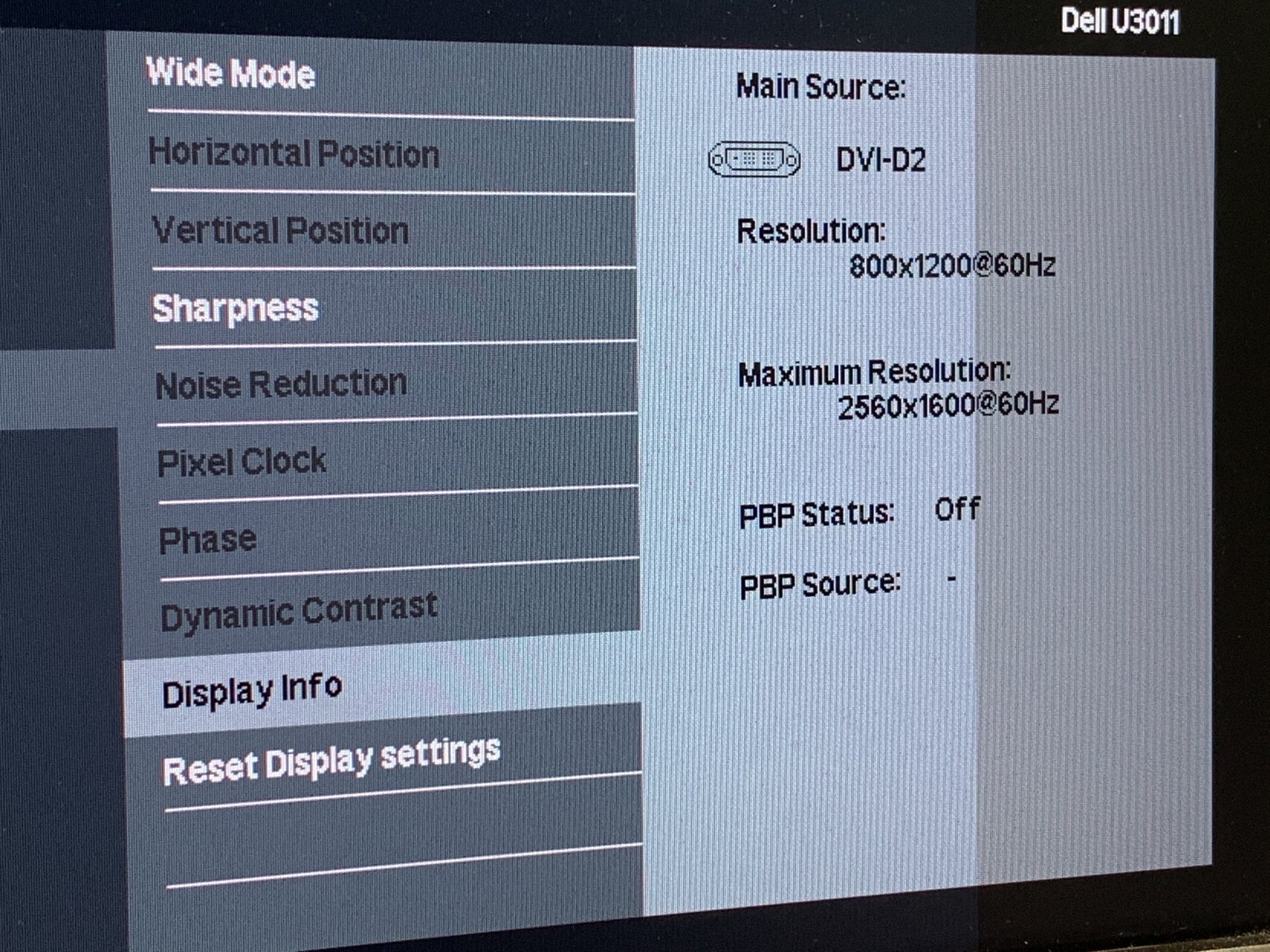

So... I've done some testing (after I rebuilt my studio/office 😁), and I've seen that:
- a MacBook Pro 13" can only display 1600 through a single-link cable (Apple mini-DP to DVI adapter);
- a MacBook Pro 17", the same (with the same adapter);
- the MBP 17" can display 1920 through a mini-DP to HDMI cable (same monitor, of course);
- a Lenovo laptop can display 1920 through the same single-link DVI cable.
= The monitor CAN display Full-HD resolution through a single-link DVI cable.
The way I see it, at this point, is that there is some "error" in Apple's OS, or a misconfiguration, perhaps.

I would have never thought that the monitor's technical specs would come to play a role in this, but it appears that the Mac mini's ATi graphics card carries the weight here.
From what I've learned through your suggestion, apparently, the GPU can only push a 135MHz pixel rate, which is below what the U3011 monitor needs for FullHD resolution. I've played around in the app a bit and was only once able to get the wide resolution displayed, albeit with a lower refresh rate. While trying to tweak the settings some more, I managed to mangle them enough to get a black screen. I'm now reinstalling Tiger... Oh, well. 😅
I used to play around with pixel clock, horizontal, and vertical refresh settings "in the old days" with CRT monitors (on PCs) but didn't think that these would still play a role with digital connections! One more lesson learned!

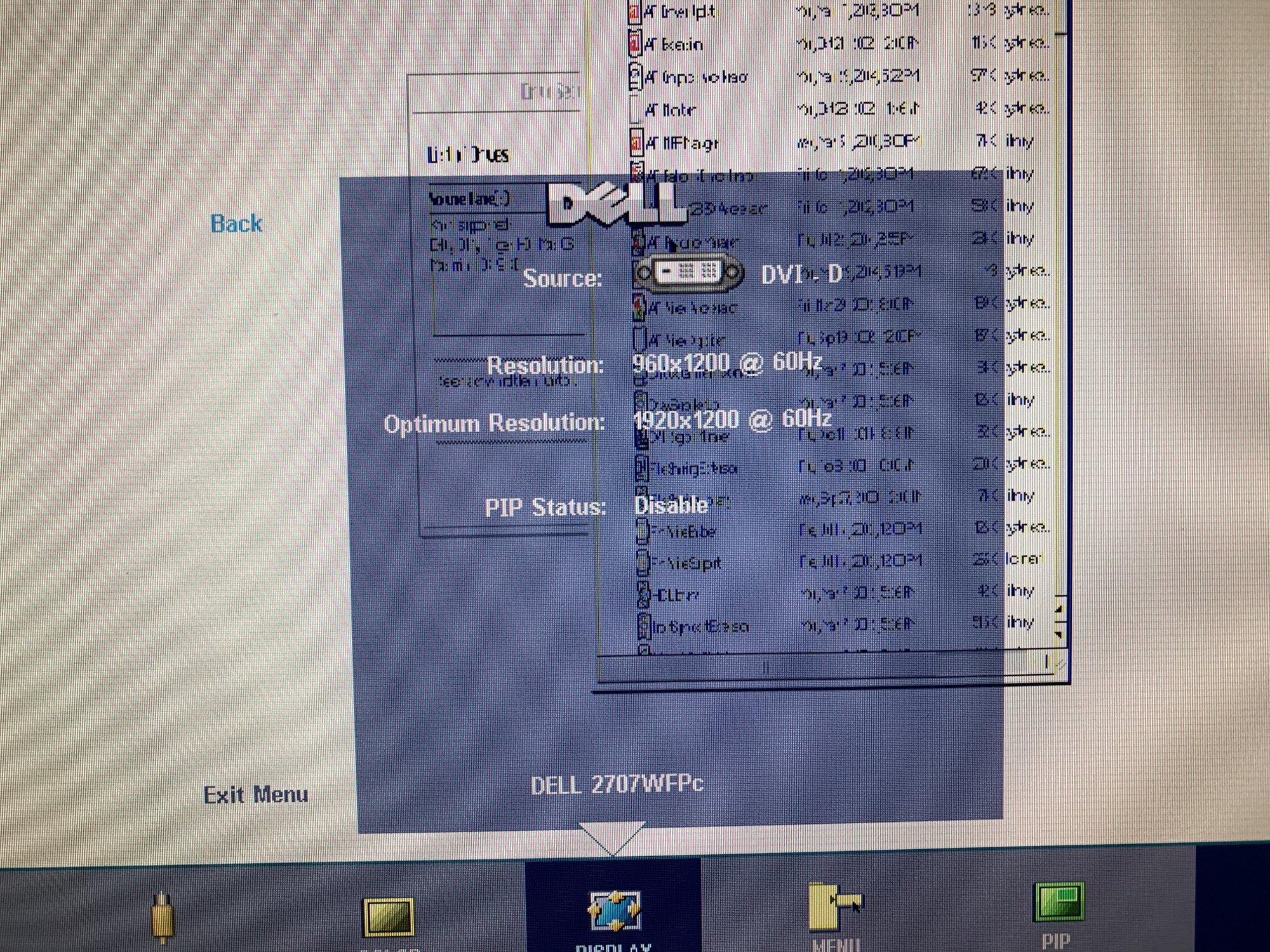

It turns out, the Mac mini G4 I bought is actually a PowerMac10,2, meaning a silent upgrade @1.5GHz! I'm pleased about this, but there IS a problem.

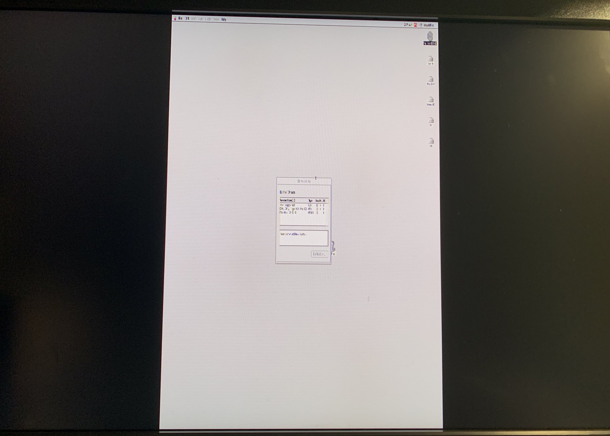

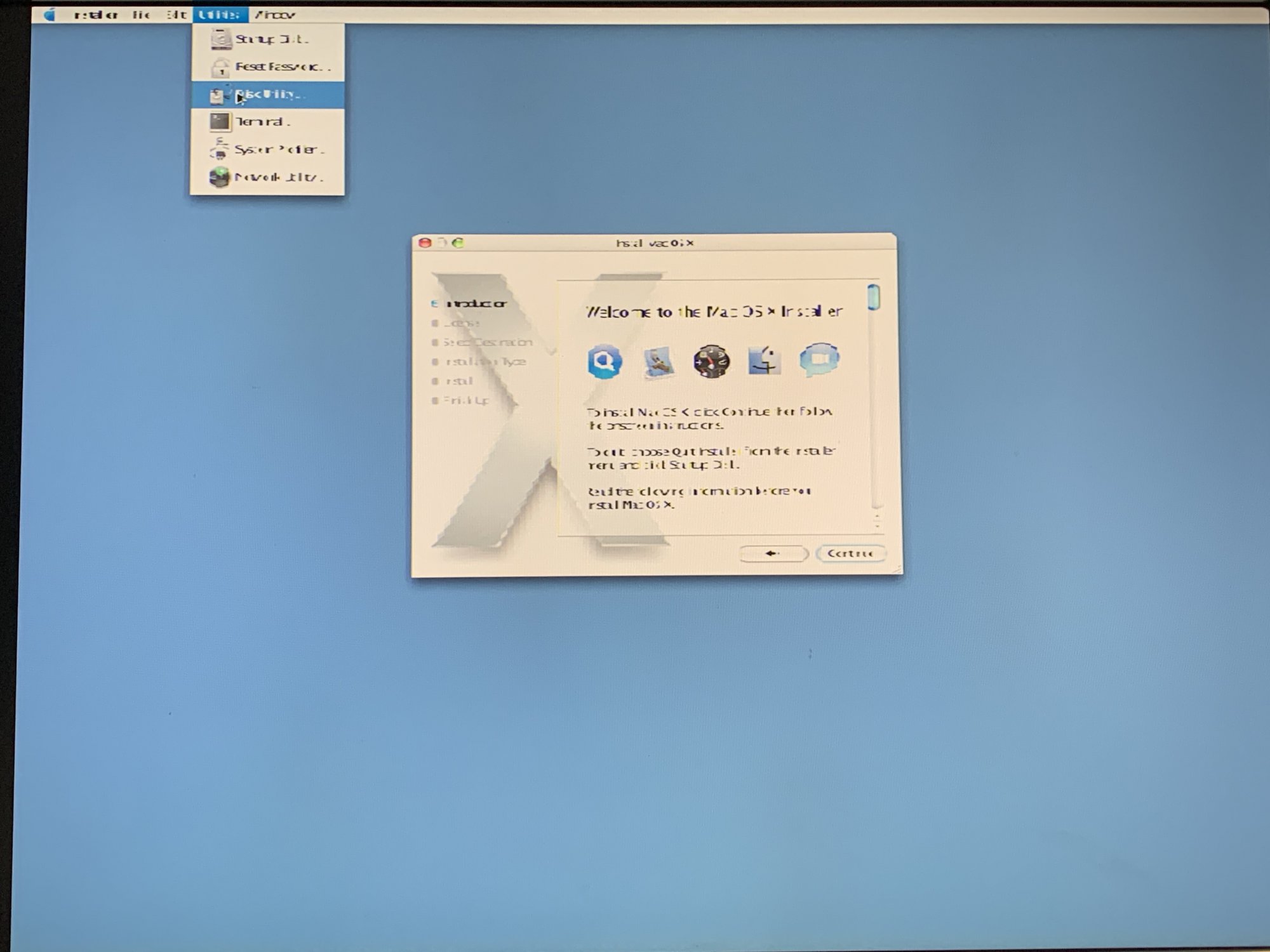

I swapped the 300GB HDD from my other mini G4, and all is well. But when I boot the Mac, in either Tiger or Ross's Mac OS 9 CD, the display becomes crap, i.e., both my Dell monitors only show half of the horizontal resolution.
I can install Tiger blindly and eventually set the resolution to 1368x768, which is workable. But any cold boot will halve the horizontal resolution and make the display unreadable. I even brought out the 2707 monitor to see if it would allow me to get the installation done, but it shows the exact same problem.
Somehow, at one point it seems to boot fine (see screenshot), but when you need to decide something such as where to install the OS, the screen becomes unreadable. I can't seem to be able to install any external app to fix things, so this issue must be related to the Mac itself, but where?
HELP!
Mine does the same with the IBM Bertha. The screen is garbled during boot-up but fine once the OS X GUI loads. And on OS 9, I can only get half the horizontal resolution.

I asked the previous owner about this, and he's had no issues, though he used an HDMI adapter, while I am using a DVI-DVI cable. I'll have to get another cable and see if anything changes.

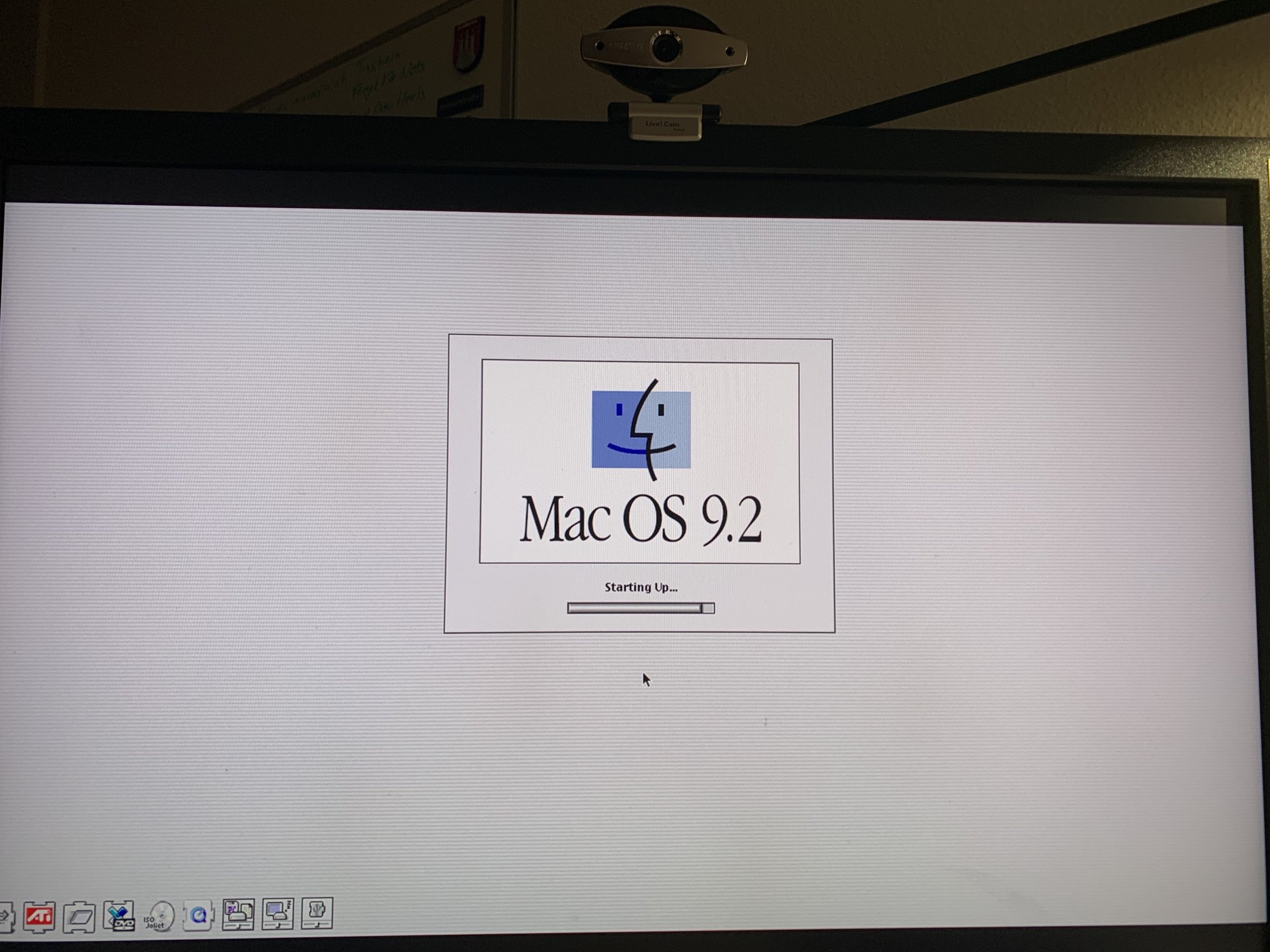

I bought a DVI-HDMI cable, and my Dell monitor works without a hitch on both Tiger and OS 9.2.2 @ 1920x1200@60 on my first mini G4, the 1.25GHz one.
Ironically, my 1.33 GHz one experiences drop-outs at 1920×1200@60Hz via a DVI-HDMI cable.
Somewhere in all the pages I consulted to better understand what could be causing the half-resolution problem, I found that, while the Radeon 9200 graphics chip has the same architecture in all models, there are subtle differences, which would explain why a 1.25GHz model doesn't have issues, while a 1.33GHz model does (or vice-versa).
