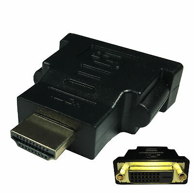

Or were you thinking of something like this instead?

Yeah I was thinking of one of those. I've got one, it worked on my 2009 Mini, Haven't tried it on the G4 though. DVI and HDMI are literally the same thing, so it should work. And if it doesn't, I'd suspect its something weird with the cable.
My issue with VGA is most likely that the analog pins on the Mac are bad for whatever reason. HDMI however uses the same digital connection DVI does. If you can output DVI, you should be able to output HDMI.
