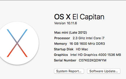

My Mac Mini is getting warm, perhaps too warm, and I don’t know what to do. I have of course, backed up yesterday. Never have even looked under the hood.

your machine is 7 years old by now and (depending on the total uptime) I well can imagine that some dust has accumulated within the cooling system over the years
What are you doing with it? Is it getting warm just sitting there idling or during heavy duty processing (which would be normal for an i7)
is it just hot to the touch or throttling or even unexpectedly shutting down? (one pc shut down on me over and over again until I discovered the cooling fan had died)
My 2014 Mac mini gets quite warm under normal usage too which may be attributed partly to Apple's obsession with silent systems, so the cooling fan runs at minimum speed ...
Open up the bottom, and point a shop-vac set to blow on it. Continue until most of the dust is gone. If the fan is centrifugal type, where air is sucked into center holes, and accelerated out along curving fins, use air on the fins to drive the thing backwards. That'll loosen crud stuck to leading edge of fan blades near center.
