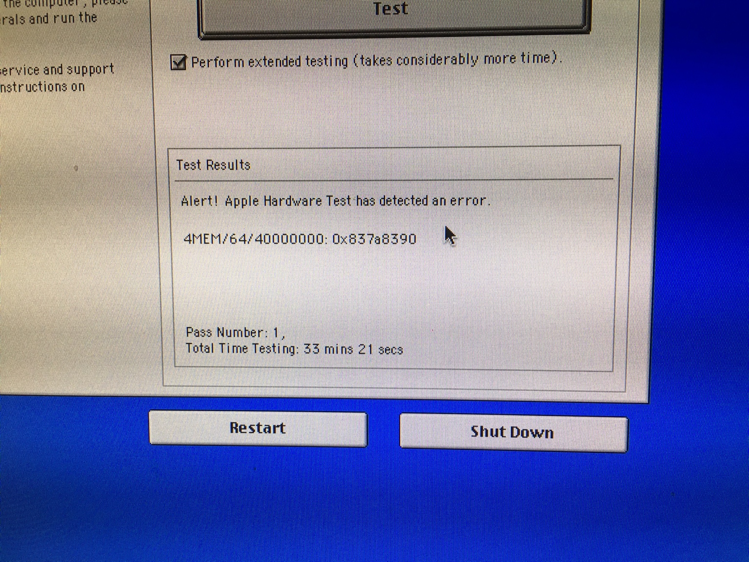

My wife 2011 mini is getting so slow it may just lock up I reinstalled the newest os and it did jot help I plugged in a USB drive and used recovery to install what ended up as lion on it seemed to run well till I updated it when I ran diagnostics I got this error. I have a spare 8 gigs of memory I can swap out.
Yeah, that's a memory error alright. You might try re-seating the memory modules to see if that fixes the problem, but most likely, you'll need to figure out which module is bad and have it replaced. (Bad memory can cause all sorts of problems when running the machine...)

Should not be a problem, if it was the same kind of Mini. The 2011 uses 1333 MHz (or faster) DDR3 SDRAM SO-DIMM modules, so memory from a 2011 or 2012 Mini should work. Not sure if RAM from an older Mini would be compatible...
well the memory helped some but it still has problems. but it may be ok to use. I wiped the internal drive and restored it from time machine.
Memtest86, run from its own boot device, is a great way to check for memory problems.
