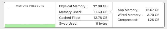

Here is a screen grab of the my RAM usage at steady state:

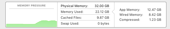

Now after initiating Launchpad>folder within Launchpad. The hump in RAM use is when I started entering/exiting Launchpad multiple times (key F4):
I don't have any swaps because I have plenty of free RAM (now), but you can see that wired RAM usage went up by more ~5 GB. Before the RAM upgrade this task led to UI of around 1 frame per second doing the same animation due to swaps to the SSD. So I suspect the same problem may be happening during video playback.

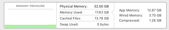

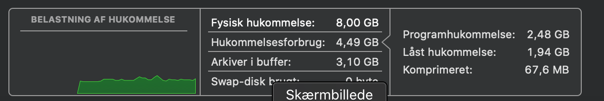

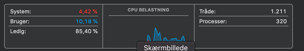

@iluvmacs99 likely has the correct answers, but I'm still interested in whether with 8GB RAM and 4GB usage you have any swaps to disk recorded in activity monitor?
This is when I play a 1080p MKV file with VLC having hardware accelerator enabled in VLC player.
