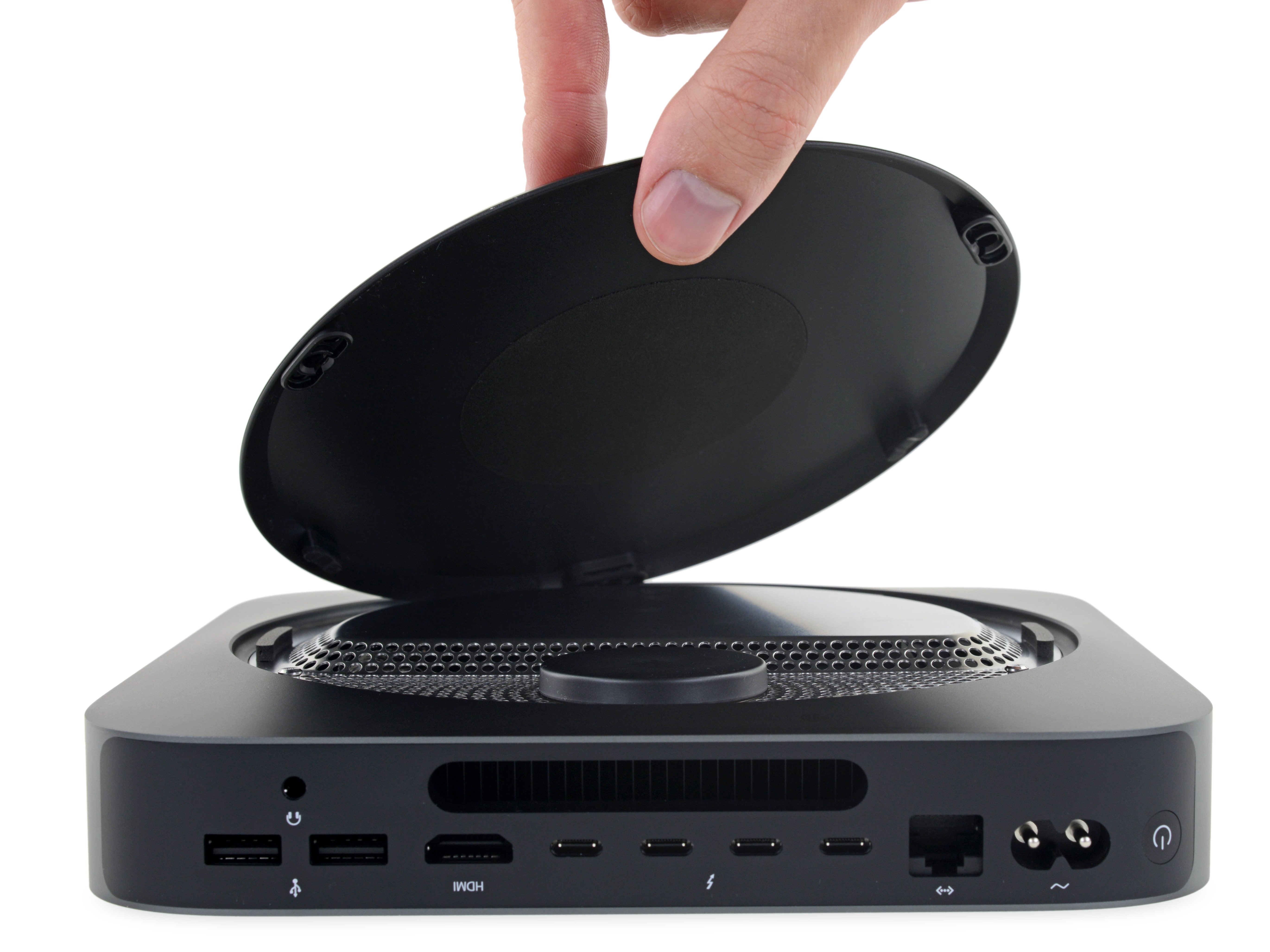

One more suggestion from me:
The mini is getting really hot. I even have it on a trivet to allow air flow
Have you ever checked for dust inside the machine?
Opening the bottom cover is easy and cleaning out the dust might help with the temperature. (While you are waiting for your new mac.)
You can use any Flathead Screwdriver.
No dust. I was reminded of when I first got it the mini would get hot. So much so that I placed the thermometer gun near the computer. And I bought the trivet to put it on. Geez, even using the mini now I had to replug the keyboard a couple times to get things working. The new mini has left Alaska. Hopefully it will get to Knoxville soon.
