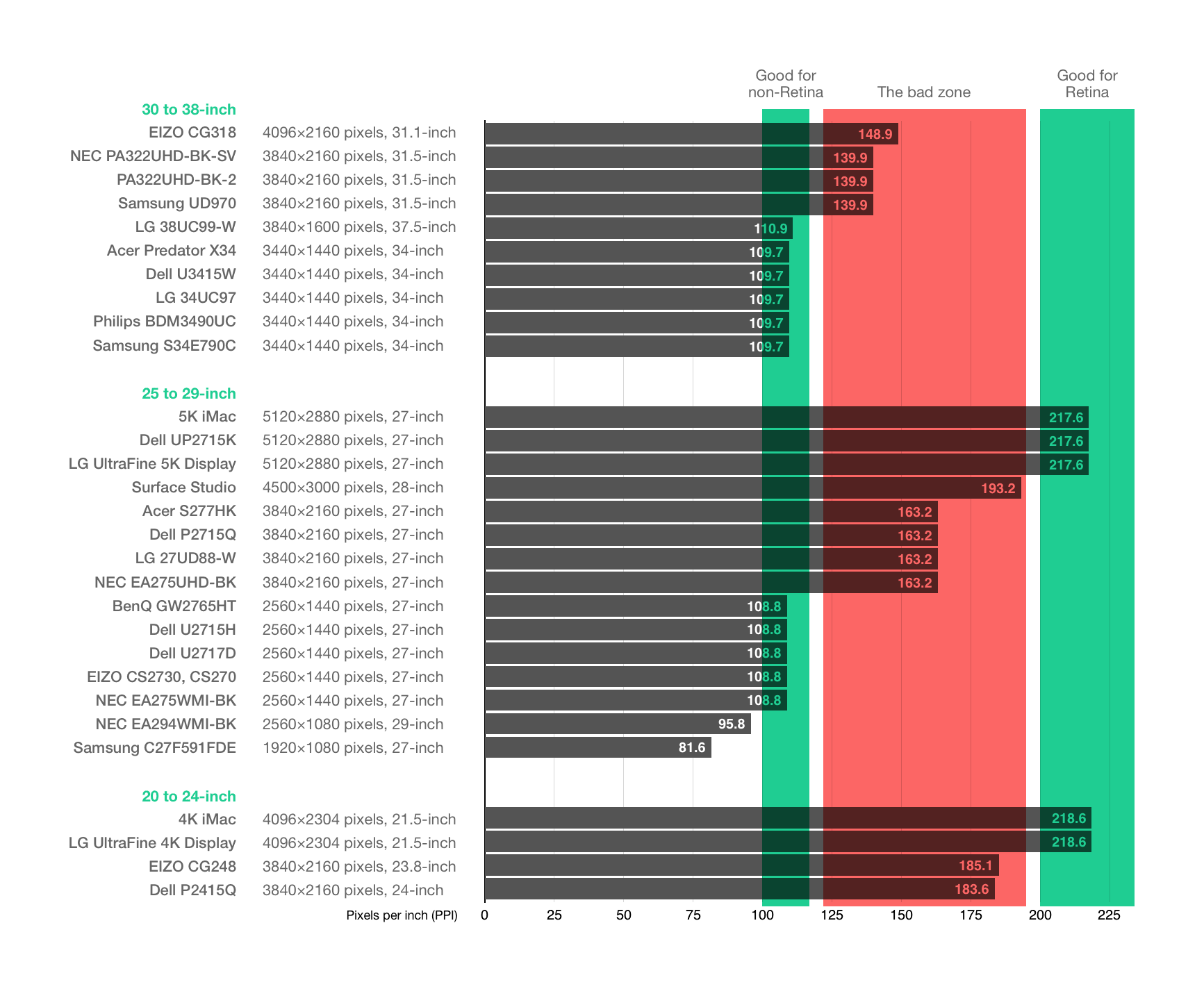

32 inch 4k looks terrible. here's a chart to help you

OK, so if I understand this correctly this chart applies when running the display at full 4K resolution. But as that’s what I intend to do at a later stage, this display is not ideal for MacOS, right ? Can you explain why or where this graph is taken from?
this chart gives you an idea how will things look in different modes

not exactly
This chart shows you different sizes and their resolution and how they would look like in native resolution (non retina) or retina (scaled 2x)
Everything else in between looks bad. As you can see, 4K looks good scaled 2x only on 21 inches. (If you were to run in native 4K, you wouldn’t be able to see anything, too small)
For the 27 inch a good resolution is either 1440p (native, which will look similarly to 1080 on 24 inch, but more screen real estate) or 5K, which is double 1440p, scaled 2x, so effectively you get 1440p but super sharp, because you have double the pixels. That’s what makes it retina.
5K monitors are super expensive.
4K 21 inch monitors are difficult to find , and who wants a 21 inch monitor anymore anyway ....
That otherwise useful chart is misleading in that it does not factor in viewing distance.
Also what Fishrrman said about age and vision status. The absolute size of the text matters too, not just how crisp it is ('retina'). I used to be able to work with a 1440 27" screen. But now I have to use 1080 for 27".
