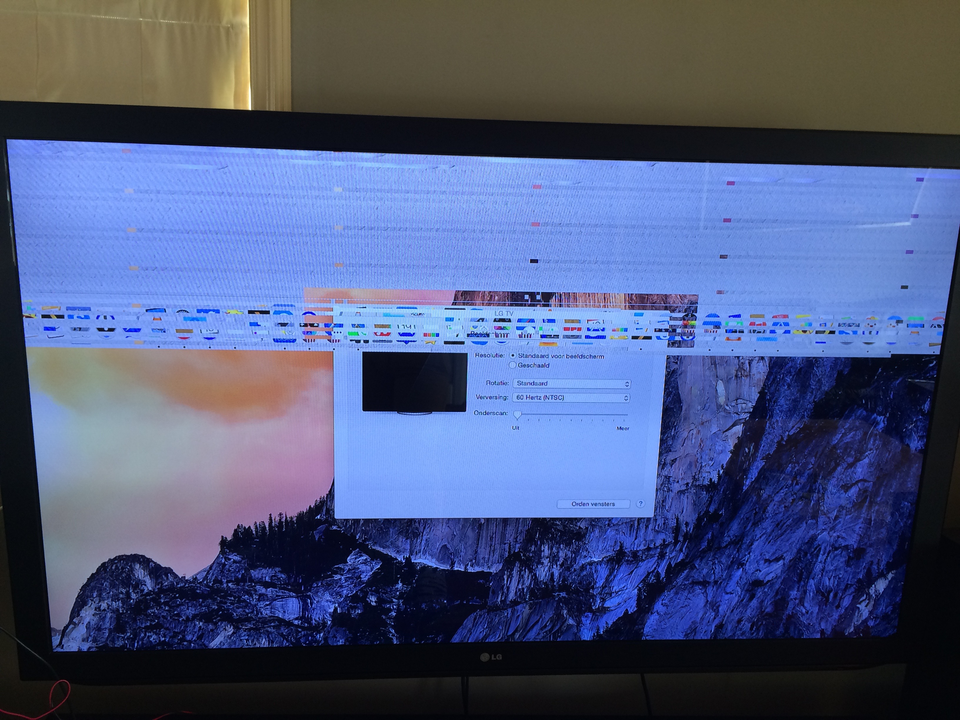

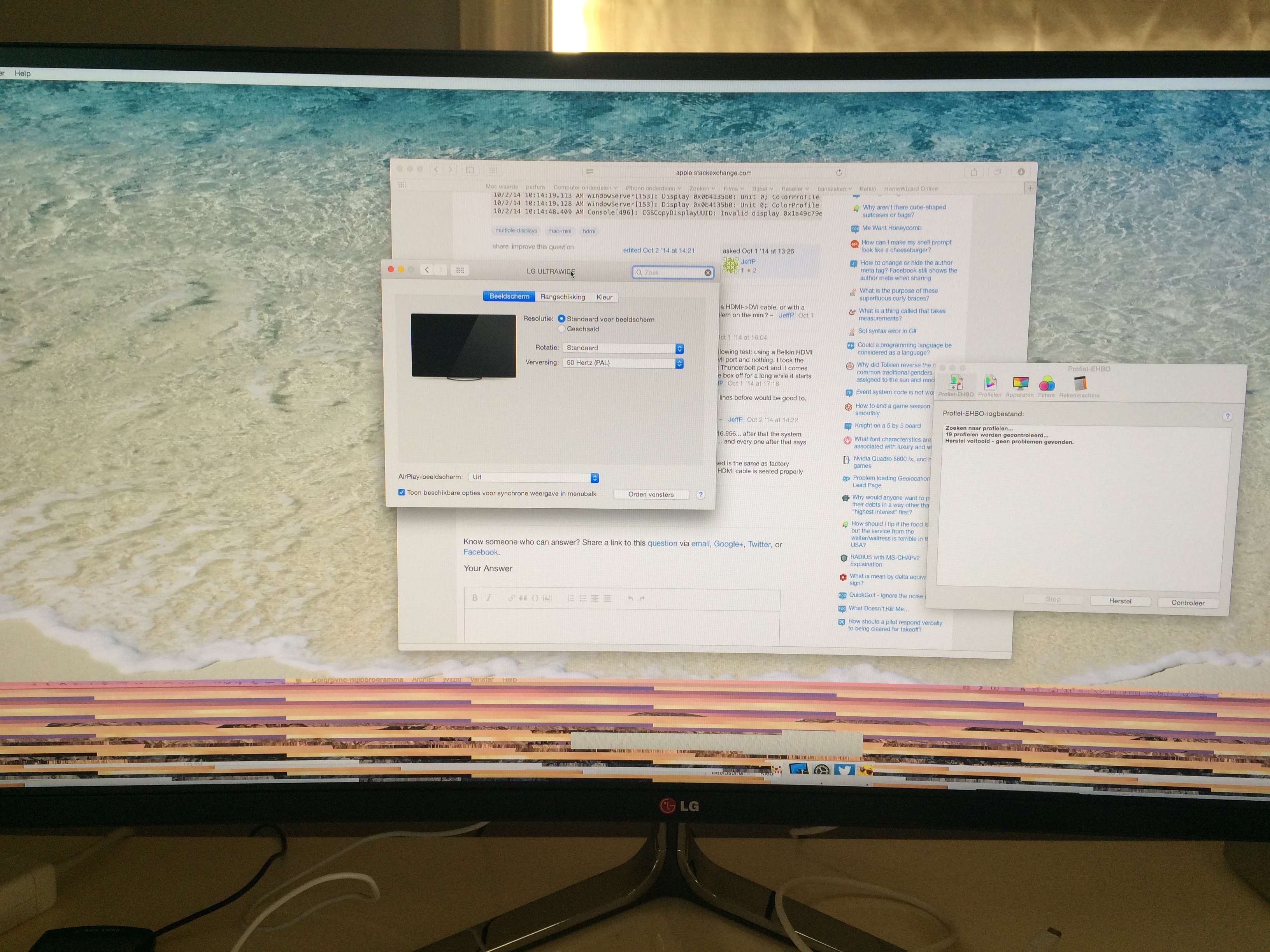

Hi there,
I have an Mac mini (model late 2012) and an LG 34 inch display and an LG 65 inch TV. Ive tried to connect them both on my Mac mini but it doesnt seem to work correct. What ive tried is:
1. Connect the LG 34 inch display with a thunderbolt cable from the thunderbolt port of the mac mini to the thunderbolt port of the LG display (works perfectly)
2. Connect the LG TV to the HDMI port of the Mac mini (works perfectly)
Then i want to use the tv as a second monitor and connect them both at the same time. Then both screens start to flicker and flash heavily but just a part of both screens. The top part of the TV and the bottom part of the 34 inch monitor.
I also have a LaCie Big disk with 2 thunderbolt ports so i tried to daisy chain both screens. Thunderbolt cable from mac mini to LG monitor, thunderbolt cable from LG monitor to LaCie and mini displayport adapter to HDMI from the Lacie to the LG TV. But its exactly the same problem. Ive searched a lot for a solution but i cant find one. Changed my color profiles, looked ad my spaces in Mission control, reset the VRAM mem of the macmini, booted in safe mode. Nothing seems to help. Hope someone has the solution for me. Thanks in advance

Jep i do have an other monitor, just a small 15 inch one. I connected it and your right, no trouble at all. Maybe the resolution is just to high for the mac mini? Cause when i use "Mirror displays" its working fine and using the resolution of the tv.
I was thinking maybe its the complete different ratio of both screens that cause the problem? It looks like the tv is showing a part of the dock of the main monitor...

@paulrbeers: thanks, i tried different settings on my tv, even as low as 1600x900 but that does not change anything. Then i tried to change the settings of my monitor and as soon as i put it on a resolution of 2048x858 everything is fine and works perfectly, even if the tv on 1080p. As soon as i change my resolution to something higher then 2048x858 it start to get bad again.

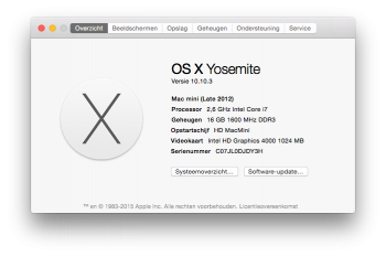

@ Fishrrman: i have 16GB of ram, the max for this mac mini (see screenshot)
@D.T.: 16GB of ram, so i cant add anymore
