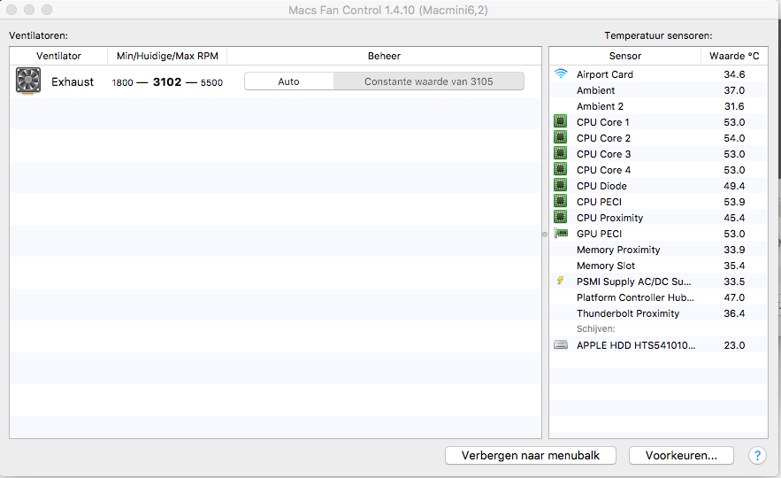

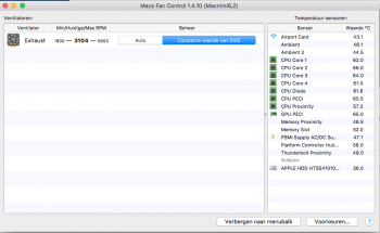

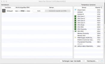

Thanks for your replies. I ran the AHT straight a failure last night, no errors detected. I installed Mac Fans control and raised the fan speed to 3000rpm. See the screenshots attached. The Mini didn't fail over night and the temperatures where lower. But I am not sure if this is the way to go. I just set the fan speed back to auto and see what happens during the day. So far I have been able to reply to this thread without failing 🙂

Very unlikely that third party RAM is going to cause an overheating issue. In my 10+ years of supporting and upgrading Mac Mini's (from the Core Duo to now), I've yet to see third party RAM (Crucial, OWC, etc) cause a Mac Mini to overheat. It is more than likely an issue with the following: Fan itself is starting to fail, SMC, PRAM, and/or an issue related to a corrupt EFI.

p.s. it looks like that the 3000rpm setting is working, the memory temperature stays around 50 Celsius.
