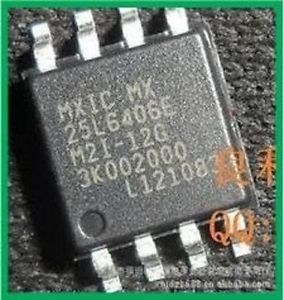

The ROM chip is a standard 8-pin SPI. It looks something like this:
I don't know where it is, so you'll have to look around for it or PM someone else who has already found it. According to this thread where someone found it, it has model number MX25L6406E on it.

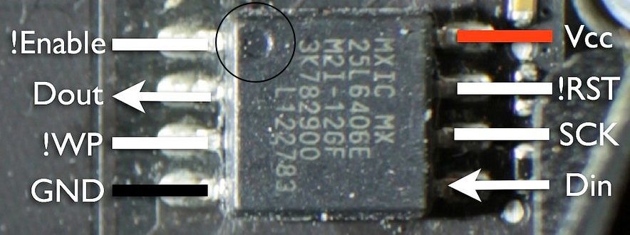

I found a picture of the pinout for this chip. I cannot verify if it is accurate or not:
In a nutshell, what you need to do is short ground pin (black) to VCC pin (red) prior to startup. This shorts the power, preventing the ROM from being read. (Get your bearing for the pins by finding the circular indent near the corner, which is circled in the above image.)
Being unable to read the ROM should hopefully cause the computer to use the failsafe ROM instead. Then after bootup, remove the short prior to flashing so that the communication is enabled again. Run Apple's firmware updater.
