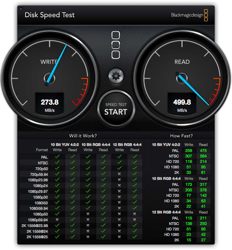

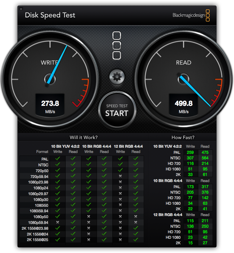

Unfortunately I don't have access to another SSD and I don't really want to open up my Mini again 😱. I am aware of the issue this drive had and have done the update since the release of the new firmware.
So, the SSD itself didn't get slower?
(Benchmark results?)
Only the boot-process itself is "slow" now?
I don't have a benchmark before and an after.. but here's one from Blackmagic Speed test with 1GB size test... (sorry I don't know which tool to use since I rarely run benchmarks...)
The benchmark speeds above look to be excellent.
I wonder if something else is causing the slow boot problems.
You've probably already done this, but have you opened the Startup Disk preference pane and "re-touched" your settings?
Have you got any add-ons like dropbox etc ? Could be they are communicating with external servers and causing a delay/hang ?
