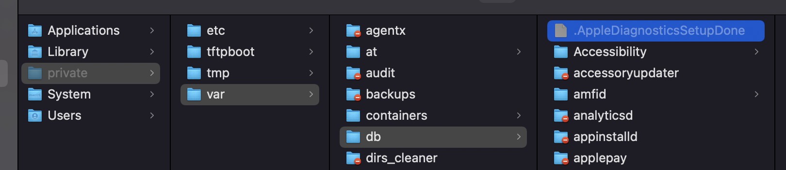

There is (was...) a script that runs on new Macs that will be triggered if a preference file does NOT exist. Successfully running the setup triggers a preference file to be written. Pulling this preference file (changing it, or perhaps corrupting it) would cause the setup script to run on restart.
Never heard of a Mac losing this file without somebody manually deleting it...
I see the file on this M1 MBP, so it looks like it is still how triggering the setup guide is managed. Seems like something is deleting or corrupting this file.
