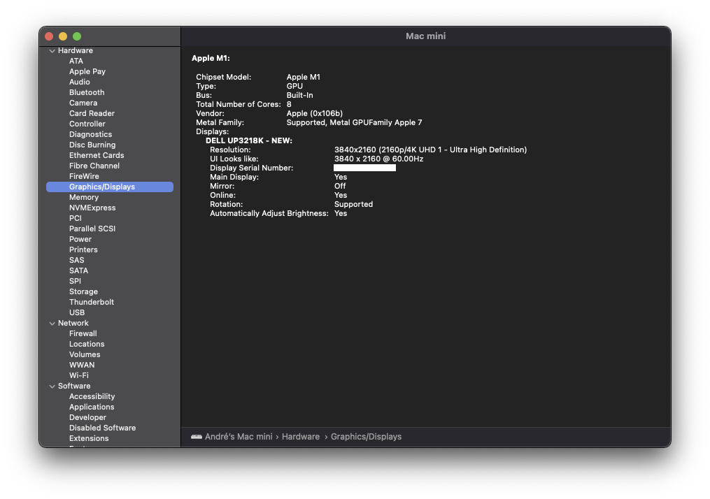

UPDATE: The monitor res is being reported by MacOS as 3840x2160 in the display section of 'About This Mac' on the M1, whereas on the Intel Mac mini shows it as 5120x2880. Assume it's running the monitor at 3840 but scaling to look like 2560 which is why it looks reasonable but not crisp...
I think the 11.1 update and SwitchresX (to select the resolution) has done the trick... I'm up and running at 2560x1440 scaled (hidpi) @ 60hz on USB-C -> DP.

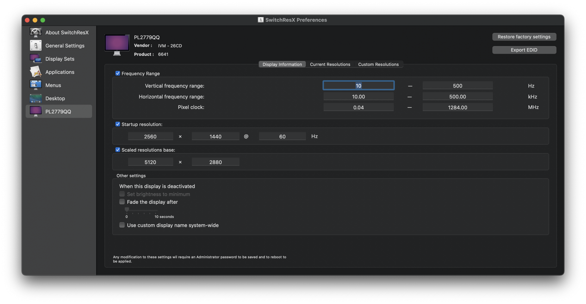

Solution...!
I noticed on the Intel Mini that there were overrides set on the 'Display Information' screen of SwitchResX for the monitor (I hadn't set them so assume they were system generated?), whereas these weren't enabled on the M1, so I took a punt and copied them over and we're up and running at full res!
Here are the settings:
"About this Mac" now sees the screen at 5120x2880. When scaled to 2560x1440 @ 60hz, everything is as crisp as the Intel mini thru eGPU and a reference 5k iMac.
I'm not qualified to say why the manual settings are necessary (@joevt not sure if you can shed some light?) but doing the MacOS update and making the manual changes has solved the issue. Also just to confirm that it works with both direct USB-C -> DP cable and through a USB-C -> DP adaptor, with DP-DP cable.
So you changed the Frequency Range settings so that the 5K timing gets promoted and becomes usable? Can you show ioreg.pl output that goes with these changes?
You see in the list of timings that 5K requires 60Hz vertical frequency, 177Hz horizontal frequency, and 968MHz pixel clock. What was the Frequency Range settings previously? If we know that then we can guess how they were determined.

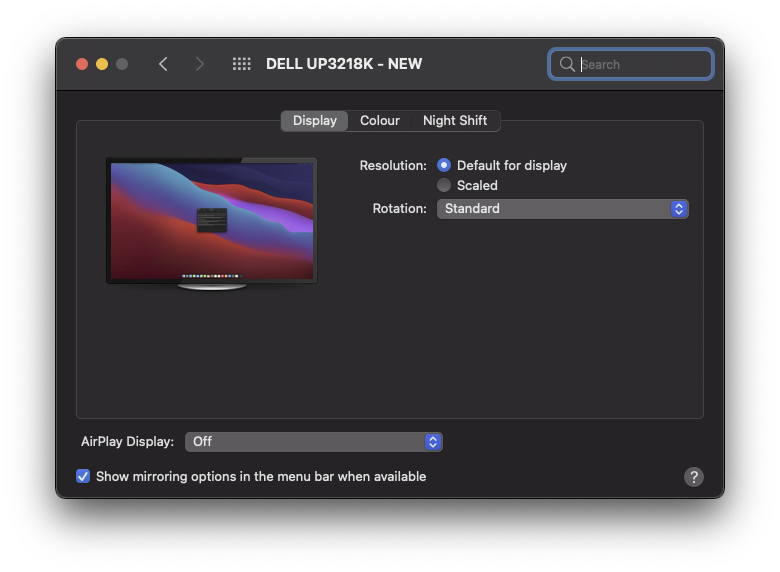

Yeah, I took the override file from my Mac Pro named by SwitchResX (DisplayYearManufacture-2018-DisplayWeekManufacture-39) and put it in /Library/Displays/Contents/Resources/Overrides/DisplayVendorID-10ac and DisplayVendorID-90ac to no effect.
I also tried copying the data over in nano through terminal.
I cannot delete files in the /system folder due to the new read-only nature of the Big Sur filesystem. I had to delete the DisplayVendorID-4147 file in the system folder on prior versions of MacOS to expose the single cable 8K@30Hz resolution. Weirdly enough I can't set the resolution to 3840x4320 in Mojave for example.
If I do it on Big Sur on the M1 I get a funky green dancing bar at the top.
Can you at least get the display name to change? That would at least prove the system is looking at the file and using some of its information.
I wonder if there's a 4096 height limit or related bug on M1 Mac...
Yeah, it does change the name system-wide.
