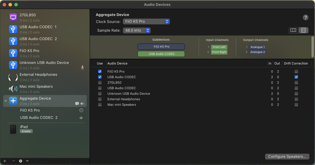

Have you tried looking around in Audio MIDI Setup, in the Utilities folder? It has some routing options, including something called “aggregate devices.”
Reactions: NSMacGuru
Thanks for the idea. I have never used this before so maybe I'm using it incorrectly. It seems like when I select my external dac and the USB Audio CODEC (with inputs), nothing happens when I listen to the aggregate device. I heard the normal system sound fine, but nothing comes from the USB input. If I open QuickTime Player as mentioned in my previous post - no problem.
So, either I'm doing something wrong with the Midi Setup app or the app just isn't capable of passing through the audio in the same way. I'm hoping it's my error because this seems like a more elegant solution.
I believe devices are as follows:
USB Audio CODEC 1 = Behringer outputs
USB Audio CODEC 2 = Behringer input (into the Mac I assume)
FiiO K5 Pro = External DAC
Unknown USB Audio Device = Logitech webcam mic

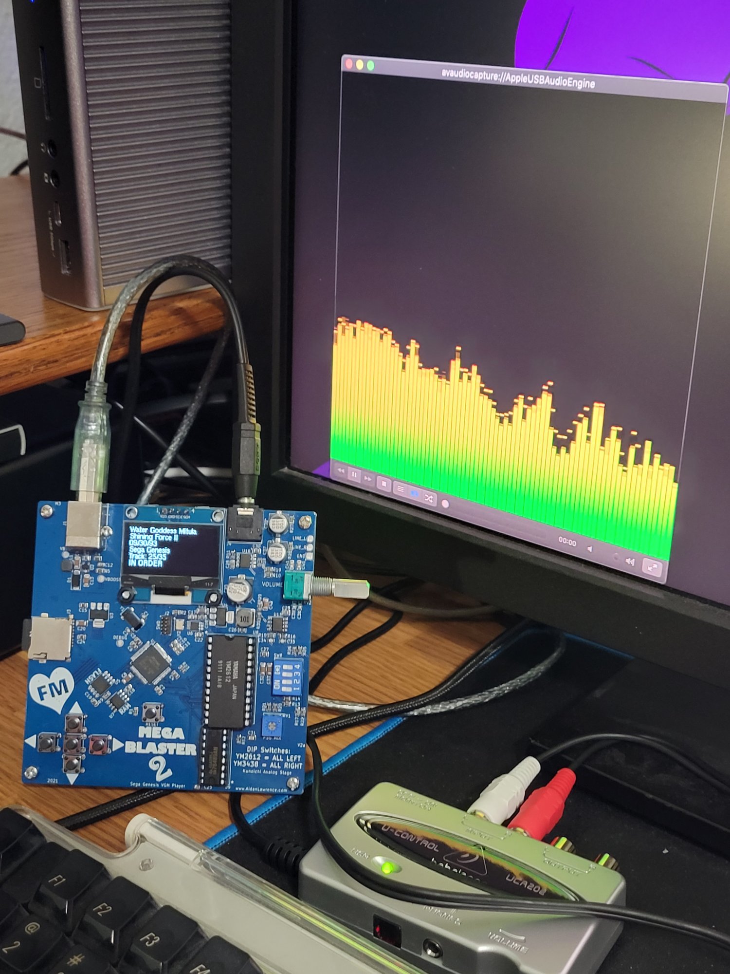

I have a UCA202 that I use a pass through for my MEGA BLASTER 2 FM device. I've been unable to find a suitable easy 1 click method of getting the audio in so I've been using VLC and using the capture audio option.
Works well but it is annoying to have to do this to get multiple audio playing at once.
I'll try the Quicktime method when later, I do like being a nerd and seeing the waveforms though lol.
