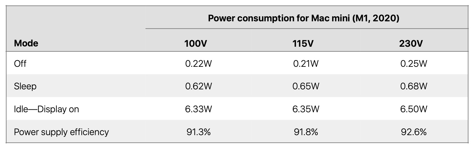

The thing is... it should draw under 1W in sleep and it seems to be not at sleep at all (still able to ping the device) for absolutely no purpose. Even malcky77's wax warmers are drawing the energy to make him happy with a nice smell and therefore fulfill at least some kind of purpose.
I wonder if wherever that info table cable from if there an * somewhere, and then saying power draw figures based on xyz conditions.....like turning off WiFi, Bluetooth, screen sharing or whatever else can be turned off etc.

@Zappermaster So from the link you've given.....and directly above the table you posted it only has the following conditions:
  • Off: Lowest power mode of the system when Mac mini is shut down. Also referred to as Standby.
  • Sleep: Low power state that is entered automatically after 10 minutes of inactivity (default), or by selecting Sleep from the Apple menu. Wake for network access enabled. Connected to Ethernet.
  • Idle—Display on: System is on and has completed loading macOS. Connected to Ethernet.
  • Power supply efficiency: Average of the power supply’s measured efficiency when tested at 100 percent, 50 percent, and 20 percent of the power supply’s rated output power.
So for sleep......its supposed to do it automatically after 10 minutes of "inactivity" and having wake for network access enabled and be connected via ethernet.
The sceptic in me will say the "inactivity" is the gotcha in this thread......I don't know the in's and outs of it all...but I would hazard a guess that things like emails, apps installed, notifications and stuff are all doing stuff in the background that means the quoted power draw is a bit off....but that's just me.
I bet the quoted power draw figures will be on a machine that has ZERO additional apps/programmes installed, no user details configured to sync with other devices the user has.
As I say, I'm a sceptic and don't fully believe everything written in spec documents of a product, some of it just marketing fluff and other stuff is performed in laboratory conditions that are totally different from an end user.

I think for the under 1 W it would need a deeper sleep state. Maybe something that will be realized with future updates like @DeltaMac said. For now I am satisfied with the 3W average over 12h... it is not much.... but still this is accumulating with all the the Mac Mini M1 out there. It would be nice if apple could bring it down to the promised <0.7W.
Maybe deep sleep with under 1W is already working for someone out there? It could be all the software which I have installed on my mini keeping it awake. Btw. I have wake for network access enabled and and my mini is connected over ethernet with wifi disabled.
