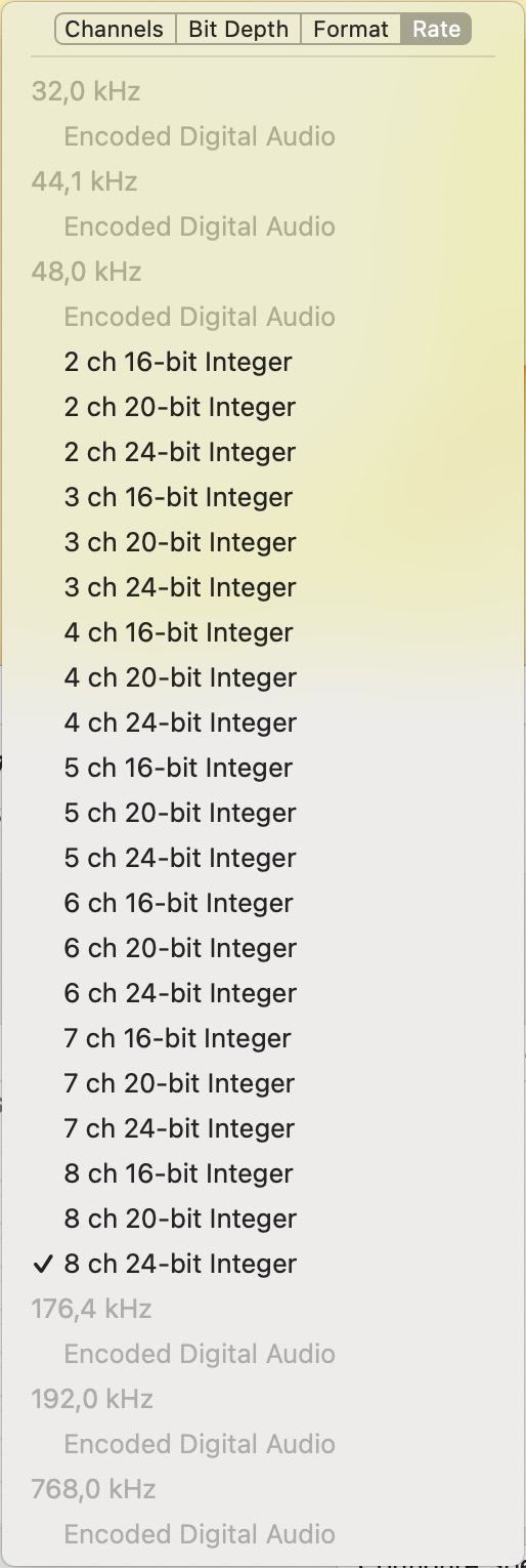

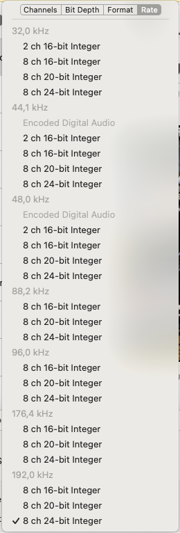

Running the same OS on both - Mac OS Monterey. It is not like the playback sample rate is locked down on the M1 mini, I can play any file. However, in the M1 Audio MIDI Setup, the only available rate is 48KHz, meaning everything is re-sampled to 48KHz, see:
M1 mini:
2014 Intel Mac mini:

My music collection is entirely Apple Music lossless or hi-res lossless, and rate varies from album to album - 44.1KHz, 48.0KHz, 96.0KHz, 176.4KHz, and 192.0KHz. This is why I have selected the highest 192KHz.
The M1 is not limiting to 48KHz based on the file played - I am trying with music that is 192KHz. It simply is a hardware limitation, and that is what this thread is all about.
Audio MIDI Setup does not react to the file played, it simply presents the available rates, which it determines by: 1) What the receiver is capable of playing/accepting; 2) What the Mac is capable of outputting.

I don't agree with you on this one, I have bolded what I don't agree with. The HDMI connection and the available rates are negotiated by the receiver and the Mac, not by the file type or the player.
Once again, the Audio MIDI Setup is a system wide setup, based on both devices connected, but it is not influenced by the type of the file played, especially for encoded audio like DD, DTS, True HD, Atmos, etc.
Both devices connected via HDMI must support the format, and only then it will appear as an option.
Try it on your Macs and tell me if Audio MIDI Setup options change based on your file format or player.
