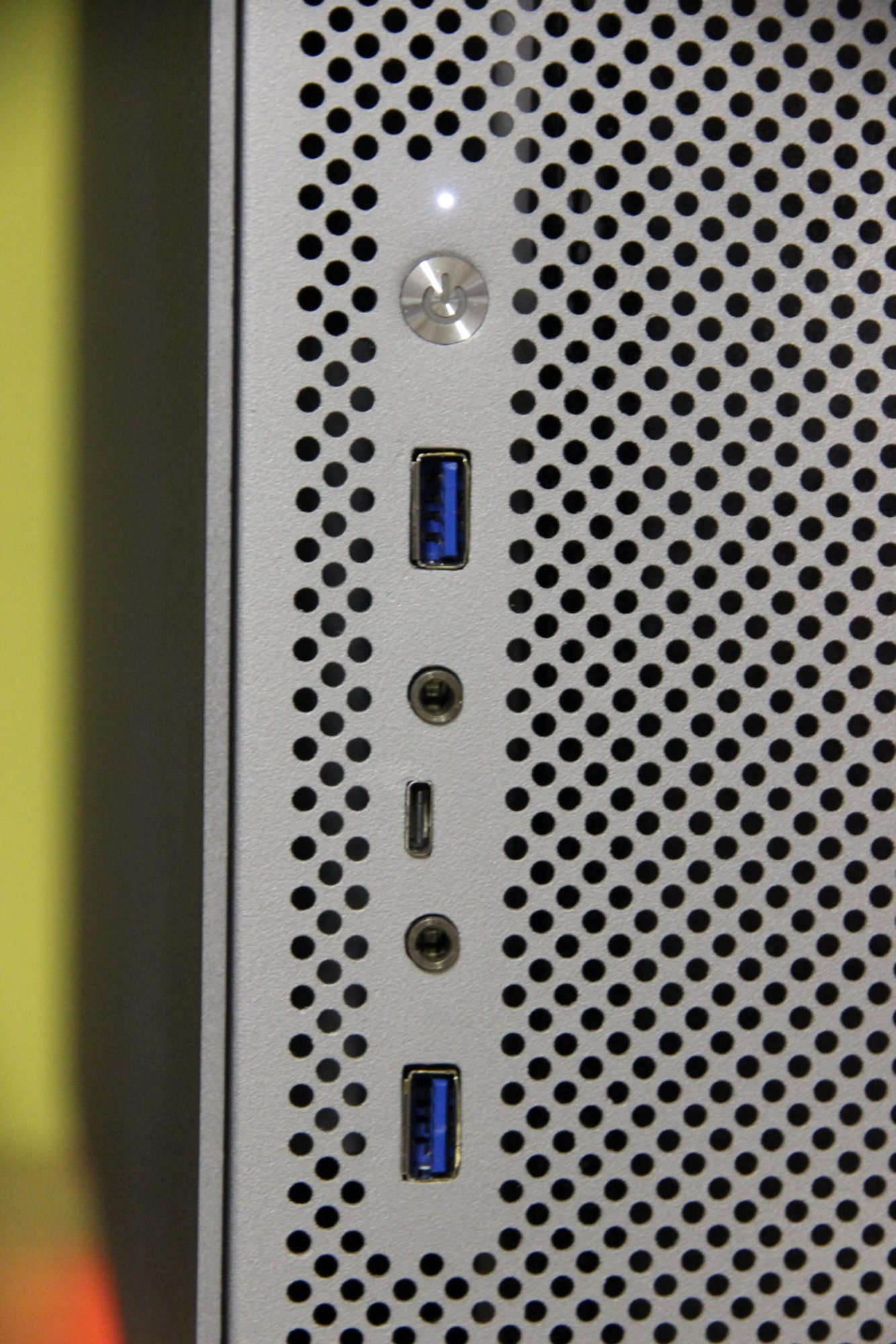

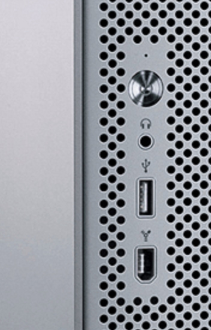

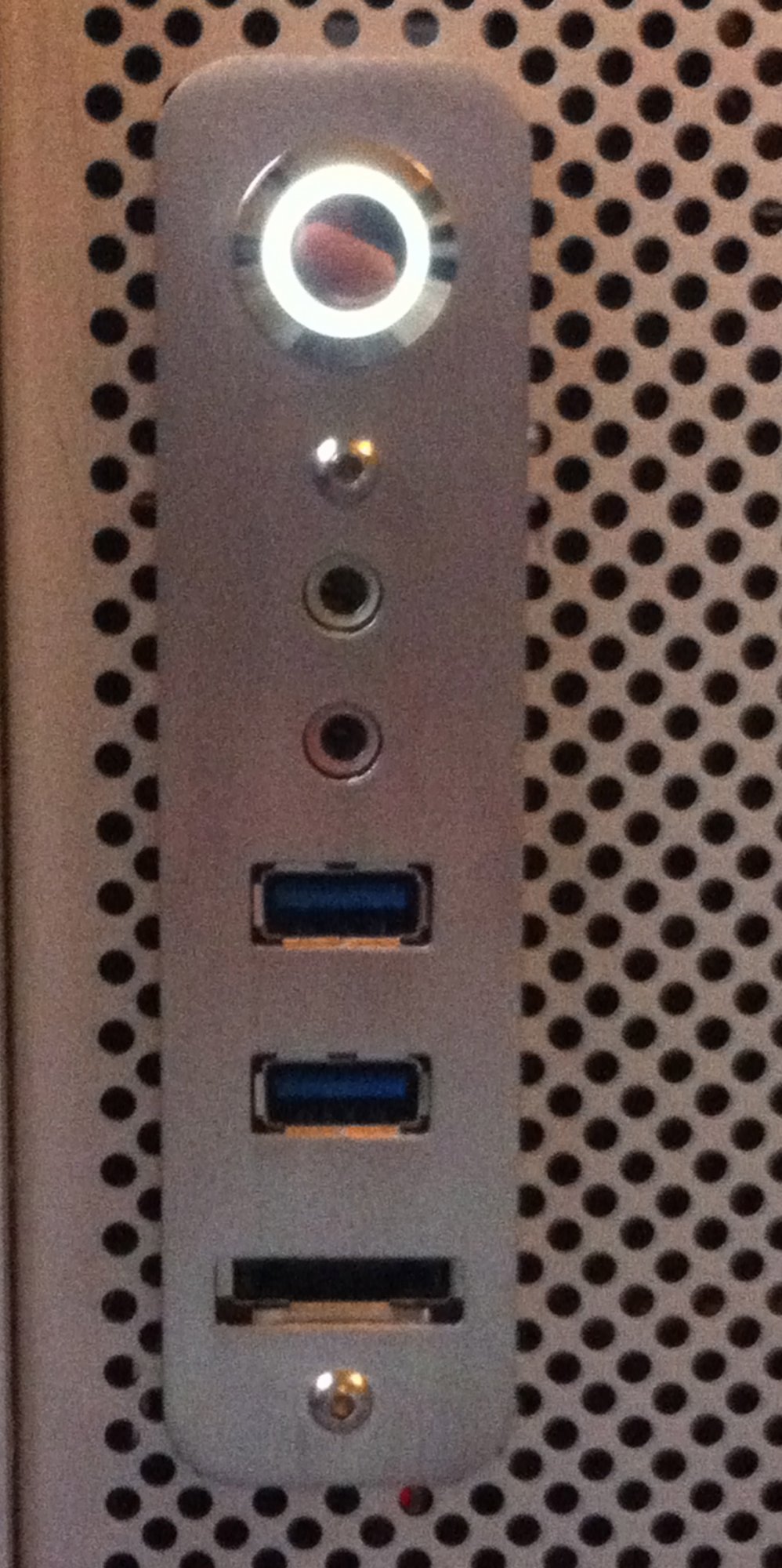

Someting like would need to be done from a purist perspective:
Powermac IO Example
Wrong:
Right (as you can see it doesn’t look perfect)

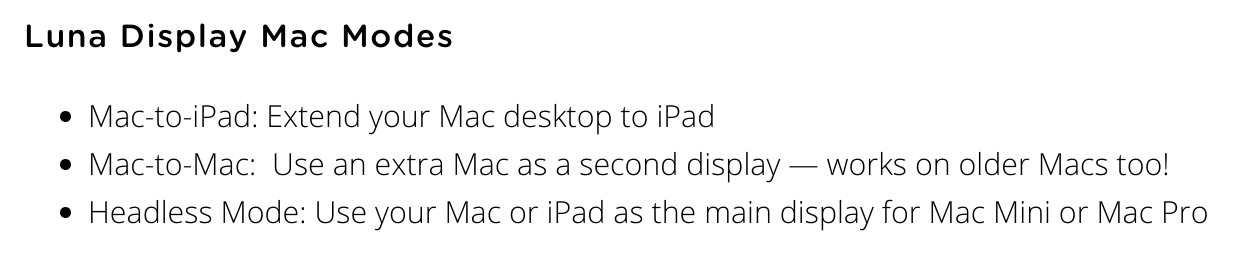

Headless mode of Luna display theoretically would fit the need - but don't want to pay 90 bucks to try it out. Can't find video reviews of anyone running an iMac 5K to know whether the solution can drive 14.7 million pixels of the iMac and without lag.
In fact there is no Retina resolution support in Luna. So kinda pointless.
