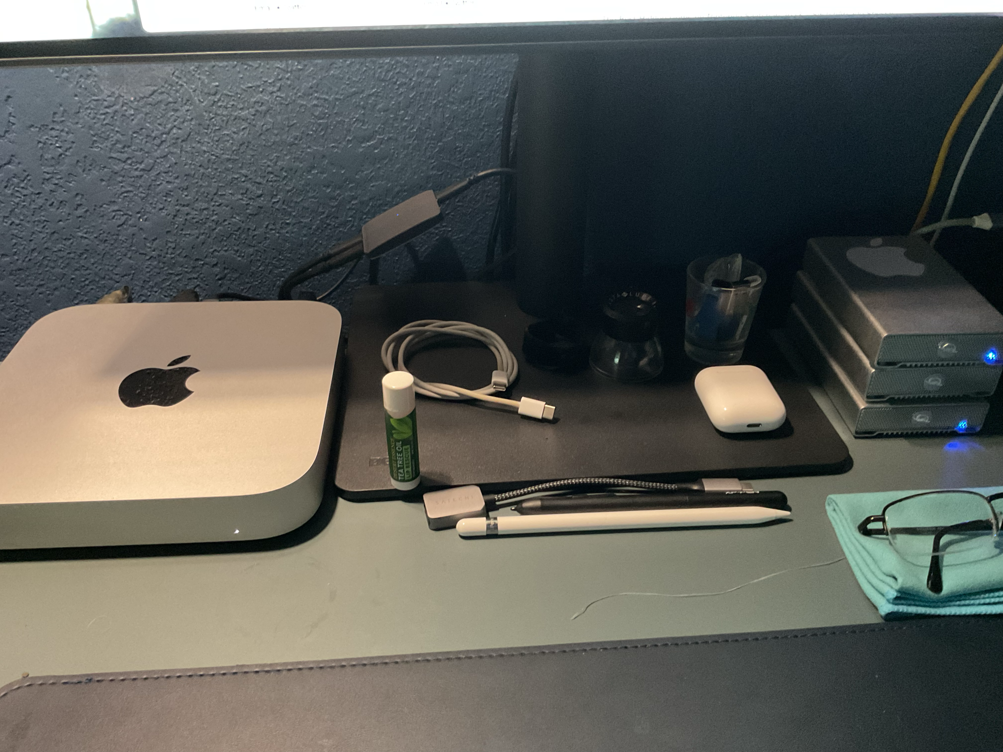

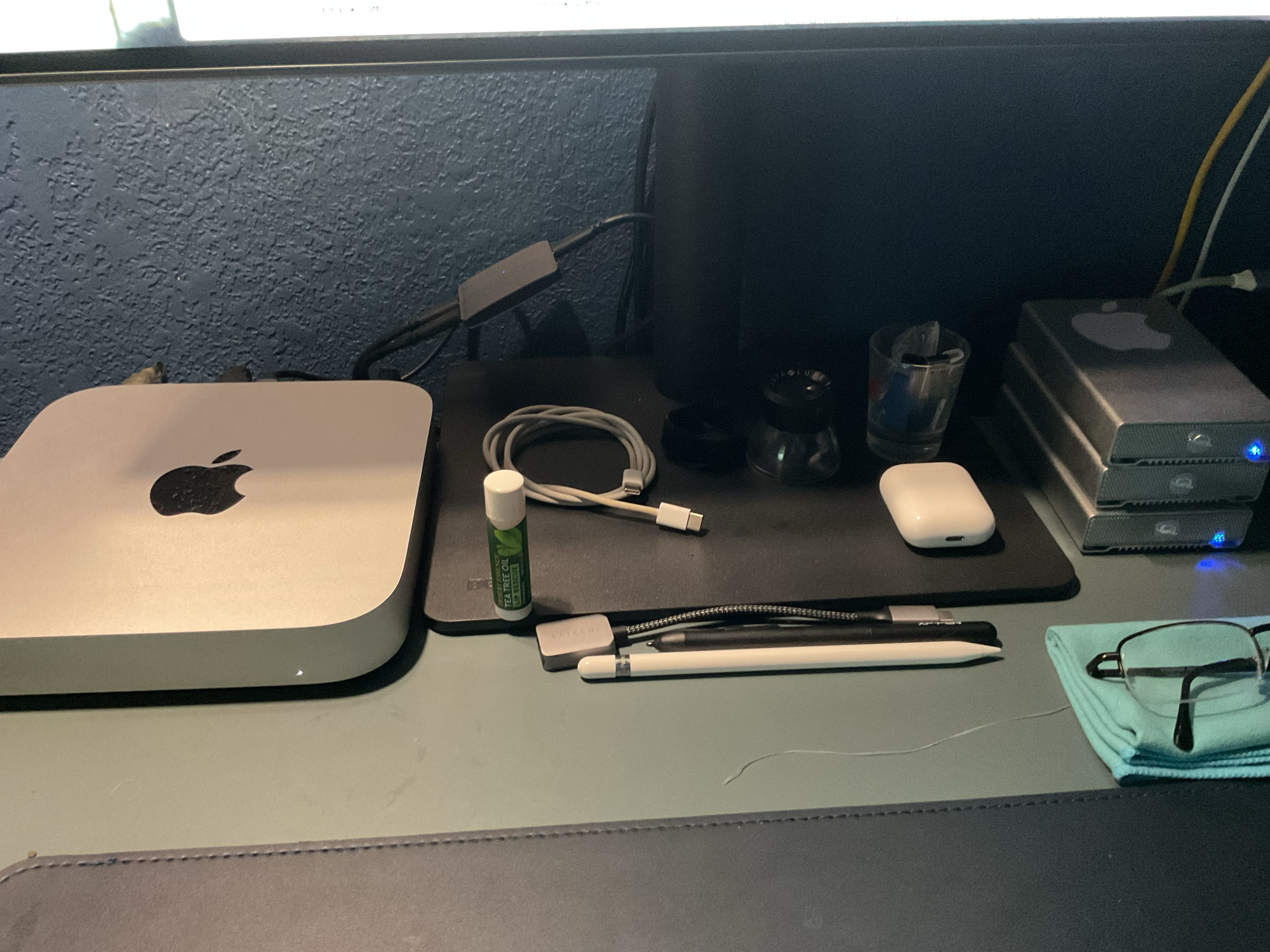

I have the same MacMini M1 that reads 3 OWC Mac sales enclosures with 2 their ssd drive and a WD ssd drive
connected to a Satechi 4-slot usbC dock, the travel one.
the write speeds are fast I just never measure them in "geek tech numbers" but I can copy paste a 5GB in seconds flat.
these M1 chips are rally great and fast!
as far as using the brand you described,
samsung and I are not friends anymore

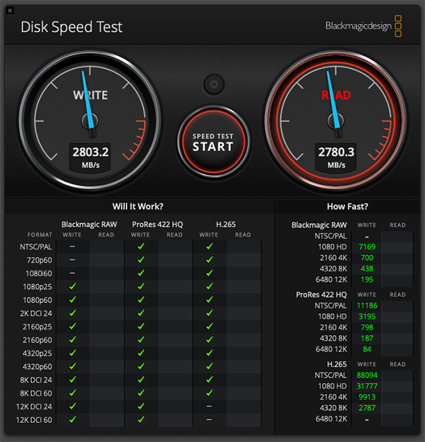

Turns out it was indeed the disk (or the incompatibility thereof). With Samsung 980 Pro 1TB I was able to get the speeds close to Mac mini's internal SSD. As a matter of fact, there is a list of recommended and not recommended disks by Orico (I can't find the link anymore) but Adata was certainly blacklisted.
