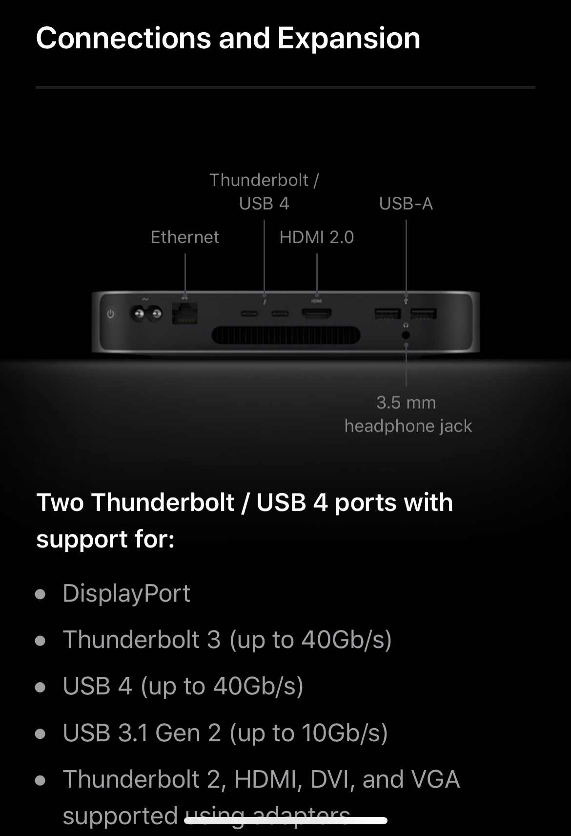

The M1 mini definitely has two USB-A ports.
Can’t help with the poster’s actual issue, though.

Ah, OK...
I was confusing that with the new iMac!
But... in any case... the recommendation for the USB "extension cable" is still valid.
