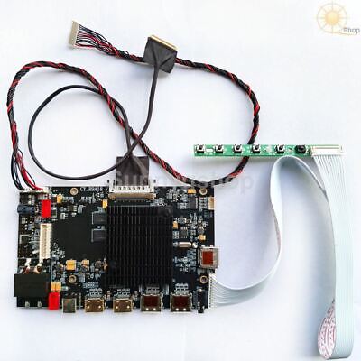

If you have a bit of DIY electronic experience you could turn your old 5K iMac into a monitor - within your budget.:
Open it up - carefully not damaging the screen 😉 - discard everything except the speakers, and fit this:
This will drive the screen and speakers.
How to do it guides are in this long thread.
My own more ambitions build is here. 🙂 I know, too much faff for most...
