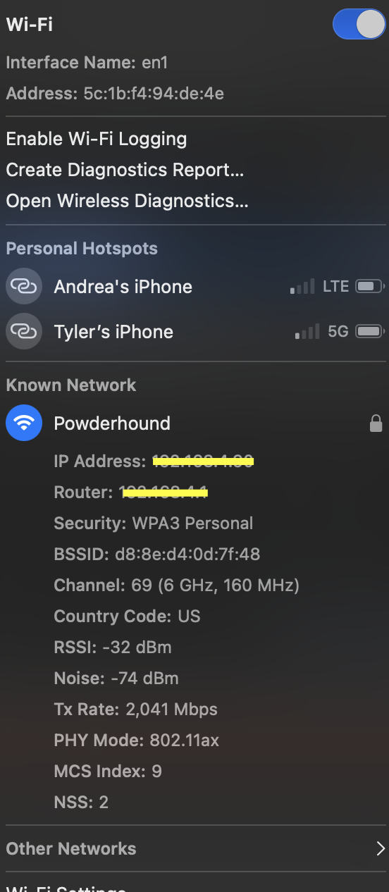

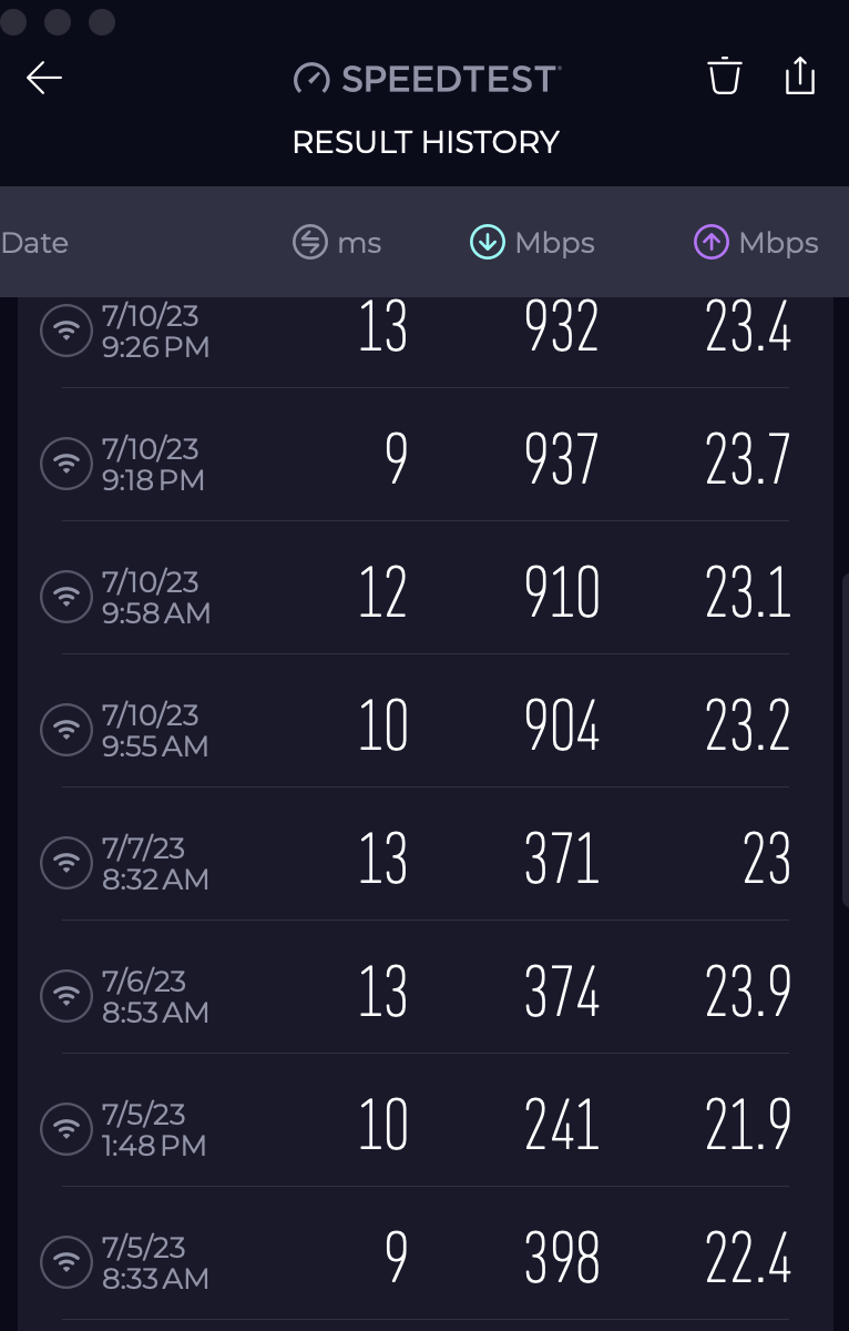

So here is how I solved it... And yes a ethernet cable would have solved its individual issue, but it still would have had sub-optimal connection speeds for things like Plex that use the home wifi network.

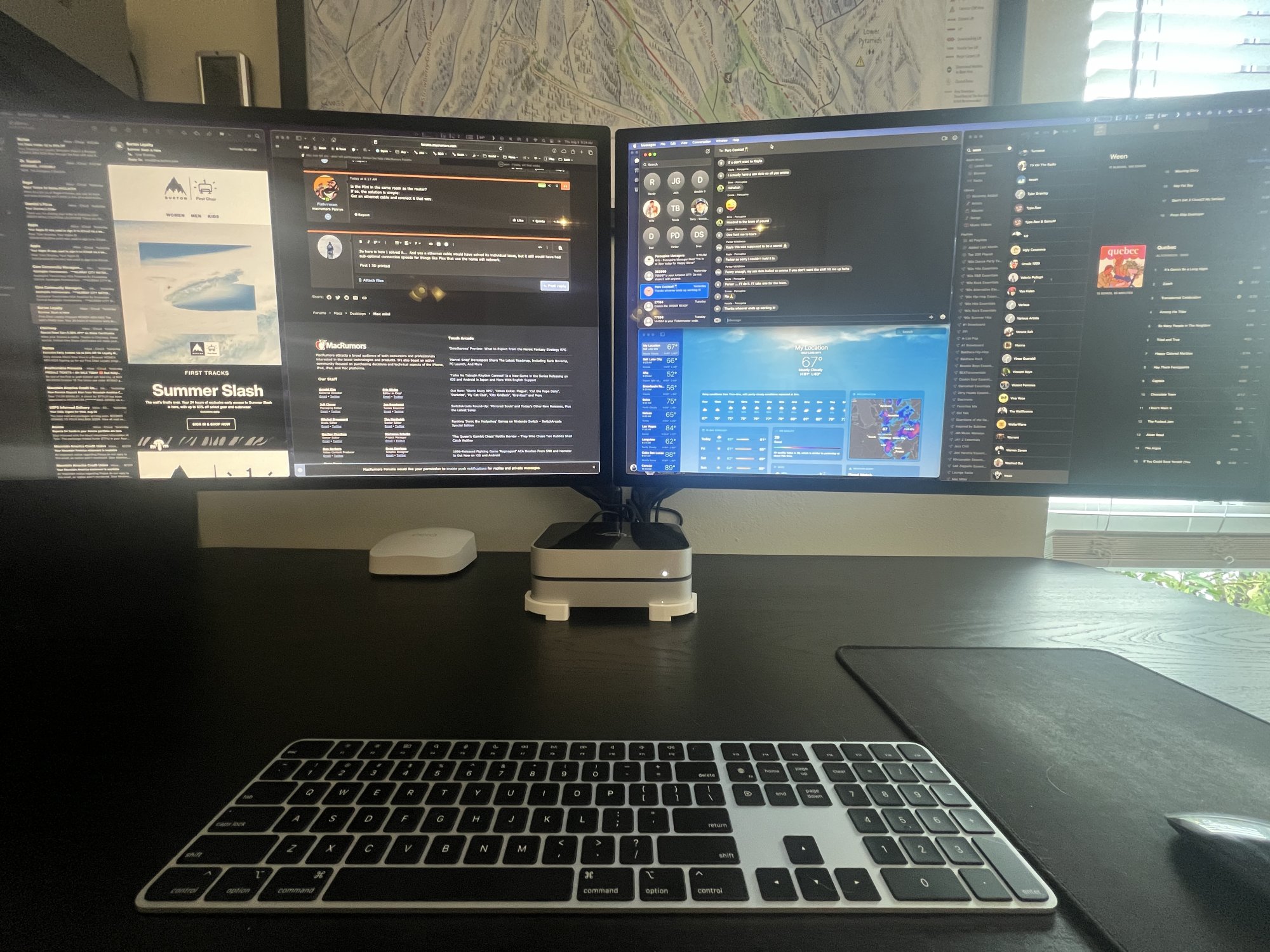

First I 3D printed some risers that I found here. That was a key to getting the antenna up off the desk surface and giving it a clear transmitting path.
Then I updated the home wifi to Eero Pro 6e Tri-band so I could get the Mini on the 6ghz channel. Cheap? No, but it has solved my issues. I went from getting about 350-400mbps to 900+Mbps, with home network connectivity of 2000+mbps.
Since wifi 6e is going to become the new standard moving forward this was a future proofing move as well.
