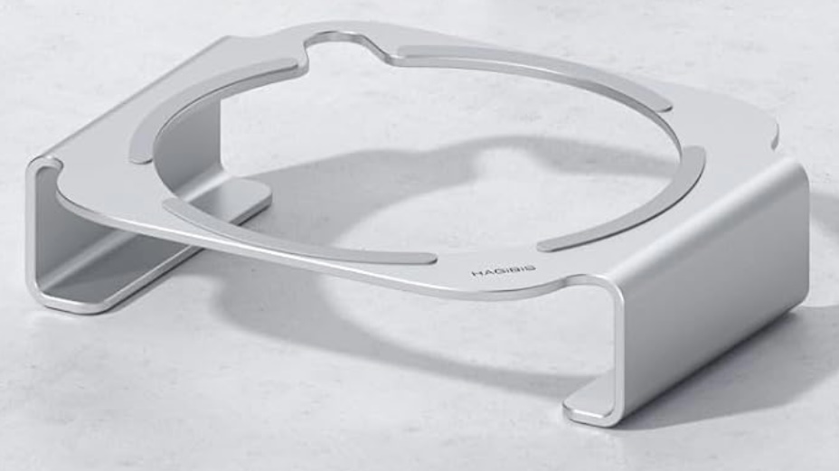

any update on this ? my desk is the same color so it would blend , but air flow worries me
Hi, yes, it is affecting airflow and performance slightly on most demanding long renders.
On the test project using this stand the difference in rendering After Effects Project was mostly ~30s-1min longer sometimes just 10-15s longer.
Without the stand Mini rendered it in ~24min.
The fans were at the same levels at max around ~3150rpm.
It is hard to tell what's the real impact and I should probably wait longer to cool down enclosure completely before another try.
Clearly this tiny computer wasn't mean't for brutal rendering, especially one after another with or without the stand.
Rendering smaller projects didn't take a hit at all. Render times were the same.
So the difference is not big, but the demanding tasks could differ, so the differences also could be bigger.
Ambient temp was ~21C.
While normal usage no weird spinning fans, all good.
Of course no problems with wifi.
EDIT: I run the same test project from cold enclosure and the time was
With dock: 23m45s
Bare Mini: 23m30s
So here it is, the difference in temps are minimal at best.

I have the same stand. Idling/surfing temps without stand 28ºC, with the stand 32ºC. It does affect airflow for very little benefit. I use it now upside down to raise the Mini off the table. Not the most stable setup as you can knock it off its perch quite easily but at least it improves airflow and access to the on/off button that way. If you are not going to thrash the unit with any sustained heavy workloads, then you could use it as intended.
Reactions: EugW
So your Mac Mini runs a few degrees hotter using then stand than sitting on your desk? Perhaps the Mini's body transmits heat into your desk more efficiently than into the air and stand (which it has little surface area contact with)?
I would think part of the hoped for benefit of better air flow would be to cool the Mini.
I also observed warmer idle internal temps.
I think the stand isn’t optimally designed. The flow with hot air is slightly restricted, escaping hot air hits one of the walls of the stand, I think the temps could be lower if the escaping hot air wouldn’t hit any obstacle and moved more freely.
I’m tempted to modify the stand but I don’t have proper tools to work with wood.
Reactions: drrich2
I don't think this particular stand offers better airflow if used as intended. At best it would be neutral. It raises the Mini by the same amount it obscures it, except for the cutaway around the power button. Additionally, there are optional adhesive mesh dust filters for the intake, which I applied. That shouldn't really affect airflow that drastically but it does. Down the line it should avoid all the dustbunnies that might end up in the Mini, so it depends on how dusty your environment is as to whether you should bother with it. Up to now, I kept the Mini raised on a cassette case to improve airflow. I haven't measured temps flat on a table as mine is a little cluttered at the moment.
Reactions: drrich2
