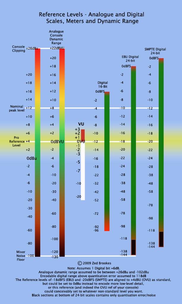

FWIW
<chart>
This assumes that the systems are actually cross-calibrated to Dolby A/85 (0VU @ -20dBFS @ 24 bit). This is not going to be relevant to almost anyone asking about the Mac's audio out jack who doesn't already know about Core Audio, Audio MIDI Setup and routing.
The guy is also doing a small live performance. Asking the questions he's asking, he's probably not bringing calibrated VU meters with him.
