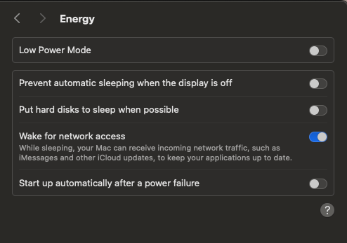

Can anybody with Sequoia confirm that this is the standard behaviour now? My Mini still turns on as soon as power is applied despite the setting saying the opposite.

Same behavior on my M4 mini after 15.7.7 landed — the auto-power-on became firmware-enforced without any UI toggle exposed in Sequoia's Energy pane. It doesn't matter what state you leave the "Start automatically after a power failure" checkbox in; the underlying flag lives at the SEP/firmware level and the OS just can't see it on Sequoia. The workaround that stuck for me: build a bootable Tahoe (26.5 or later) installer stick, boot to it once, toggle the setting off in Tahoe's Energy pane (which does expose it), then boot back to Sequoia. Because the setting is firmware-level, it persists. To make the stick: `softwareupdate --fetch-full-installer --full-installer-version 26.6`, then createinstallmedia to a 16GB+ USB, hold the power button on the mini to get to the boot picker, pick the USB, toggle, reboot. The missing bong is a separate story — the "play sound on startup" checkbox in Sound settings stopped taking effect on M4 minis around the same firmware bump and Apple hasn't documented why.
