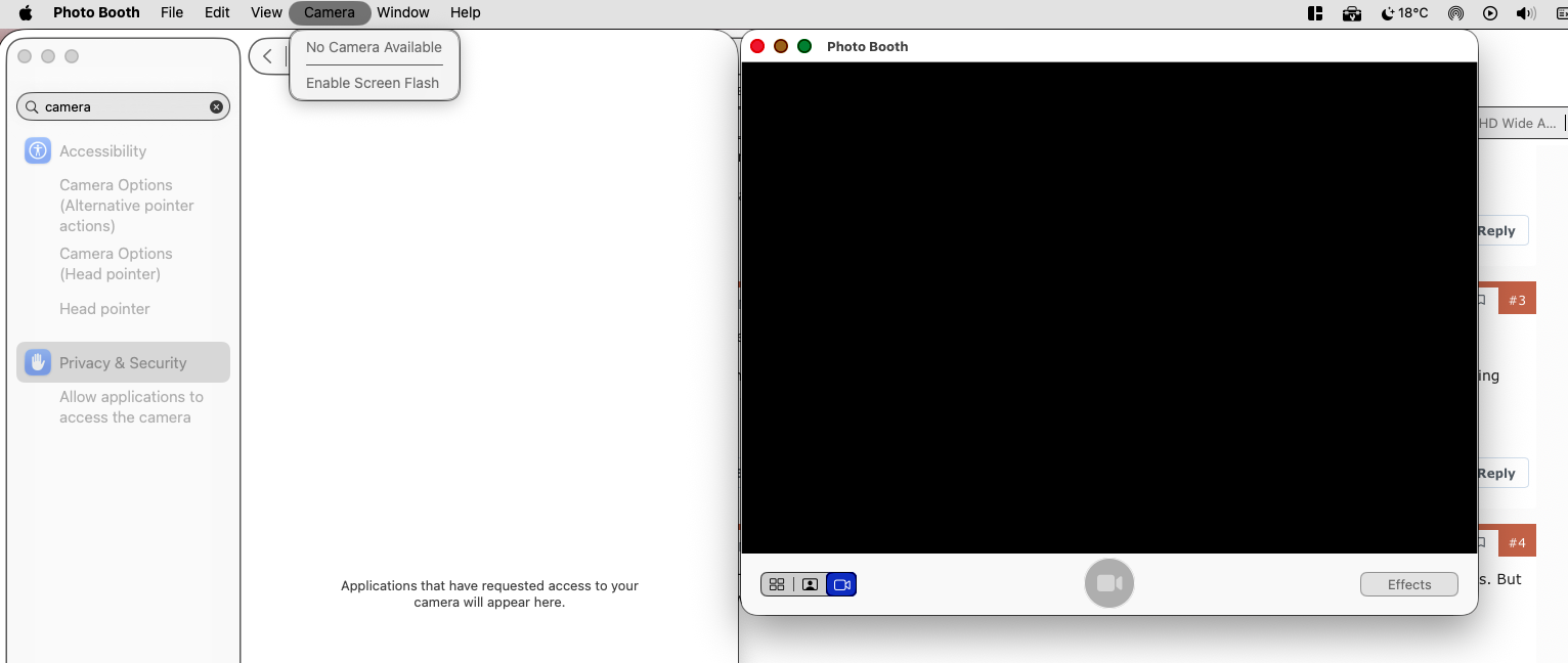

I used Photo Booth app instead of FaceTime (it's a bit late at night here to be using FaceTime) and ran it in split screen with System Settings. There is no request to use a camera.
See the following screenshot
